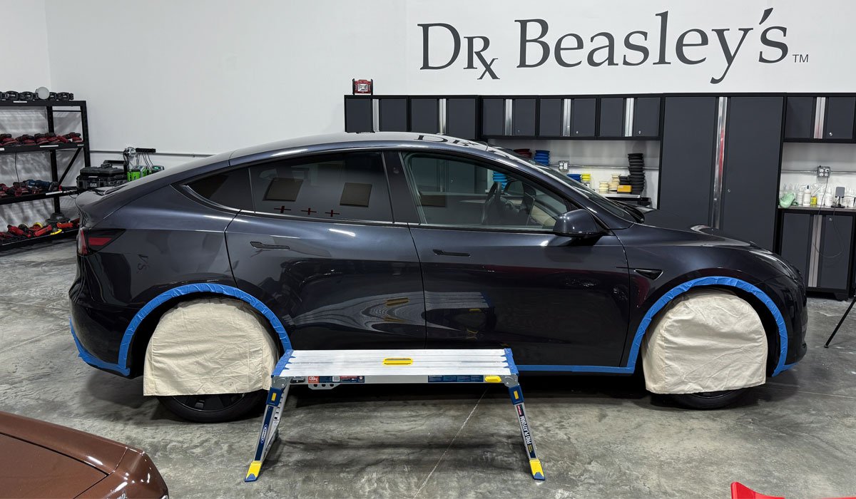

I have a fresh video and step-by-step article coming out for a 2025 Tesla. Although the roof is mostly glass, I found due to the height of the roof, I needed a work platform to comfortably and safely machine polish all the glass to remove water spots and some type of film-contamination on the entire exterior.
