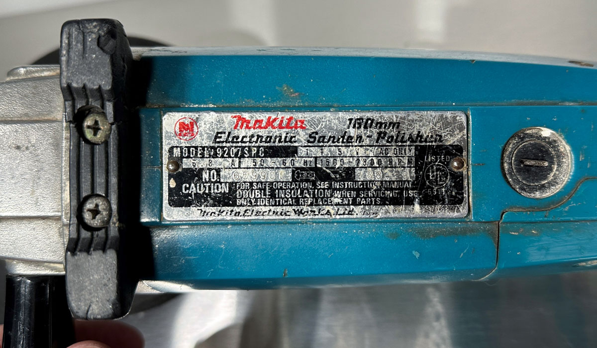

Some people will purchase a short corded tool and install their own heavy duty longer cord. I did this for years, probably decades with my original rotary polisher. I quit installing replacement cords after wearing out the gears to the point they no longer engage enough to rotate the spindle. :_
