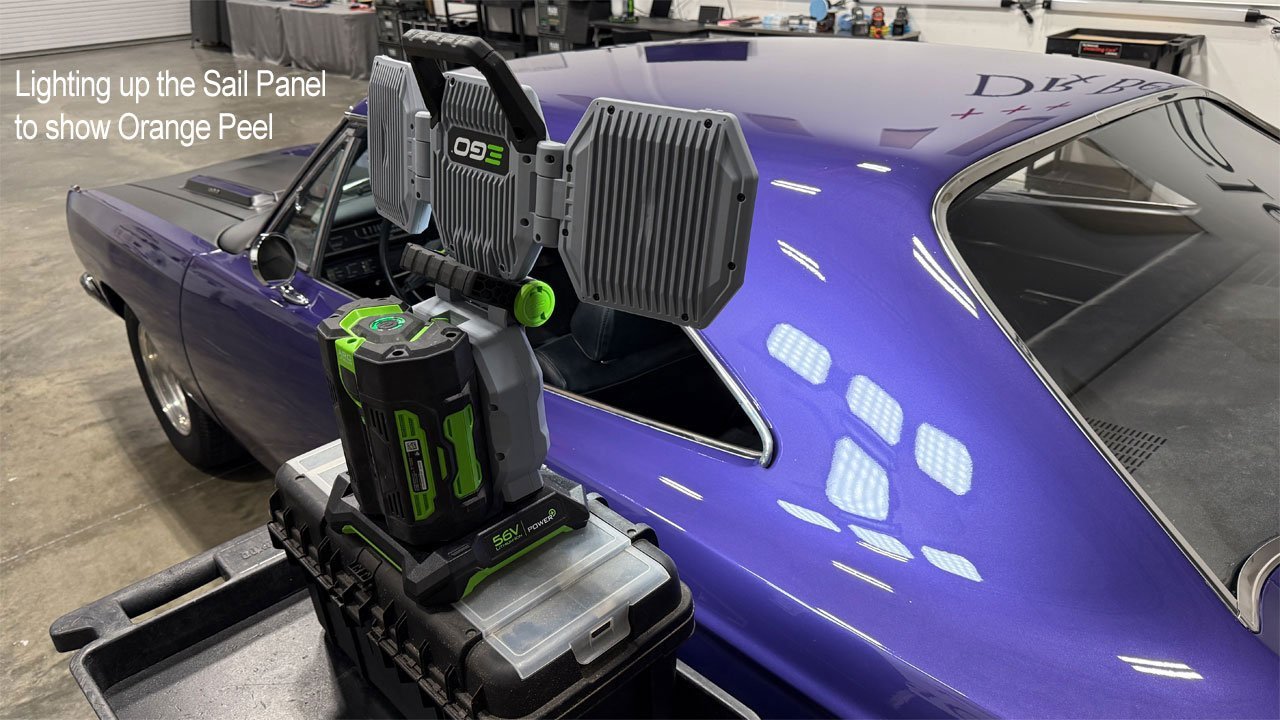

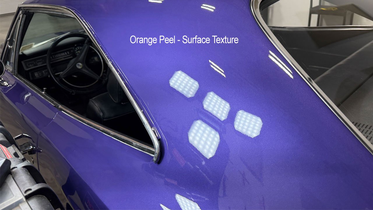

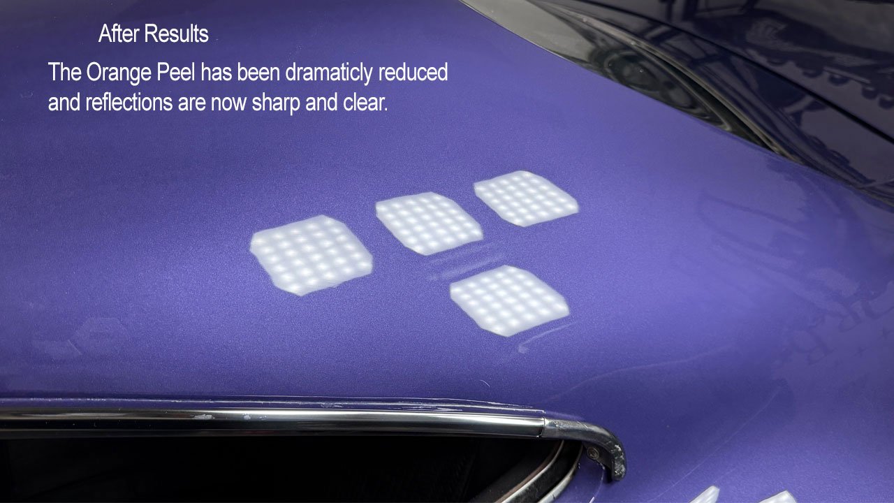

I'm not sure what any other class does BEFORE the class starts, but I like to fully document the current condition of the training cars that go through our classes. As such, here's a few pictures that showcase the current condition and defects in the paint.
***UPDATE***

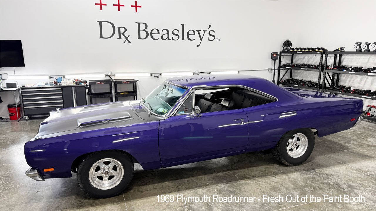

🔥 Training Car #7—the 1969 Plymouth Roadrunner! Before & AFTER!

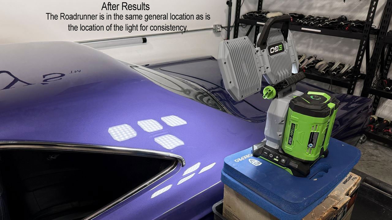

Before I share how the class sanded and buffed this freshly painted muscle car, let’s take a look at what they accomplished!

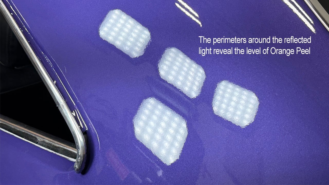

Look at the reflected lights. In the before picture, their edges look wavy and distorted from the orange peel. In the after picture, the orange peel has been dramatically reduced, and those reflections are now sharp and clear! ✨
