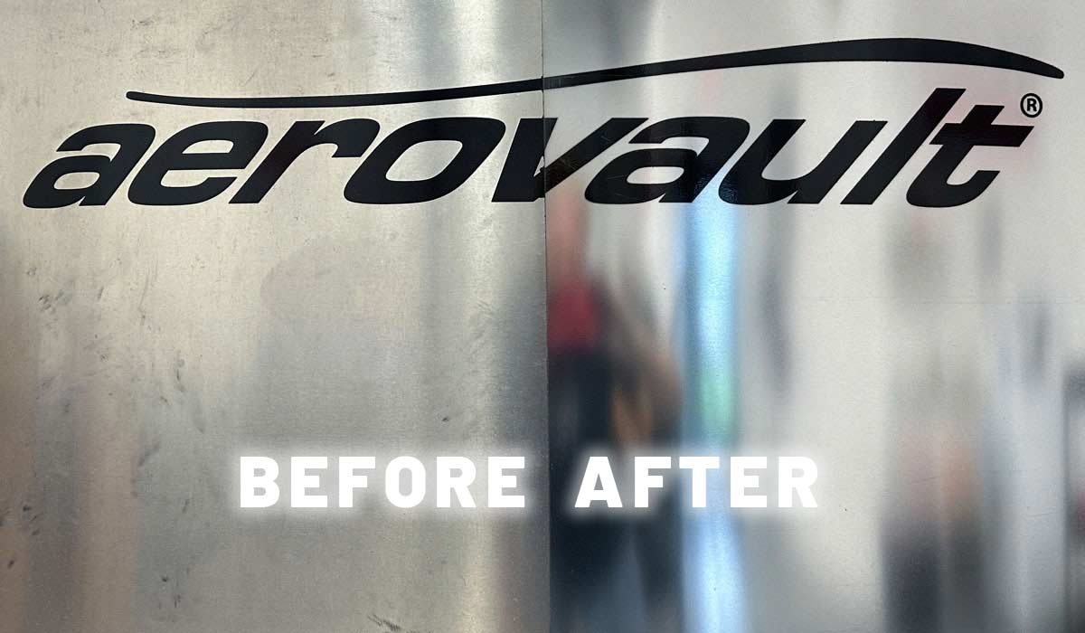

Here's before

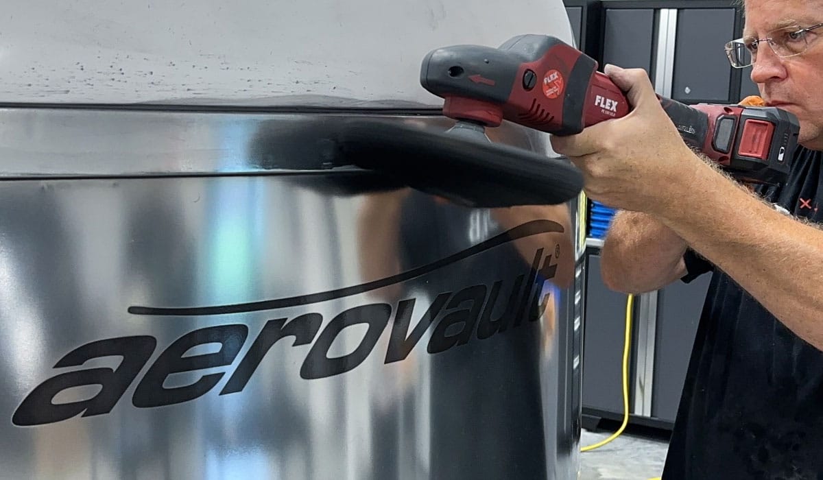

Wow, that was a lot of work! Did you polish right over that Aerovault applique lettering? I'd be afraid of lifting an edge--or is that actually painted on?
Wow, that was a lot of work! Did you polish right over that AeroVault applique lettering? I'd be afraid of lifting an edge--or is that actually painted on?
I don't normally, or like to cuss in the online world, but buffing out the aluminum on this trailer was a shit ton of work. Super dirty too. And I simply through away any of the foam pads I used for this project.
As for the vinyl graphics, I did buff over them after first TESTING to see how durable they would be and they seem to take licking and keep on ticking.

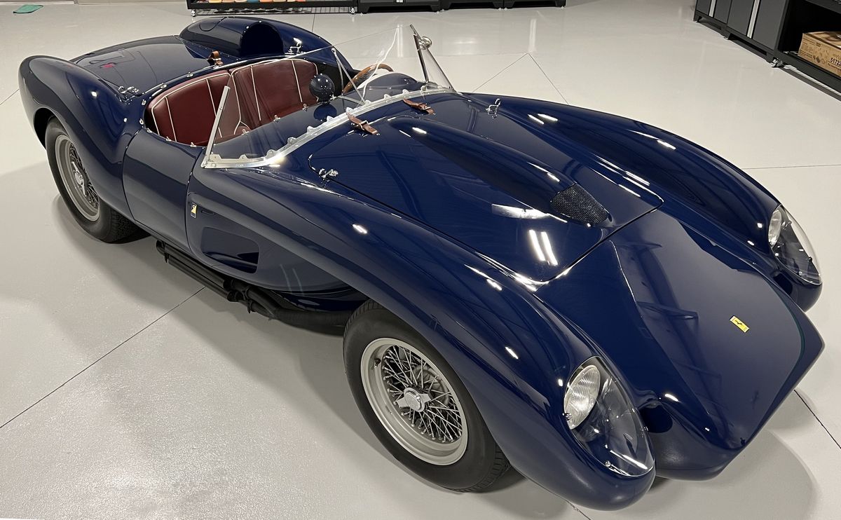

I don't normally like doing this type of work but the owner brings me a LOT of really expensive classic Ferraris to prep for concours events, so I do my best to take care of him.
1957 Ferrari 250 Testa Rossa Detailed by Mike Phillips
