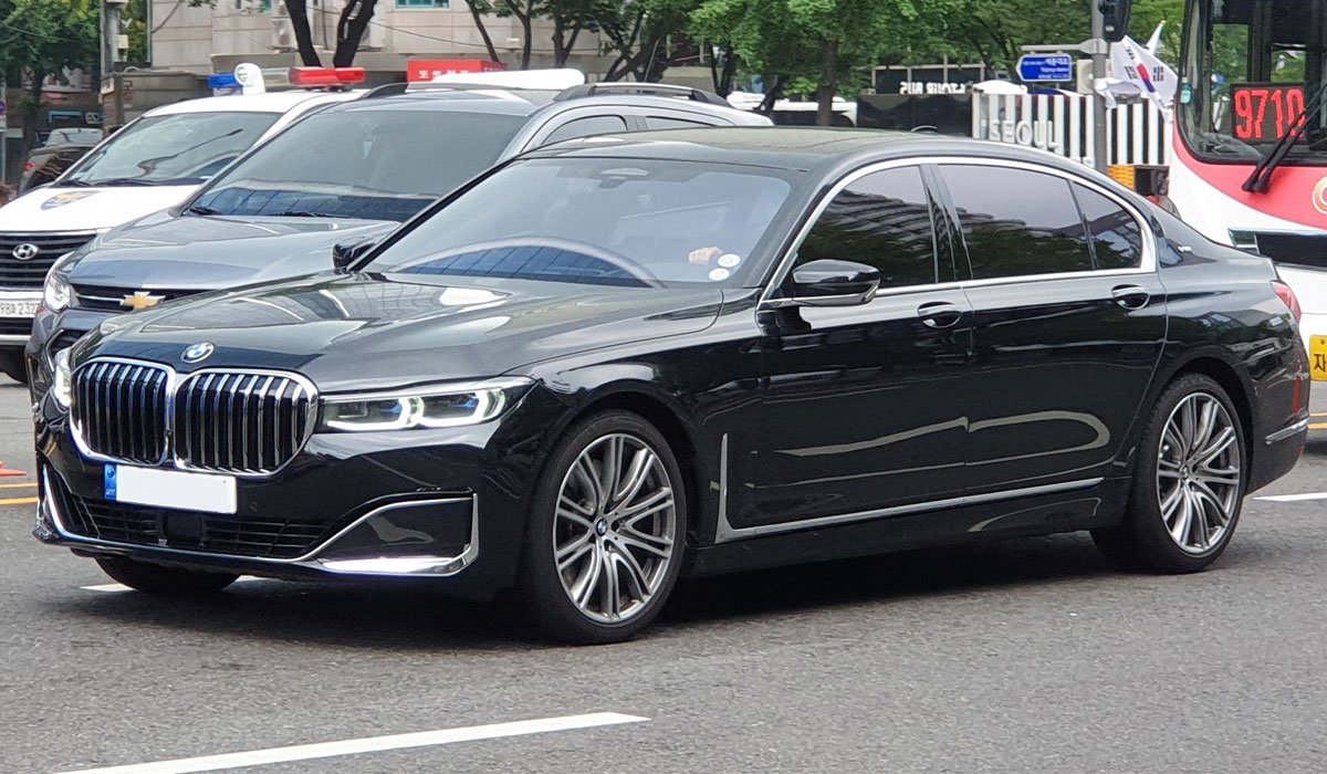

Wow! You've really been through a lot with detailing your own car.
For reference, I found this picture of a 2022 BMW M760i Final V12 in Saphire Metallic Black.
