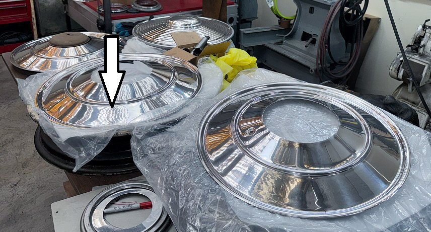

We spin Aluminum and other alloy “Wheel Covers” for show bound 100-point cars—mostly pre-war vehicles—back when the only wheel you could get was a spoke wheel. Our wheel covers are “Era Correct” for many classics such as Delage, Delahaye, Rolls Royce, Hispano Suissa ETC ETC. See attached photos.
Our covers are Lathe Spun from the over 250 phenolic mold dies that we have on hand. ( long story—call if interested)

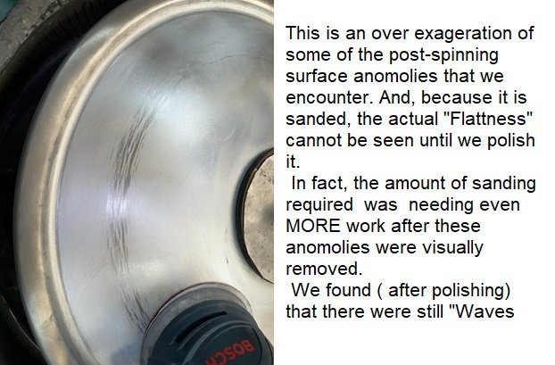

The process of spinning puts tooling marks into the aluminum—EVEN when spun using a Teflon PTFE tool! These “record player lines” are smoothed over by the spinner using about 120 grit paper before delivering to us.
We built a “Potters Wheel” vertical lathe for progressive grit dry and wet-block sanding prior to buffing the aluminum. The low very low RPM table has the same phenolic spin die that was used to spin the cover rotating—allowing us to block sand the various flat surfaces of the wheel cover backed by that die.

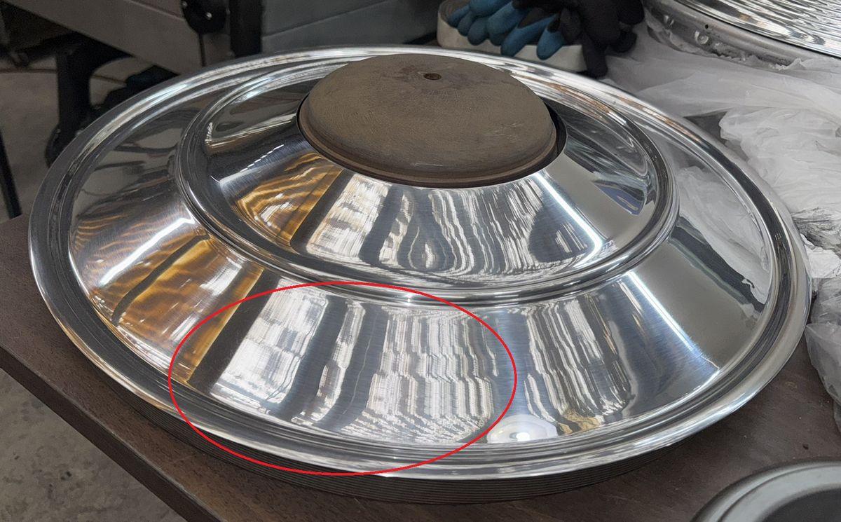

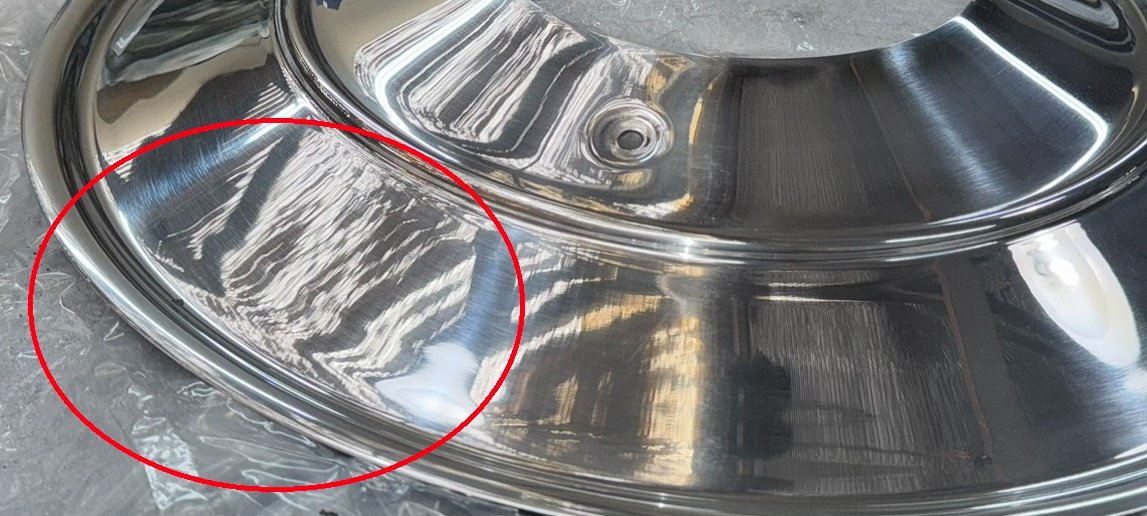

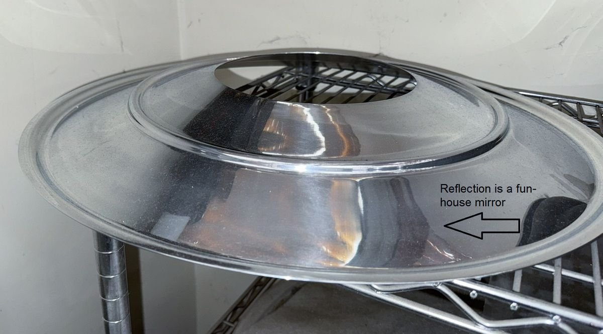

Specifically, the surfaces must be perfectly flat before ANY polishing. The original .060” aluminum is now squeezed , tooled, and sanded to about .050” pure aluminum sheet. The polished aluminum now STILL reveals concentric “waves” from original spinning process. That is, the reflection is a bit of a fun-house mirror.
I was told by a sage and savvy body man once that wet sanding—even with a block—when using anything finer than 220 paper “clings” to the surface and will cut both the mountain tops and the valleys simultaneously- thus not actually flattening—but rather “riding the waves” in the aluminum. Yes, we discovered that to be pretty much true. AND, one would THINK that we have flattened—until buffing proves us wrong! The surfaces we are sanding are only 3” wide. See photos—and very difficult to move by hand a flattening block.
I was thinking that a DA sander having a 2” pad would be ideal to flatten out these waves- with maybe a 320 grit?? No such DA exists, I think. And still- a steep learning curve for technique. Pebble Beach approaches. What is your advice in this torturous work?
