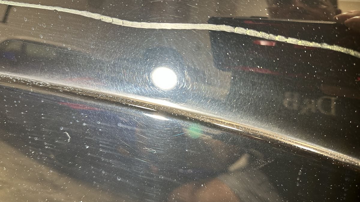

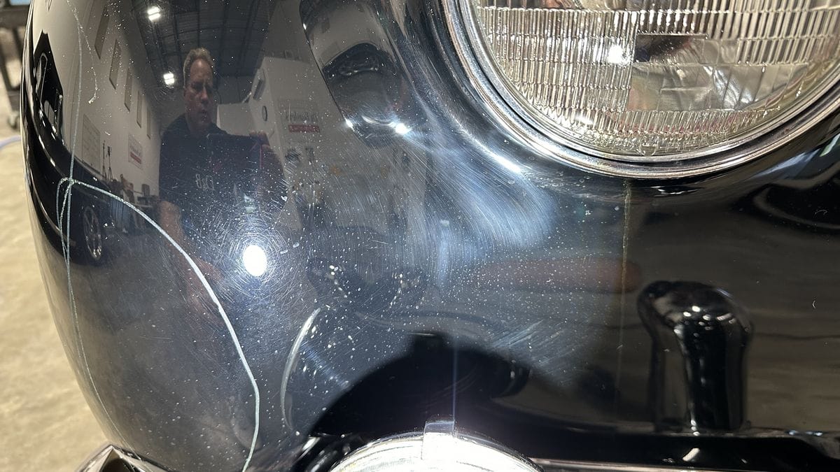

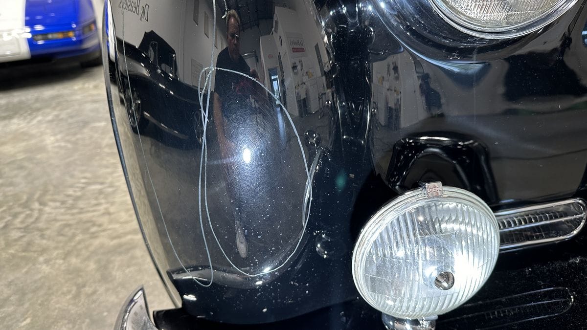

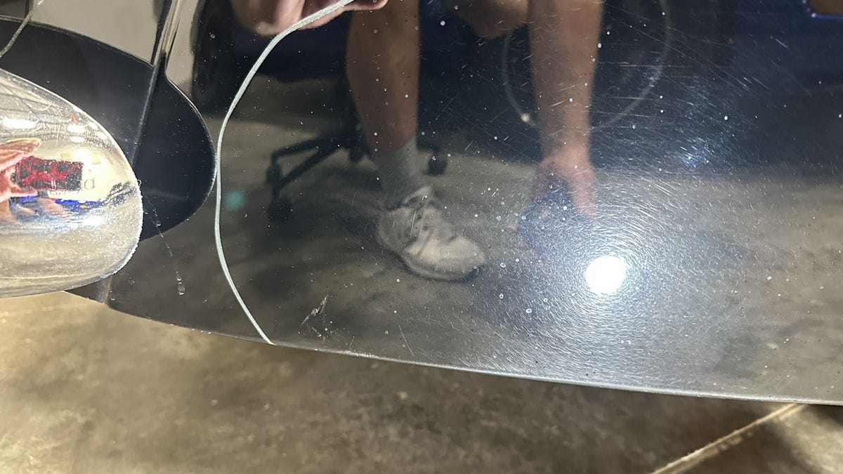

As you can see by the pictures below, there are a lot of swirls, scratches and sanding marks that need to be removed in order to restore a true showcar finish.
To get the paint on this Rolls-Royce right, I'm going to start with Dr. Beasley's NSP 150 with a wool pad on a rotary polisher. The defects in the paint are too many and too deep to attempt to remove with an orbital polisher in a time-efficient manner.

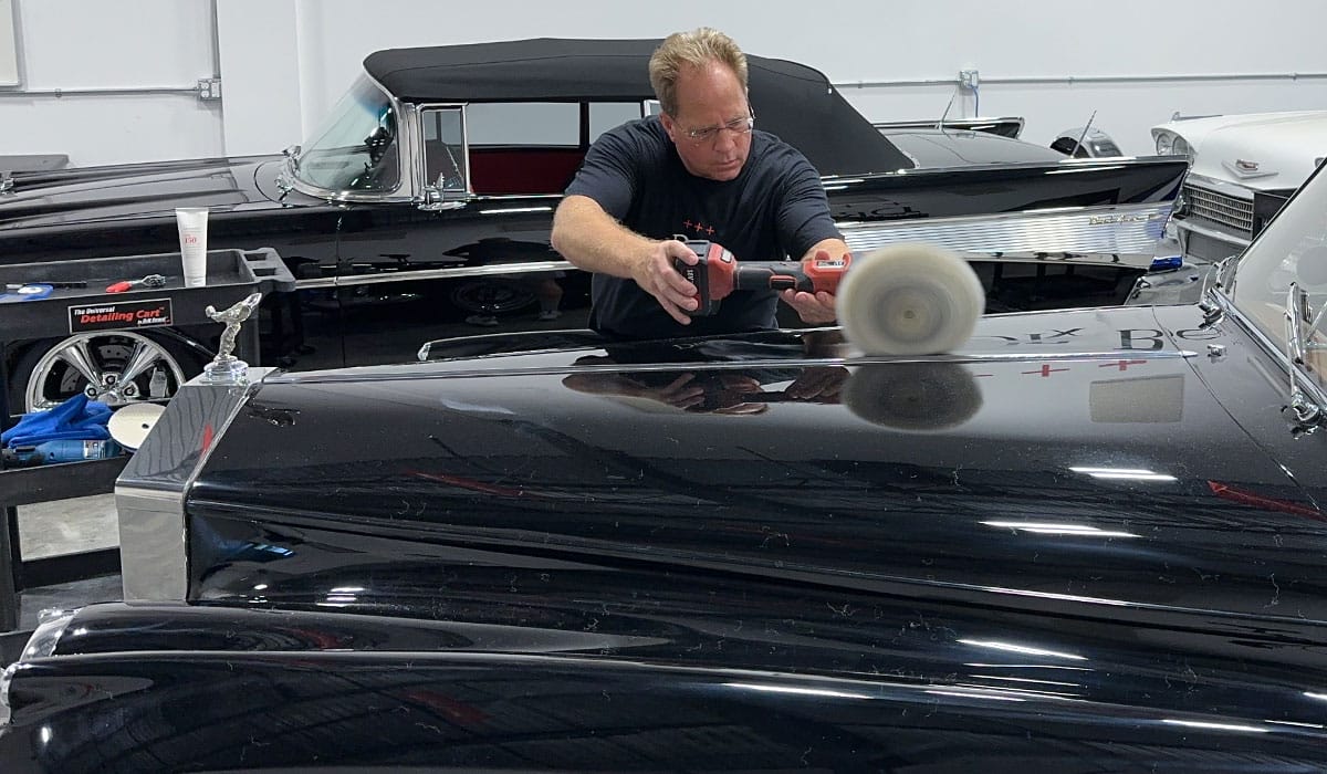

In the below picture, I'm using only the edge of the buffing pad to polish the panel between the windshield and the hood. The major benefit to using a gear-driven orbital polisher is there is zero pad stalling. If I were using a free spinning random orbital polisher, I would not be able to maintain pad rotation when using just the outer portion of the buffing pad. Being able to adjust how I hold this tool to tackle all of the body panels, no matter what the shape or size, is a real time-saver. With free spinning random orbital polishers, I would have to use multiple tools that range in size and thus range in pad size, to perform all the paint correction on this car.
I was both surprised and impressed with how smooth this tool felt even when buffing on the highest speed setting.
Here's another example where I take advantage of the gear-driven aspect of this polisher. You can see how I'm tipping the polisher to do focused, intense polishing work on the paint next to the chrome grill. You cannot do this easily or efficiently with free spinning random orbital polishers as the pads on free spinning random orbital polishers will tend to simply stall or stop rotating and oscillating. Being able to use a single tool and tackle any body panel saves a lot of time since I don't have to stop buffing with one tool, grab a different tool and start up again.

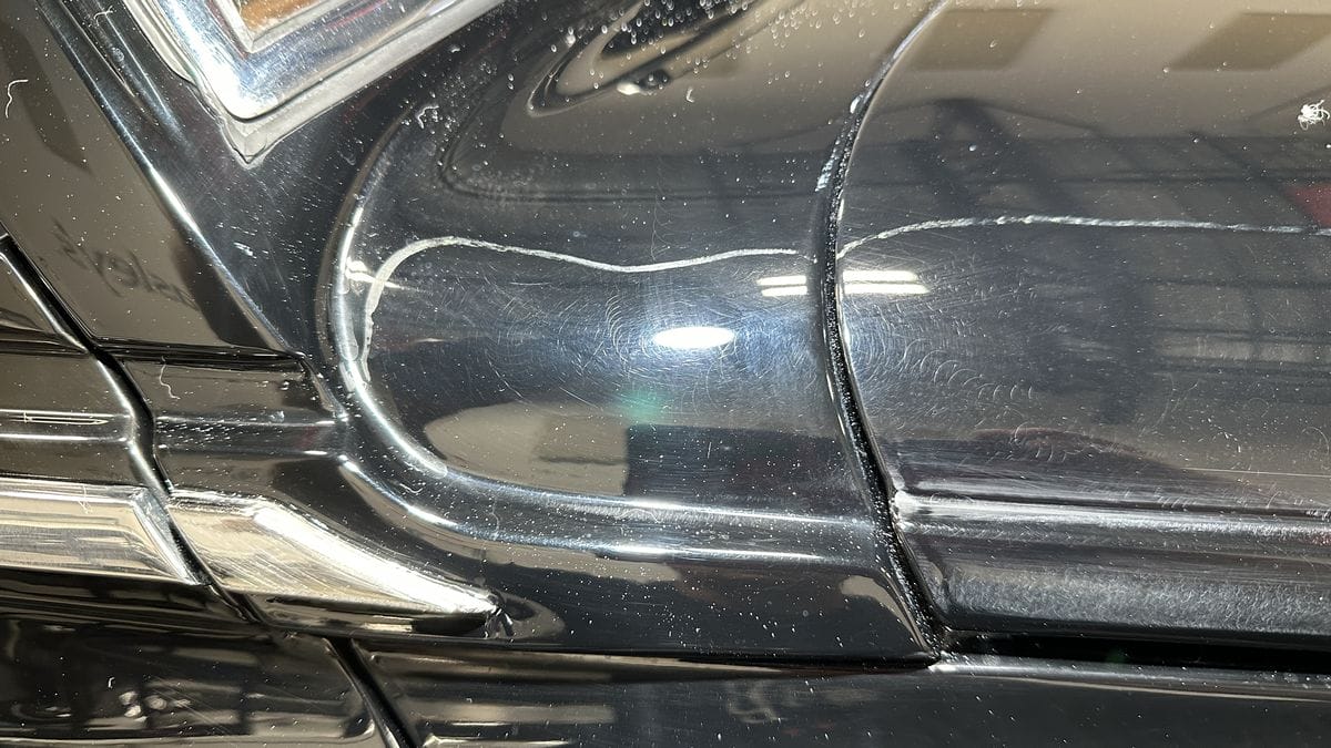

The paint on this car was on the medium side, meaning it wasn't hard and it wasn't soft, it was right in that sweet spot detailers love to work on. Because this was a true showcar detailing process, after the gear-driven polishing step, I switched over to one of my favorite free spinning random orbital polishers, the RUPES BigFoot 21, to perfect the paint with Dr. Beasley's NSP 45 and prepare the paint for the installation of the Dr. Beasley's Nano-Resin MX Ceramic Coating.

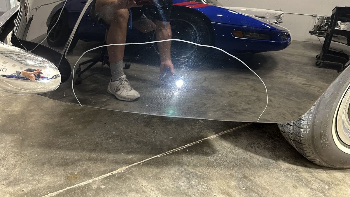

After around 9 hours of rotary cutting and 10 hours of orbital polishing with the Harbor Freight Forced Rotation Dual Action Orbital Polisher, the work is completed.
If you look closely, you can see me using the same swirl finder light for these after shots that I used to show the swirls in the before pictures. The paint is now swirl-free and has a black mirror finish.

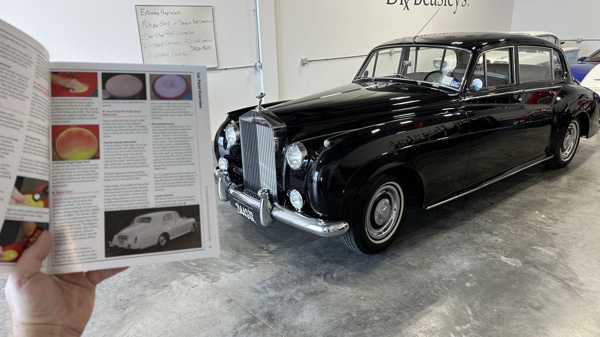

1959 Rolls-Royce Silver Cloud - Test Drive Car
Now that I've lubricated the felt ring, it's time to take the HF Forced Rotation Orbital Polisher for a test drive. To punish and torture this tool, I'm going to use it for the polishing step on this 1959 Rolls-Royce Silver Cloud. This is a HUGE car with plenty of real-estate in the way of body panels. Using a large car like this will provide me with plenty of hands-on time behind this tool so I can share my real-world experience in this review.
This should be fun, a $100.00 tool to detail a $100,000.00 car!

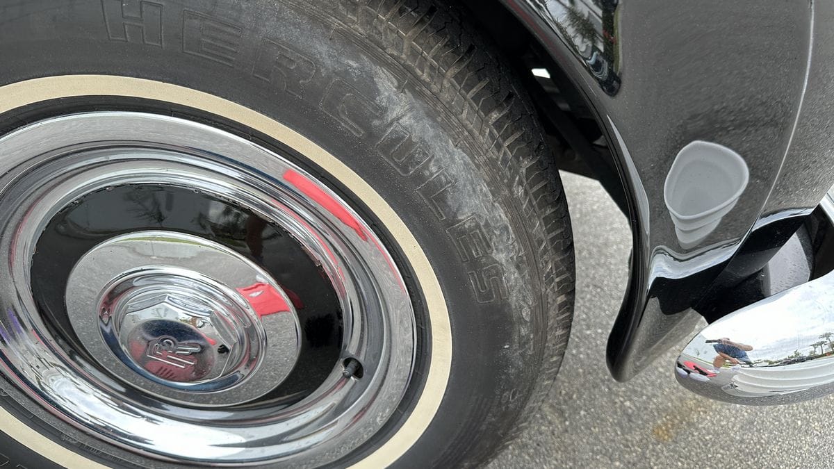

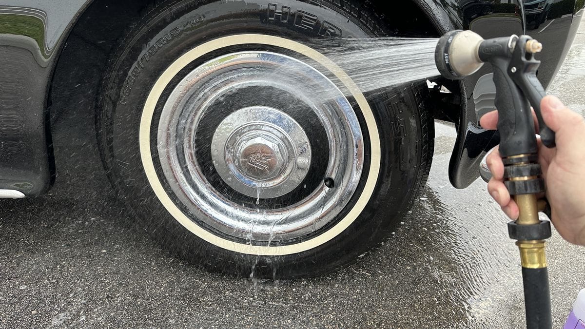

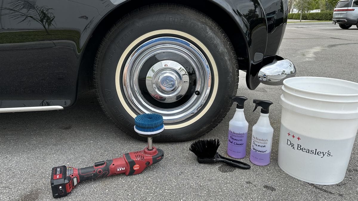

Wheels and tires first

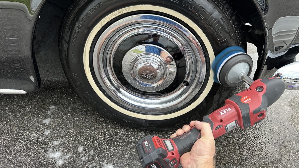

In our detailing classes that include an Extreme Prep wash as a part of the class, we teach our class when washing a car to start with the wheels and tires first to avoid any standing rinse water on the painted body panels where you risk water spots while cleaning the wheels and tires.
For our Extreme Prep Wash portion of our classes, we teach how to machine clean tires and it gets the tires so much cleaner than working by hand with a tire brush.

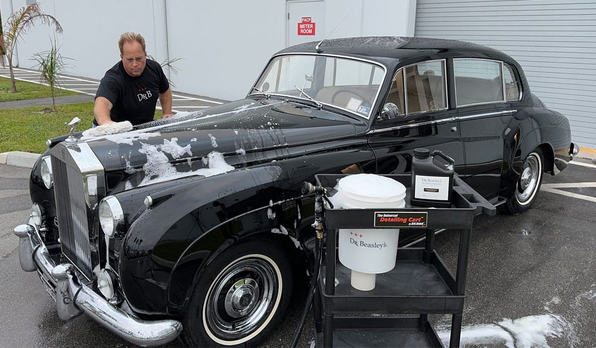

After cleaning all 4 wheel and tires, I give the Rolls-Royce a thorough washing using Dr. Beasley's Premium Body Wash with a Dr. Beasley's Wash Mitt.

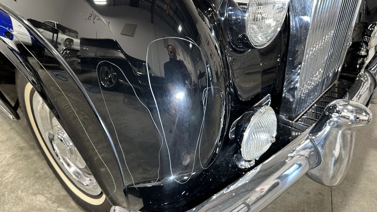

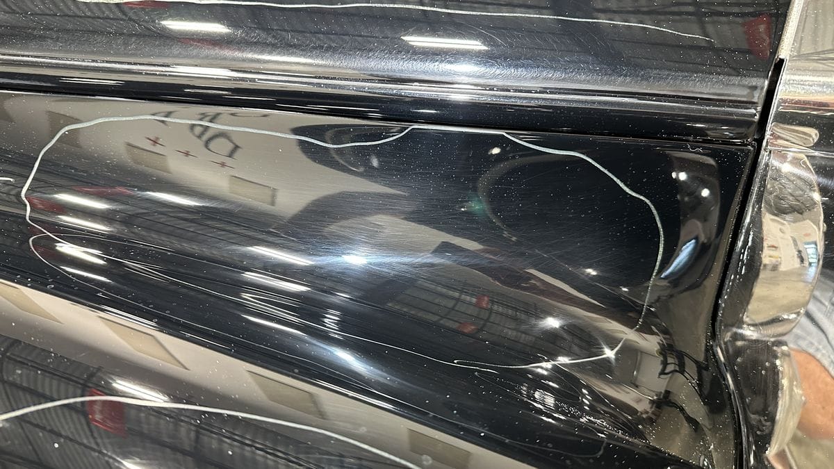

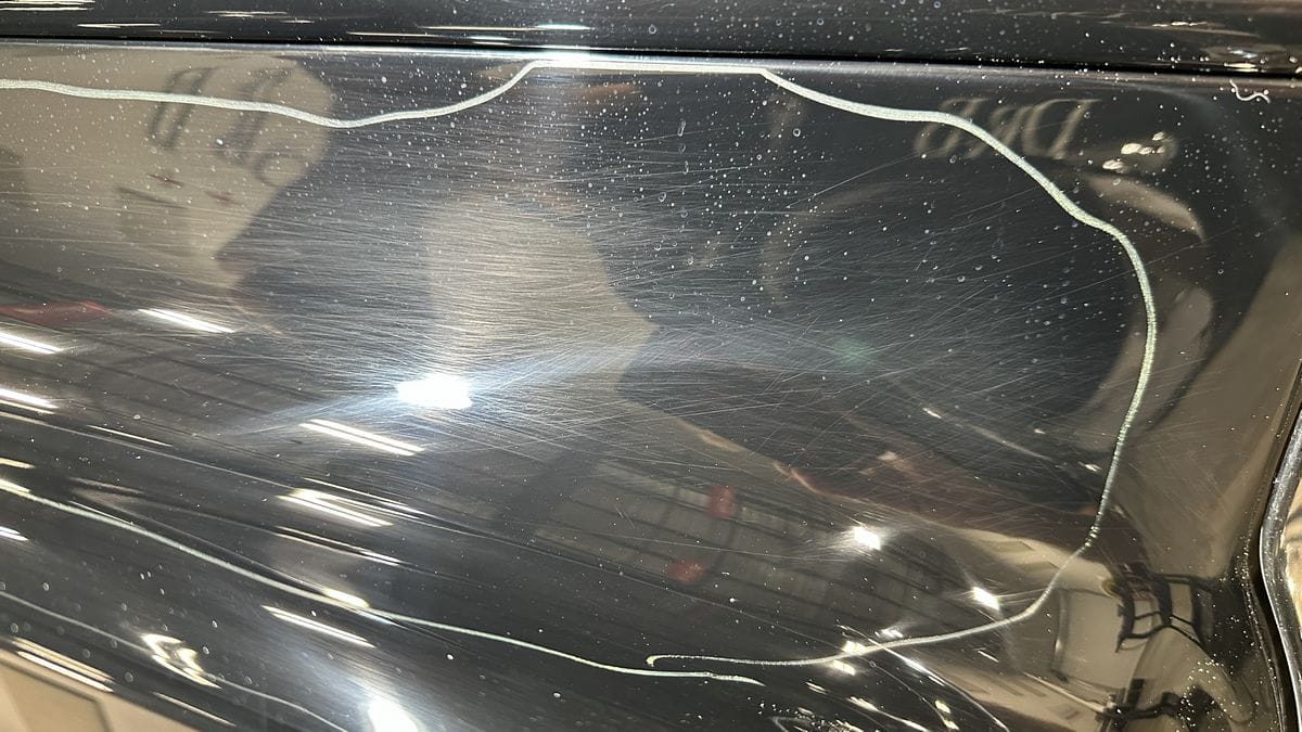

Paint inspection

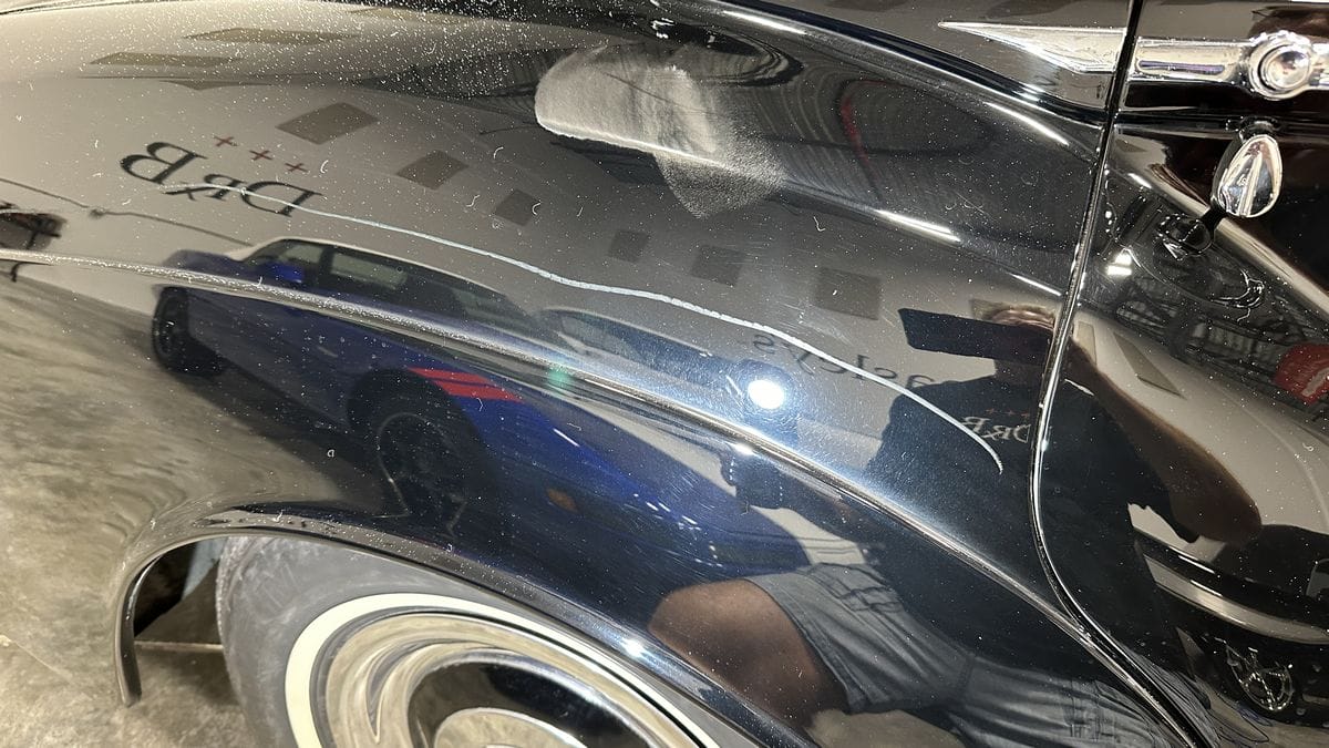

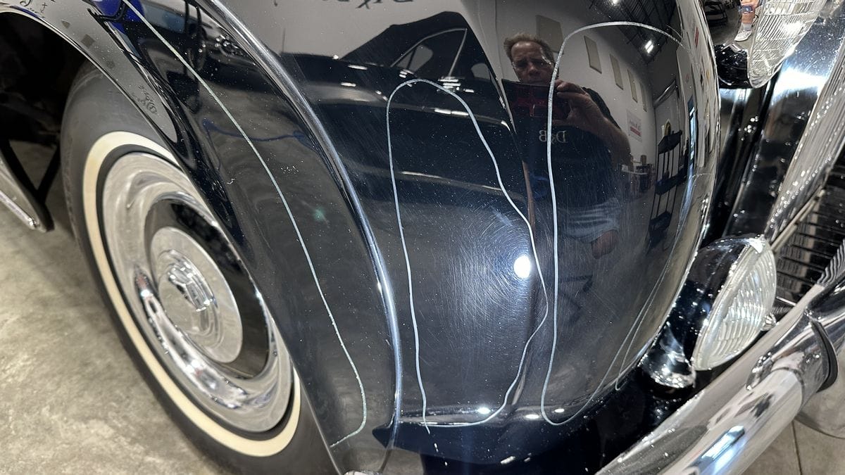

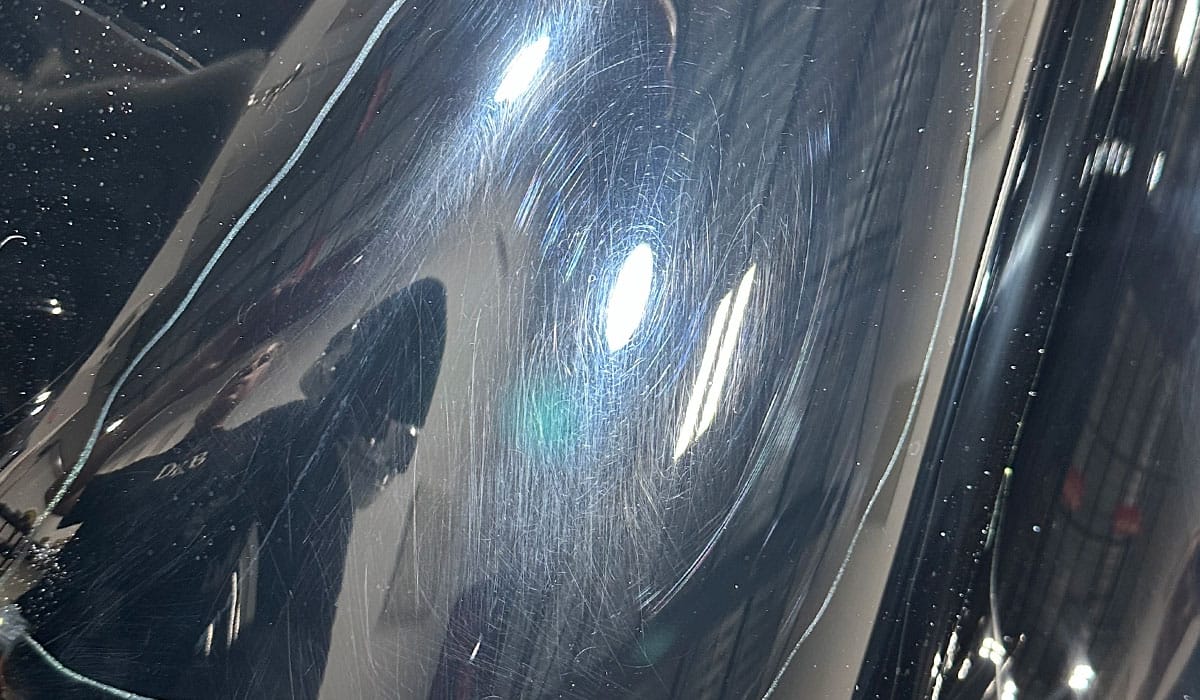

Now that the car is clean and moved into the Dr. Beasley's O.R. (operating room), using overhead lights and a hand-held inspection light, I mark all of the worst defects I'll need to remove. I call this the Crayon Hack as I use a Jumbo Crayon to mark all the areas with deep or serious paint defects that I'll need to remover.

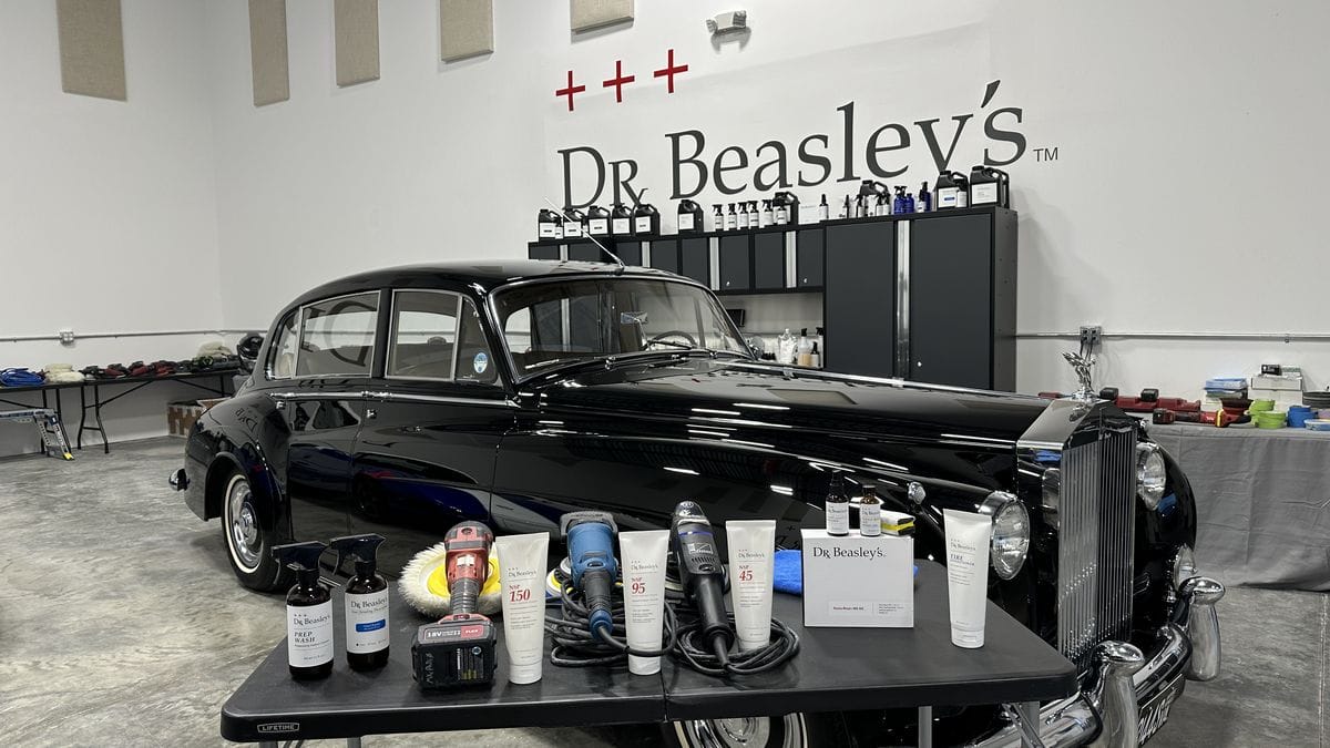

Smooth and low to no vibration
Been there, done that...
A few years back I detailed this same model Rolls Royce, only it was painted white. The quirky thing about the white Rolls-Royce Silver Cloud was that for some reason, the trunk lid was painted with single stage paint while all the other body panels were painted using a modern basecoat/clearcoat paint system. I noticed the difference when after buffing on the trunk lid I saw white pigmented paint coming off the trunk lid and building-up on the face of my buffing pad.
If look closely at the picture below, you can see a slight color difference between the single stage paint on the trunk lid and the basecoat/clearcoat paint on the rest of the car.
