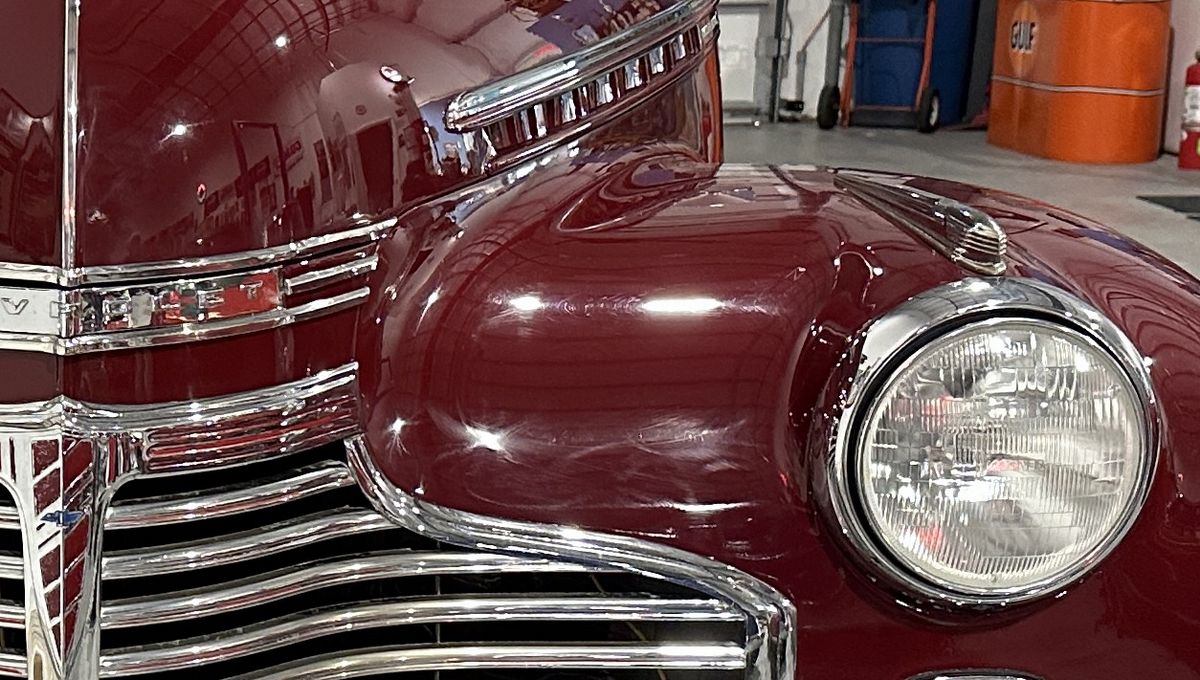

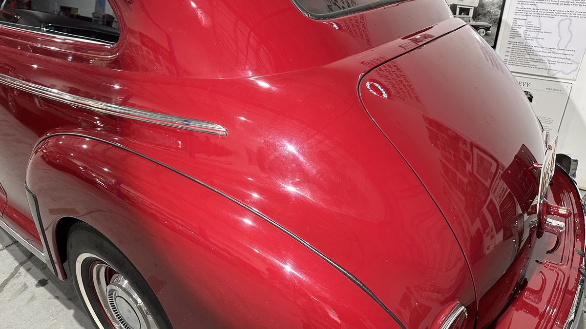

1941 Chevy 2-Door Sedan Streetrod
Totally swirled out! An awesome training car due to all the curves. This car has a modern basecoat/clearcoat paint job. We will start first thing Friday morning with this car and the first tool you will be training with will be the - ROTARY POLISHER.
