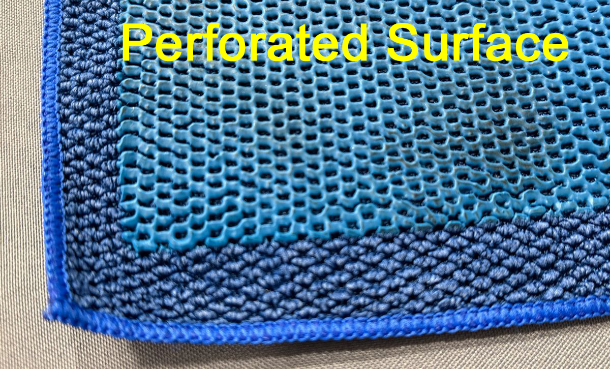

A past student of our classes sent me an email asking me which clay towels we used for the September class? We used 2 styles and various grades. I wanted to share the difference in the STYLES so here's a few pictures to show the differences.
We use both Nanoskin and Rag Company clay towels. The difference is, the Nanoskin clay towels have a SOLID rubberized surface while the Rag Company Ultra Clay Towels have a PERFORATED rubberized surface.
What is the practical difference?
With the flat surface design, any contaminants loosened or abraded off the surface are always trapped between the flat rubberized surface and in my mind, this could lead to extra marring of the surface.
With the perforated design, any contaminants loosened or abraded off the surface have place to migrate INTO and thus will not be trapped between the rubberized surface and the paint and in my mind, this can help prevent scouring of the loosened/abraded contaminants from causing unnecessary marring.
Both have benefits, my inclination is the perforated design is safer, but the solid surface design is faster. But the speed difference could be negligible in the big pictures.
- The Nanoskin design offers more actual SURFACE for removing bonded contaminants.
- The Rag Company Ultra offers less total surface, but the perforated holes provide escape voids for any contaminants loosened or abraded off the paint to migrate into.
