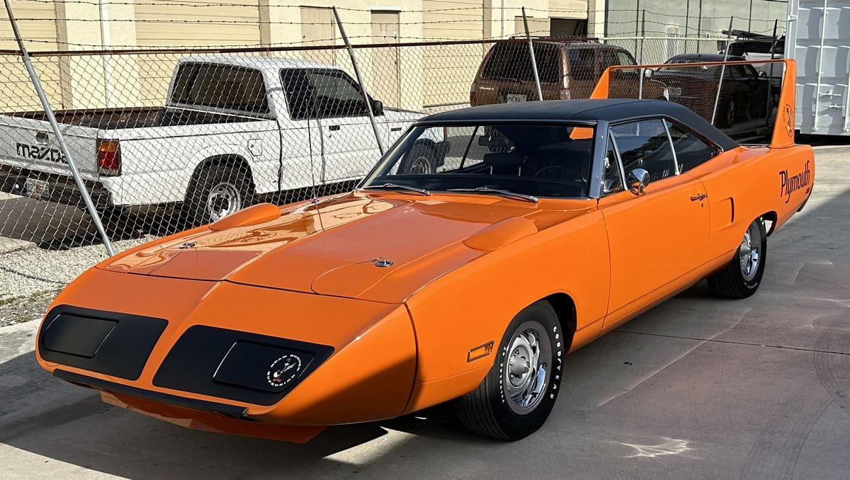

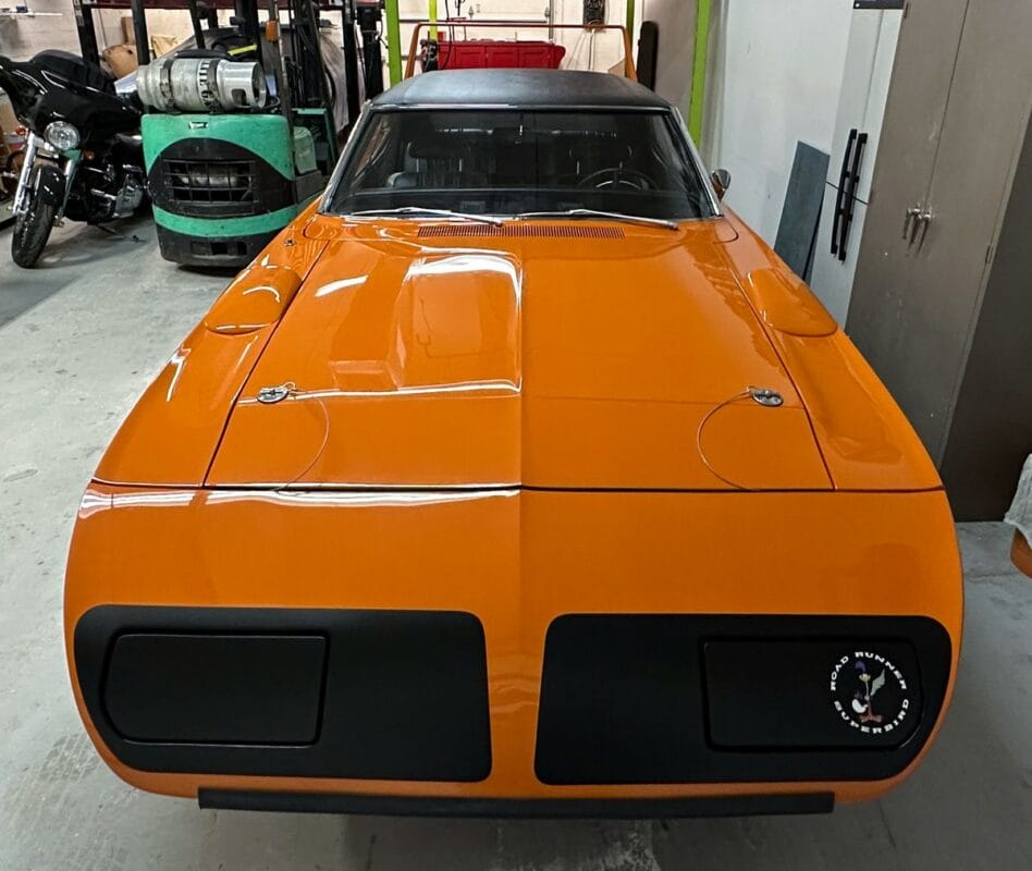

Final results!
Here’s a few pictures of the final results inside the shop where I did the work.
Going home…
I did the detailing work on Friday and the following Monday, the car was going to be loaded into an enclosed trailer and delivered to the owner. Knowing this, I stopped by first thing in the morning, hoping to get some pictures of the car in outdoor lighting and also get the highly coveted sun shots – showing the paint is in fact swirl-free.In case you didn’t notice – these are HUGE cars!
That’s overhead sunlight beaming down on the driver’s side of the hood and there are ZERO swirls.
You can see the car hauler in the background of the below picture. I had to move fast as this is a busy shop and it’s GO TIME!
Getting the sun shots on the deck lid was tricky with the wing in the way, but I call this, a great problem to have.
One more picture because this car is so freaking cool and a real piece of American car culture history.
