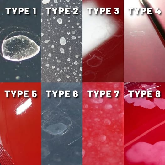

The last time I saw water spot etchings this bad is when I buffed out a Corvette in Irvine, California while working at Meguiar's.
I'm thinking these are Type 4 and that picture in Type 4 is the picture I took of the Corvette. Somewhere I have the original.
Let me get back to you.
