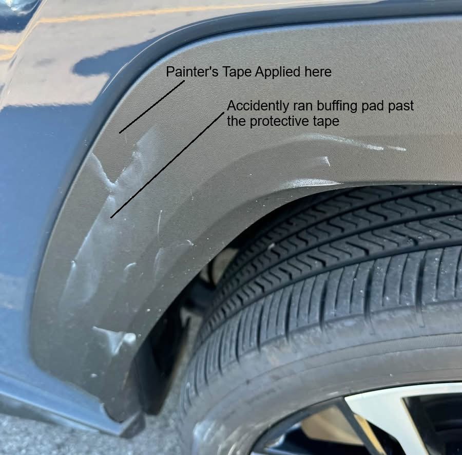

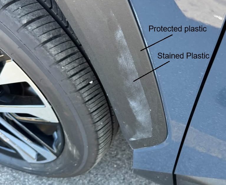

And again, right now your trim does not NEED this product and process. In my opinion, it's better to be pro-active and protect the appearance with a dye made for this type of trim then to wait until the plastic has faded and developed Zebra Stripes and then try to fix or cover it up.

As for applying some type of protective sealant onto the paint, simply spray the product on a microfiber towel folded 4-ways and then use the towel to apply the product. Have a second towel handy to remove any excess. This is called the 2-Towel Method. By spraying the product onto a towel instead of spraying the product onto the body panel - you avoid overspray on nearby surfaces - like Textured Black Plastic Trim.
