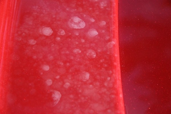

Hi Opie,
I've documented this type of water spots in past car detailing how-to books, (see page 34 in both books)
Here's the picture, (same picture in both books) the same pictures you'll see in an article I wrote years ago and am re-writing a fresh version for a new article on the topic of water spots.
Here's the whitish looking stain left by water that pooled on old single stage red paint.
If exposing the paint to hot temperatures via parking the car in bright, overhead sunlight, or using a hair dryer or a heat gun does not work, the only other option is to do some form of paint correction.
And of course, always use the least aggressive process to get the job done.
