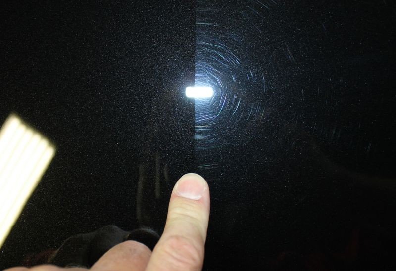

The tape line is great if a person needs to create a dramatic before and after, it just comes with risks. If you're trying to get that perfect picture of swirls - before and after - then you need to either buff on the tape line or damn close. And the result can be a line that cannot be removed.
I polished the paint in the picture below, it was on a fancy Mercedes-Benz AMG Bi-Turbo something-or-rather. And left a faint tape-line I was unable to remove, even after light machine damp sanding using 3M Trizact.
Here's the video that included the Mercedes-Benz that we used for the video and then at some point, I took the picture.
