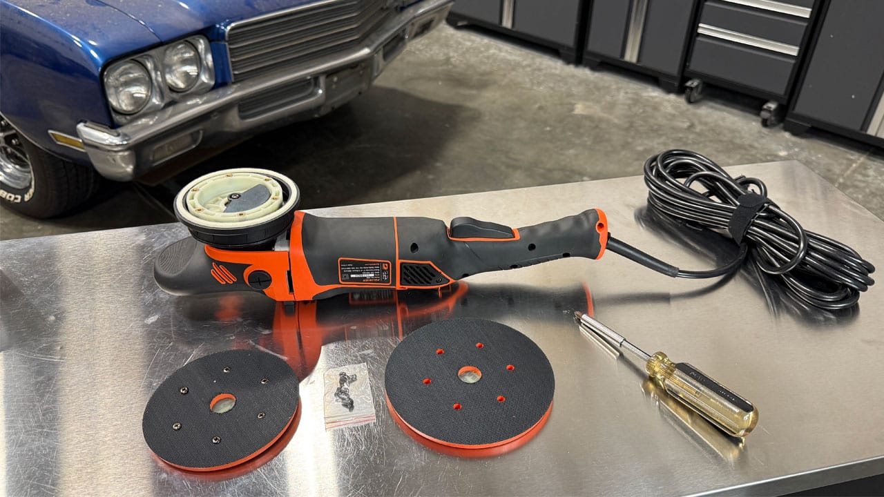

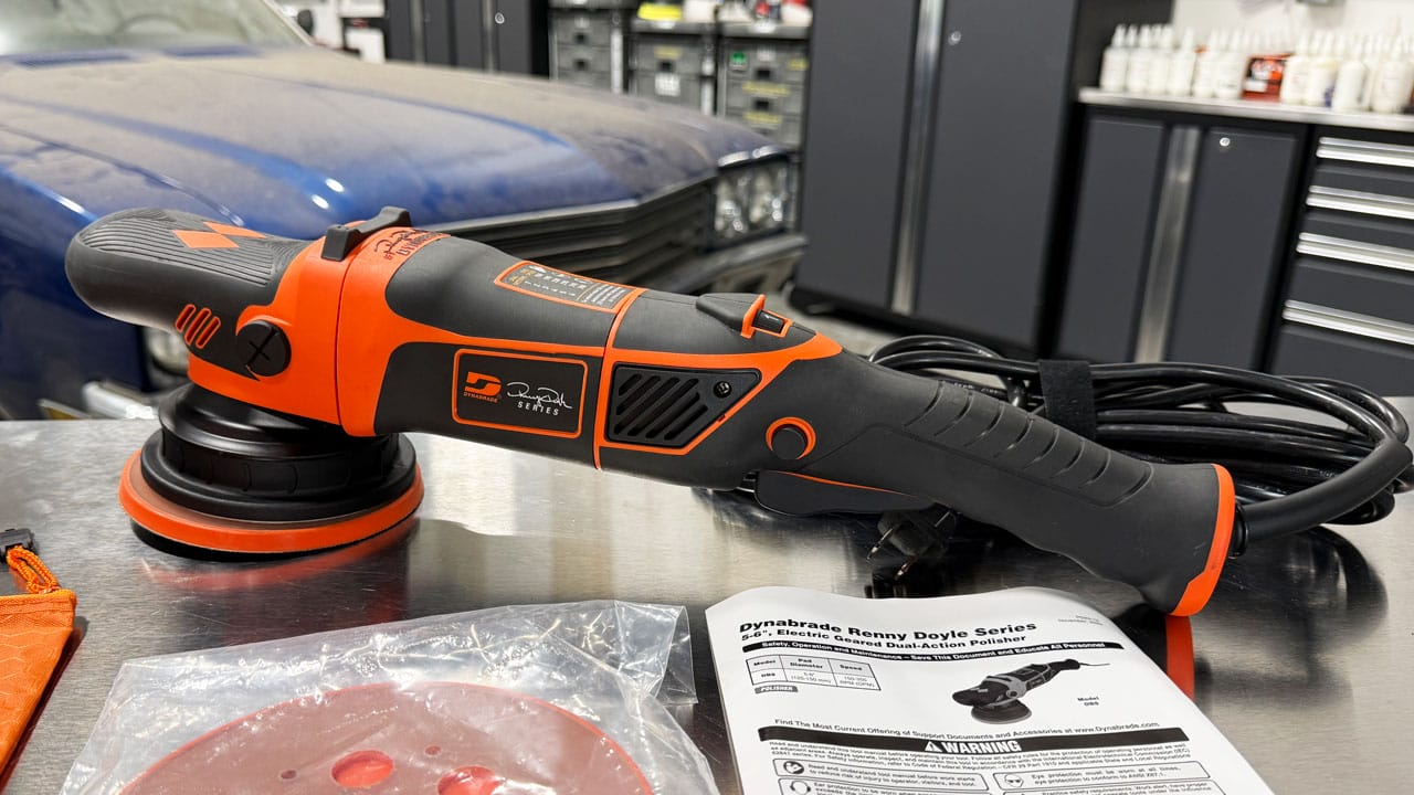

In the video below, we'll take a look at what's in the box, go over all the unique features and then I'll share my thoughts after torture testing this polisher on a barn find 1971 Buick Skylark Custom Convertible.
What's in the Box?​

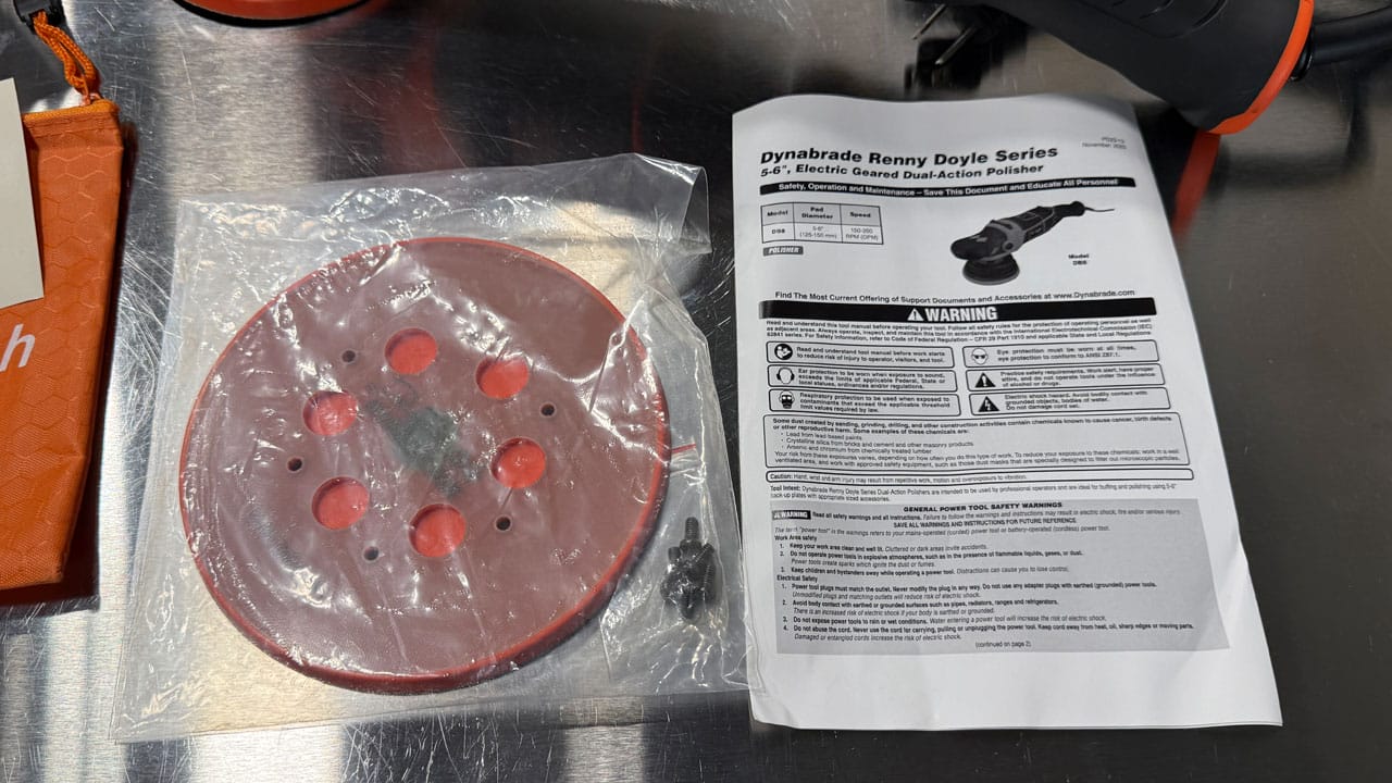

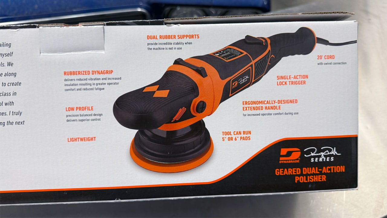

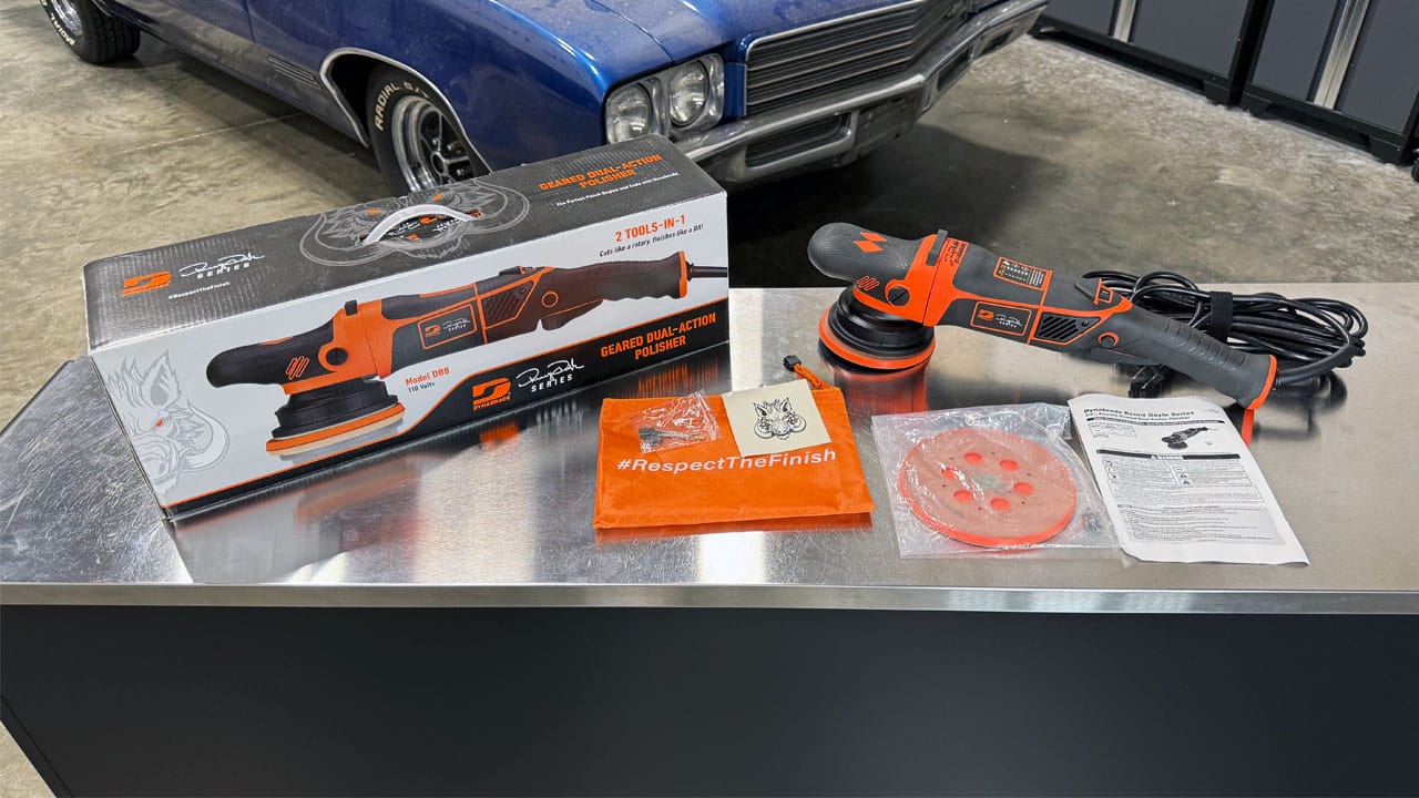

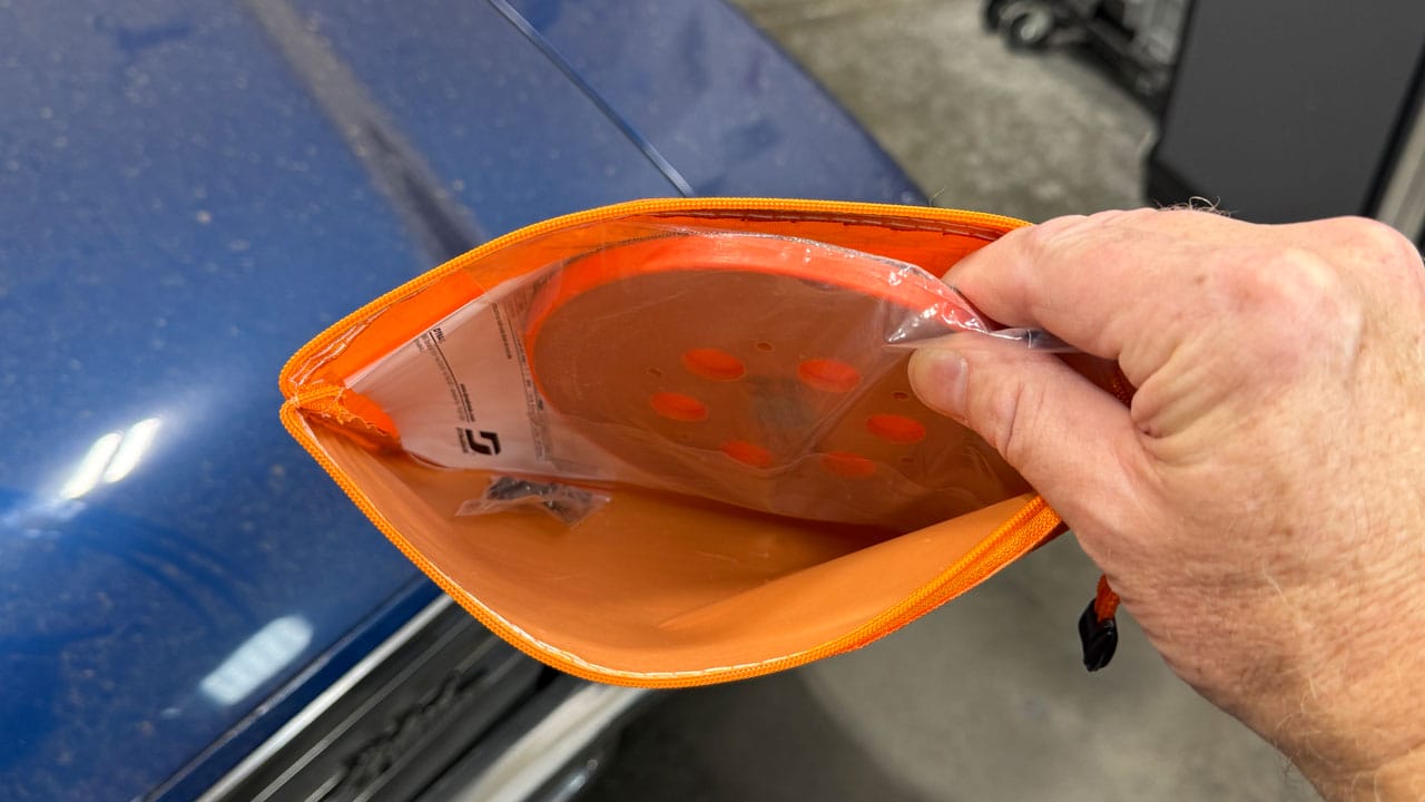

Inside the box you get the DB8 gear-driven polisher, which comes from the factory with a 5" backing plate already attached.
Also inside the box is a zippered pouch with a set of replacement motor brushes, a sticker and the warranty.
There's also an included, optional 6" backing plate with an extra set of replacement machine screws to attach the backing plate to the polisher.
NOTE: The replacement machine screws are the same as the installed machine screws. There are no differences and you can use any of these to attach either the 5" or the 6" backing plate. I think it was a good, proactive measure taken by Dynabrade so that if you drop and lose a machine screw, you have backups. If you strip-out the head of the machine screw, you again have factory replacements and this is important as the machine screws take the brunt of the force transferred from the electric motor to the backing plate.

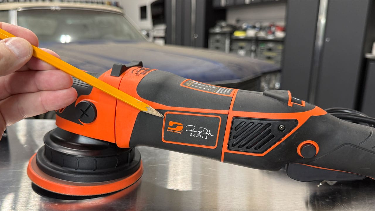

Unique Tool Features​
Before I torture test this polisher and get it dirty, while it's still clean and purty, let's take a look at all the features.

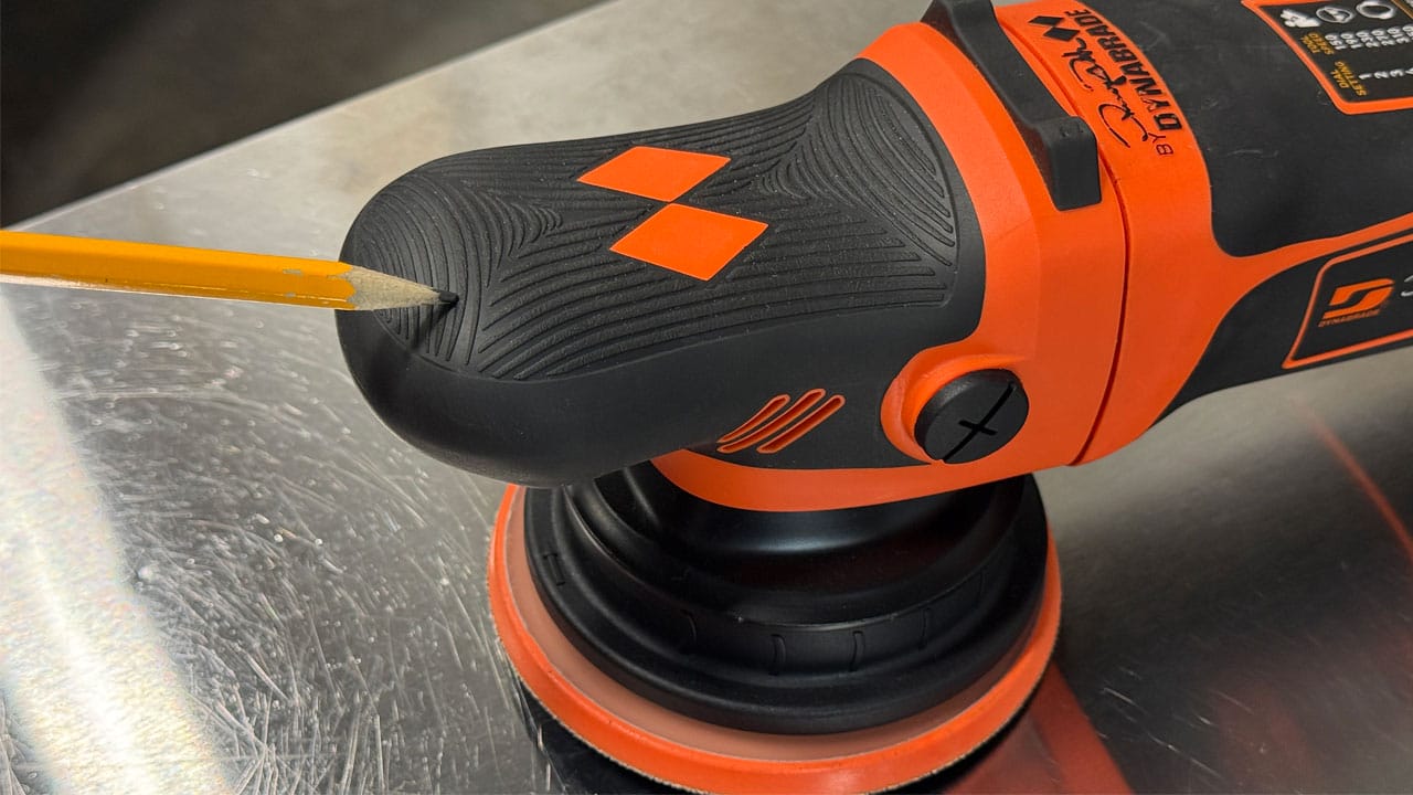

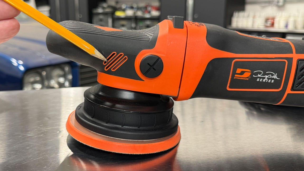

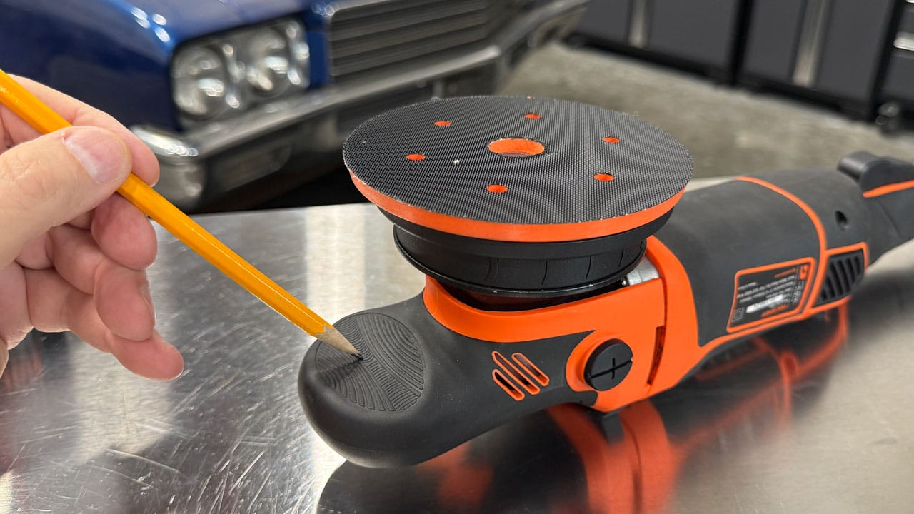

Ergonomic Textured Forward Platypus Grip​
The deep grooves running in multiple directions over the entire rubber overmold grip, (bottom and top), help you to securely grip the head of the tool giving you excellent grip strength using your hand as well as excellent control over the business end of the polisher. This rubber overmold also helps to absorb any vibrations for reduced griping fatigue.

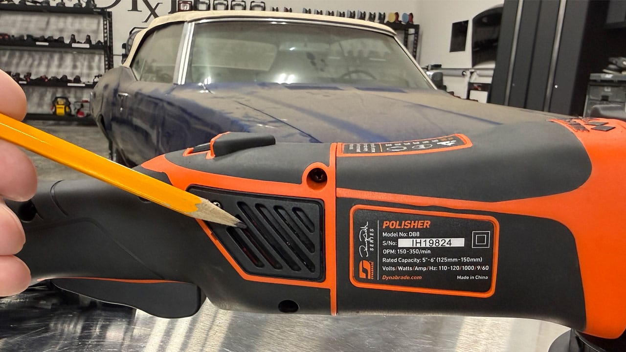

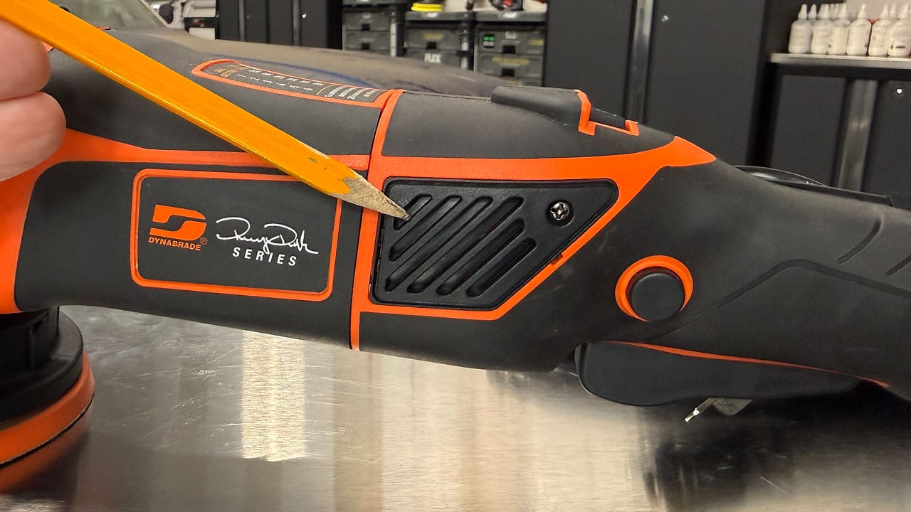

Cooling Exhaust Ports​
All power tools create a lot of internal heat, especially under heavy and prolonged use, (like buffing out a car, boat or airplane), the DB8 is designed in a way that the cooling fan, (on the electric motor), pulls air from the exhaust ports at the back of the tool, through the tool body and then flushes the warmed air out through the forward exhaust parts.

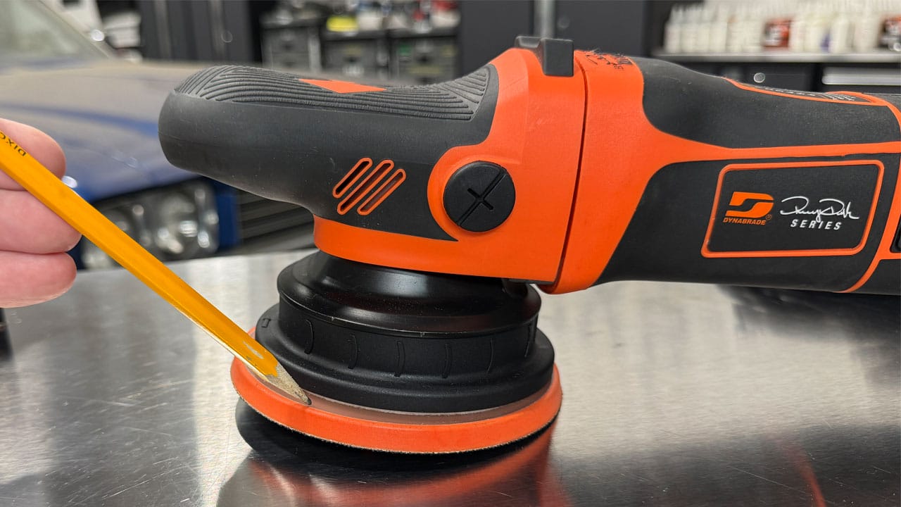

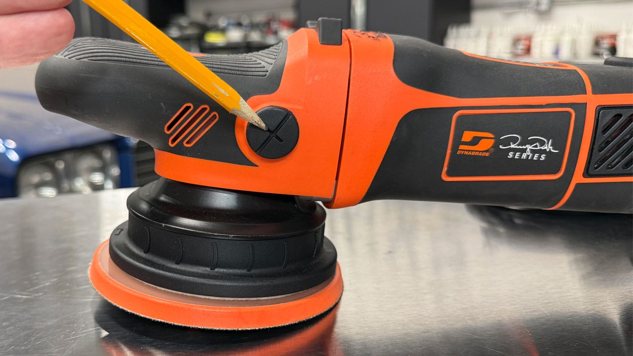

Plastic Screw​
These plastic screws or bolts simply hold the head of the polisher onto the tool body.

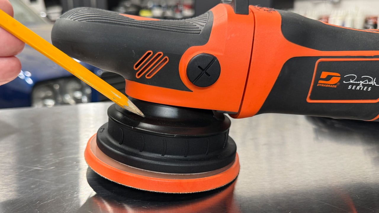

Backing Plate​
The polisher comes from the factory with a 5" backing plate already installed. Like most tools, if just learning to use a gear-driven orbital polisher, it's easier when using smaller size buffing pads. Once you get some time behind the tool and your comfort level increases, you can swap to the larger 6" backing plate and then as I like to say, turn and churn larger buffing pads. The benefit to larger buffing pads with powerful tools like this is you can tackle larger sections to buff while still maintaining efficient defect removal.

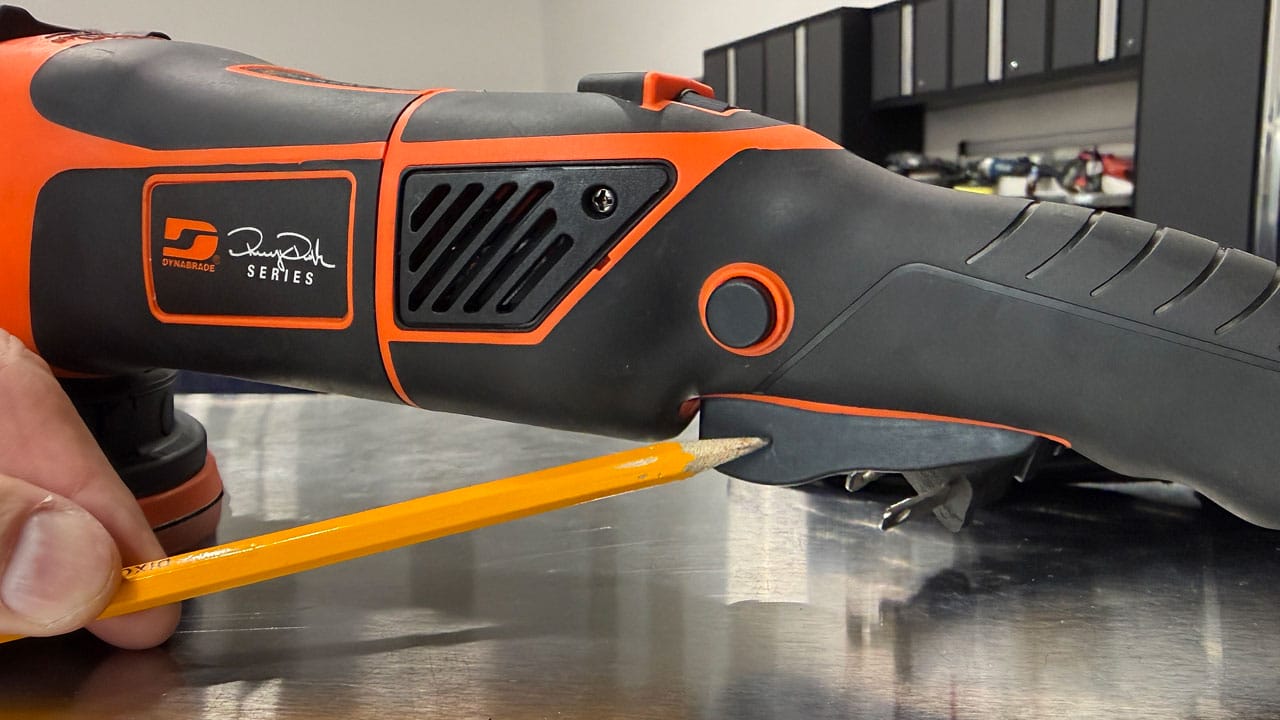

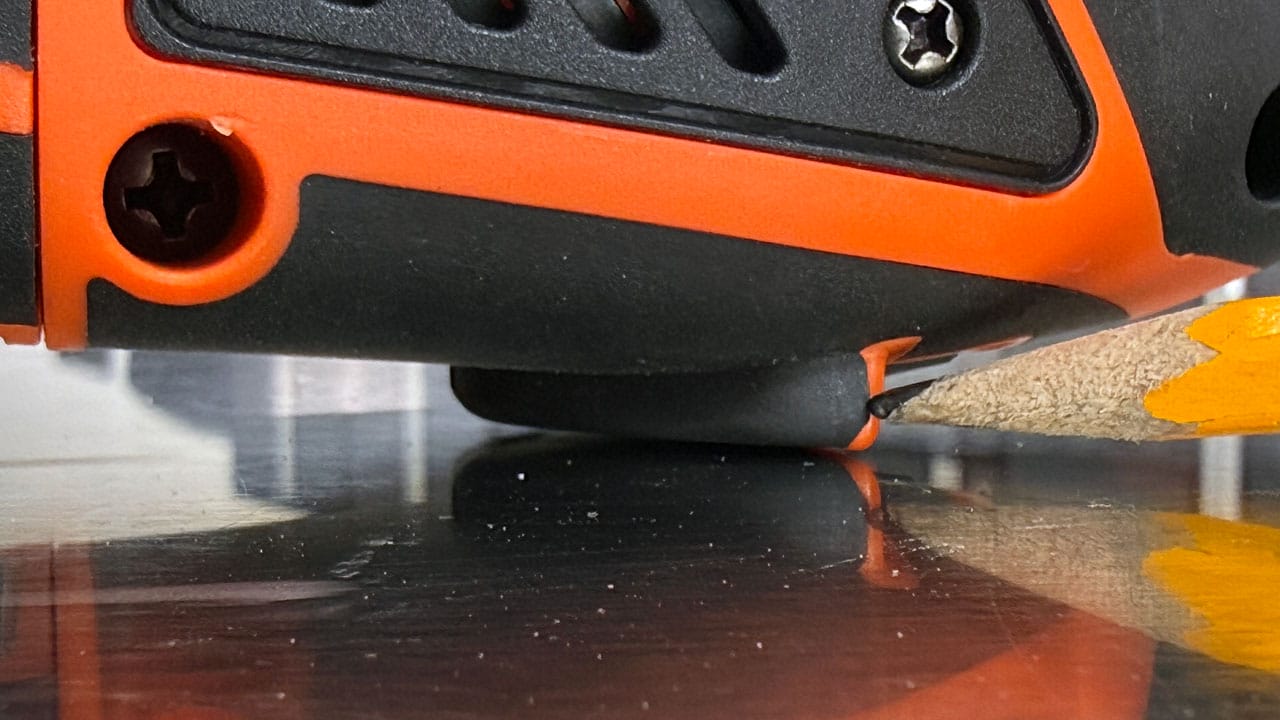

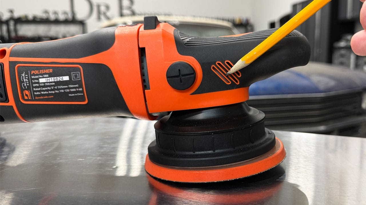

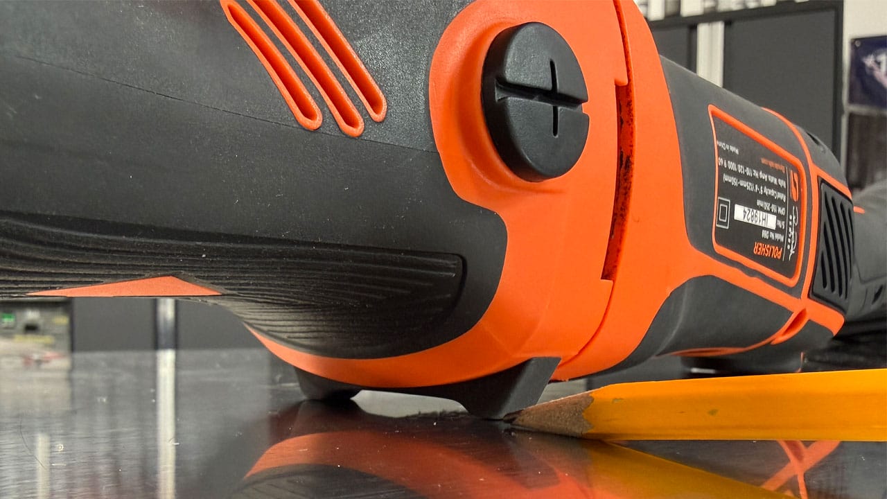

Soft Rubber Tool Rests​
A well designed tool rest is a really nice feature. It enables you to set the tool down UPSIDE down and have the tool be STABLE so it doesn't fall to either side. This prevents the sides of your buffing pads from becoming contaminated, which is kind of important.
There are two tool rests built-into the design and in my opinion - possibly the best designed tool rest of any tool I've ever used and I set my polishers down upside down a lot. All you have to do is use a polisher WITHOUT a tool rest or with a poorly designed tool rest and you'll appreciate the tool rest on this polisher.
Here's what it looks like with the polisher upside down resting on the tool rests.

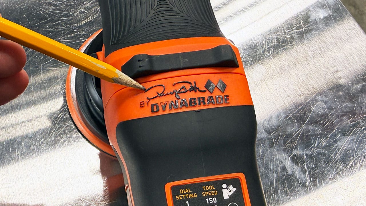

Nice touch - the Renny Doyle Signature​
Renny Doyle, a long-time friend of mine, has helped literally thousands of people start and success in the detailing industry including automotive, marine and aircraft divisions. He worked with the team at Dynabrade to develop a pro-grade polisher and it's a nice touch that Dynabrade appreciates all Renny has done for the detailing industry to include his famous, and beautifully written signature on the top of the tool.

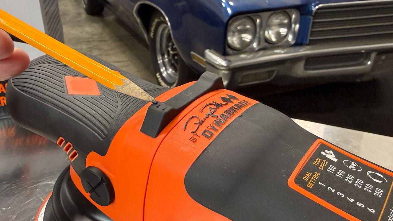

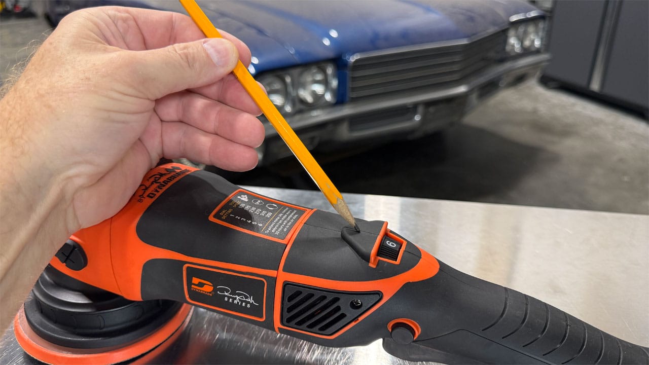

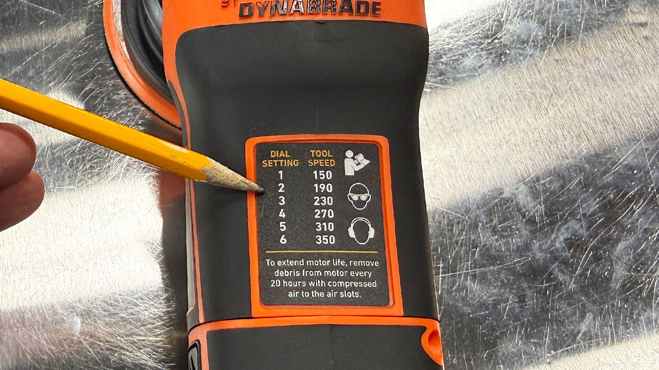

Another handy feature is there's a quick reference chart placed right on the top of the tool to show you the tool speed that correlates with the number on the speed dial.

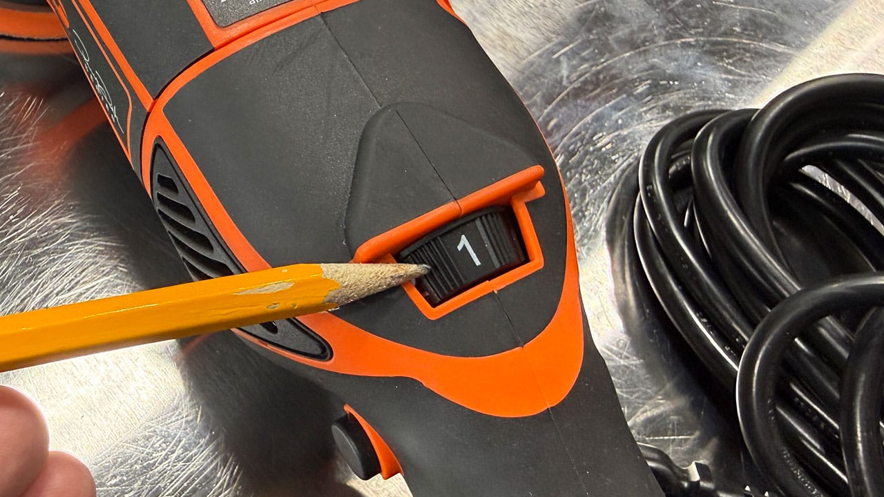

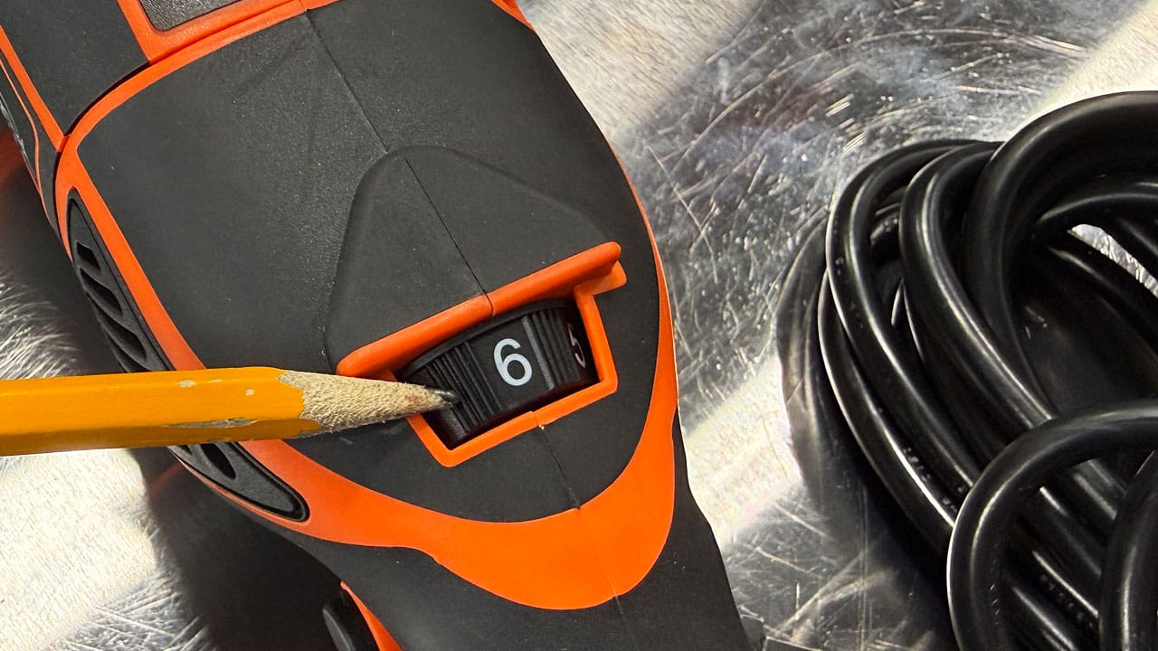

Variable Speed Dial​
The variable speed dial, which goes from 1 to 6 is large, with deep serrations and larger size numbering to make it easy to see and select your choice of speed setting while operating the polisher.

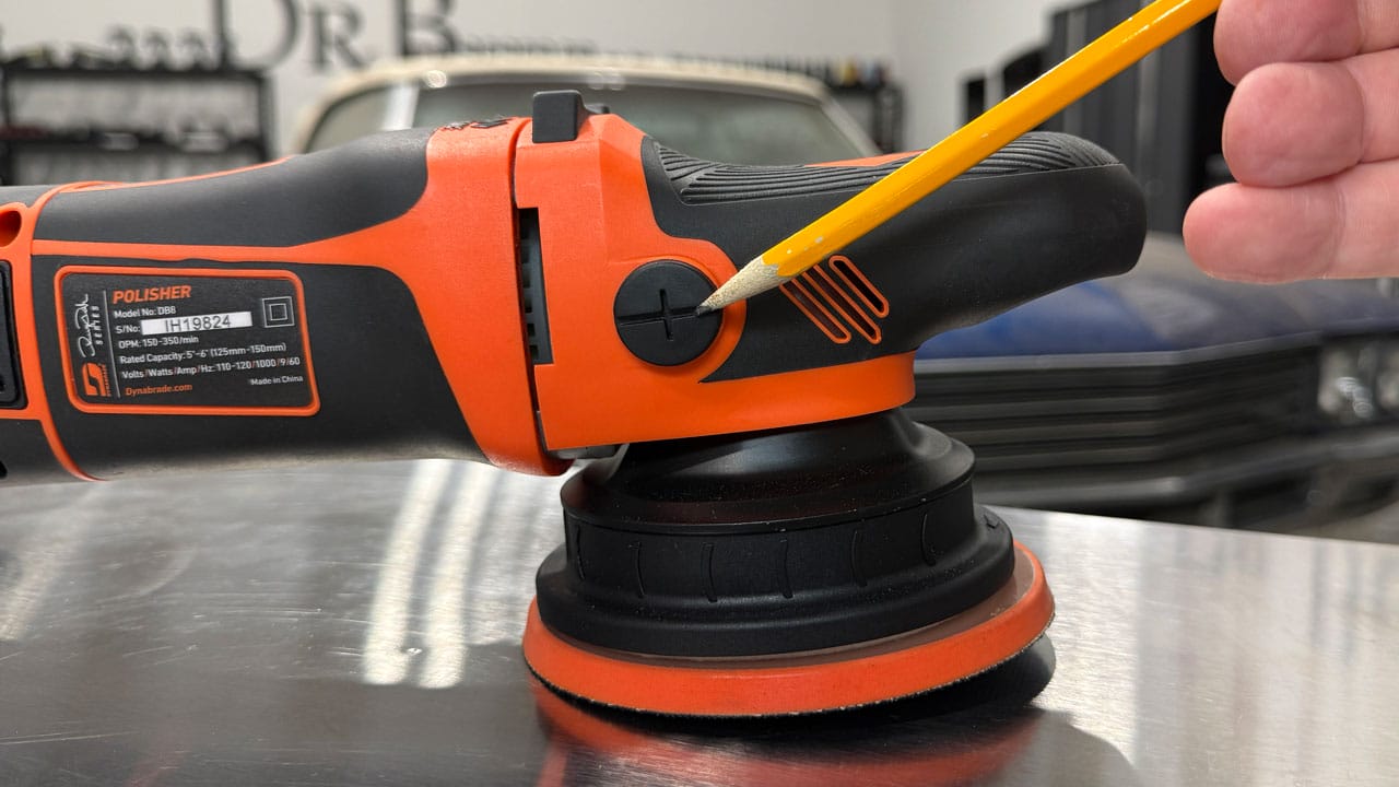

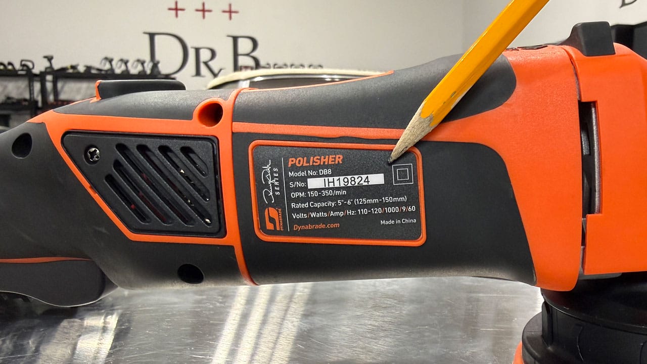

Model and Serial Number​
For inventory and warranty work and documentation, on the other side of the tool there's a badge that includes all the pertinent information about the polisher. Many tools have poorly located or difficult to read information but no so with the Dynabrade DB8 - the badge is large, easy to find and easy to read.

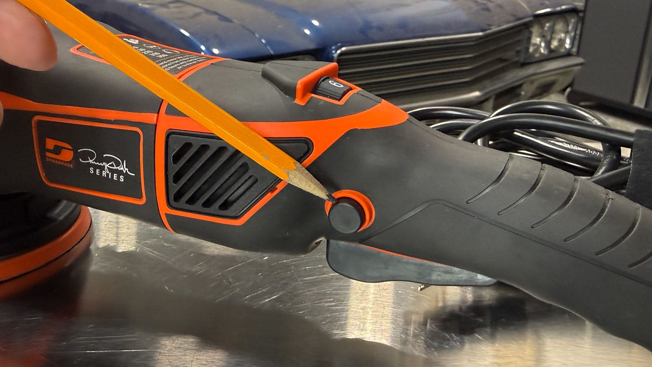

Trigger Lock​
When looking down on the polisher, the Trigger Lock is located on the left had side. The trigger lock enables you to LOCK-IN the desired speed setting selected using the variable speed dial. With the speed of the tool locked in - this frees you up to only have to grip the handle of the polisher, not grip the handle AND squeeze the speed trigger. A super handy feature especially for extended buffing projects.

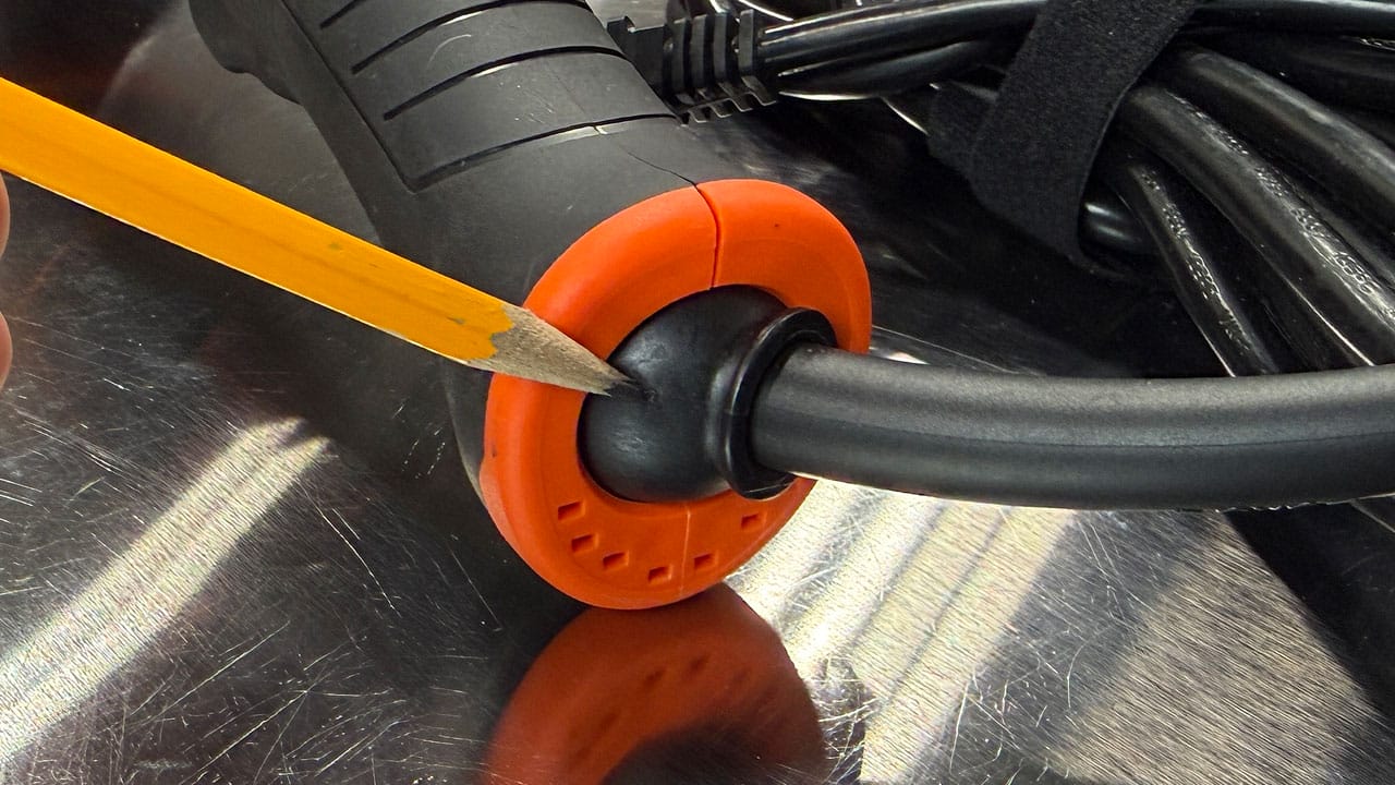

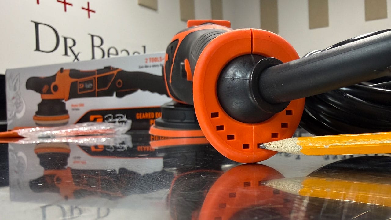

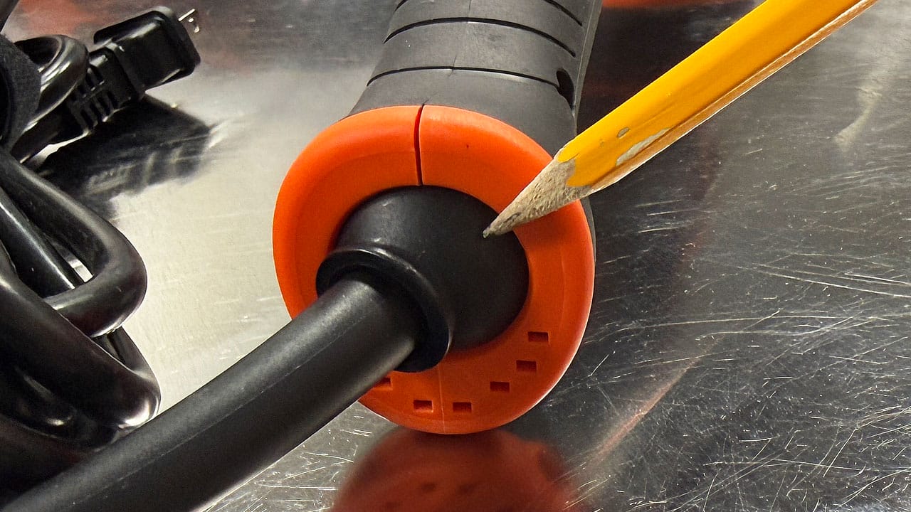

Swivel Ball Power Cord Attachment​
This is a really cool features. Pro-grade, quality tools will run for a long time without ever breaking. Often times, the weak link is where the power cord enters the tool. With a standard design tool, the power cord simply attaches to the inside of the tool body through a hole in the back of the polisher. What happens with this design is over time, the power cord wears out from all the flexing and tweaking - normal when using a polisher.
The DB8 design uses a unique swivel ball that allows the power cord to move freely depending upon the use of the tool. This is a great and even innovative design that should in theory, remove and/or reduce the chance for failure due to repeated stress to the cord and how it attaches to the back of the tool.
To demonstrate this feature, in the pictures below I pulled the cord to one side and then the other side so you can see how the swivel ball can move to match the direction or pull of the cord.
Fresh Air Intake Ports - Fluid Drainage Ports - Tooling Holes​
Besides allowing fresh air to enter the rear portion of the tool, these ports or holes also work to let any water or other fluids drain out just incase the tool gets wet or worst case scenarios - falls into the water when doing marine craft detailing on the water.

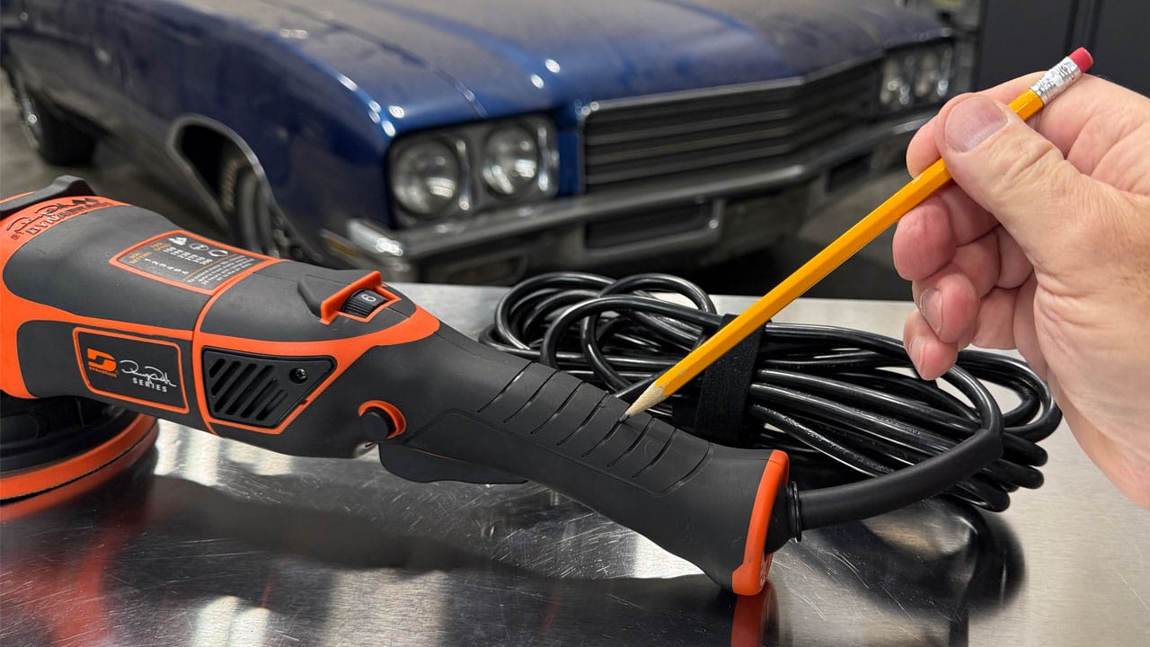

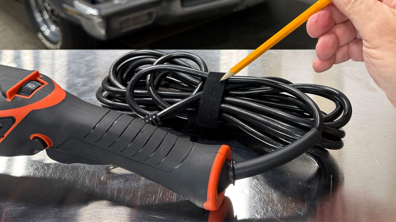

20' Power Cord​
Another nice feature is the long, 20' power cord. Depending upon the layout of your garage or shop, and where the electrical plug-ins are located, with a 20' power cord, in most case you'll be able to buff out all 4-sides of a car by simply plugging into the nearest electrical plug-in so you won't need to use an extension cord.
Plus, the tool manufacture knows what gauge copper electrical wire, (inside power cords), and you can trust the factory cord will flow enough electrical current in the form of AMPS to safely and efficiently supply the necessary electricity to the tool motor.
NOTE: If you do need to use an extension power cord, be sure to choose a 12 gauge cord, (heavy duty), and you should try to always avoid using any extension cord longer than 25'. Its better to locate and use a closer source of power than to use a 50' or longer extension cord.

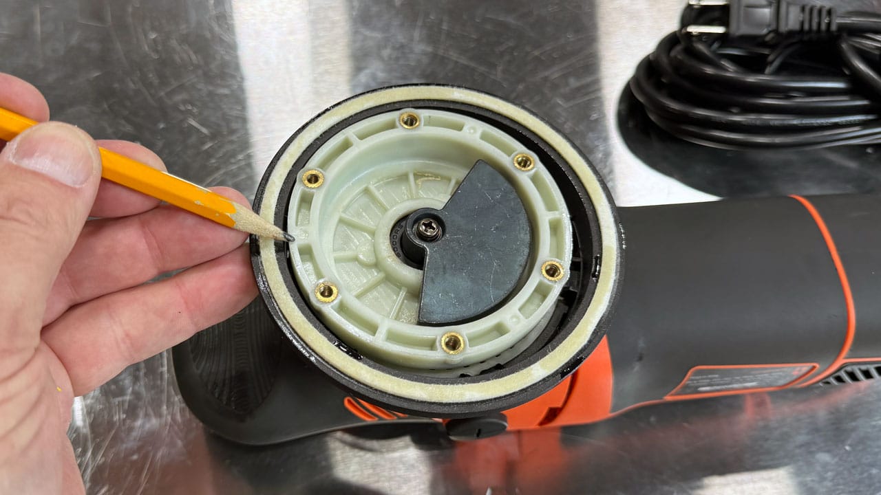

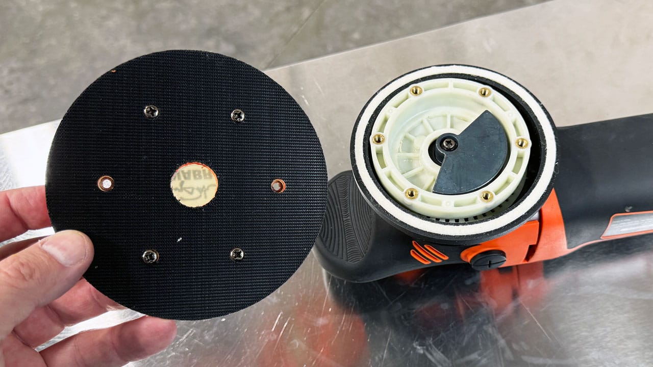

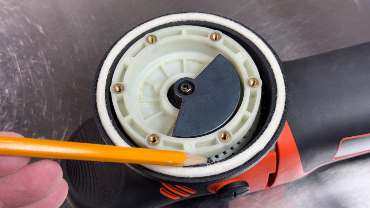

Let's Take a Look at the Drive Mechanism and Backing Plates​

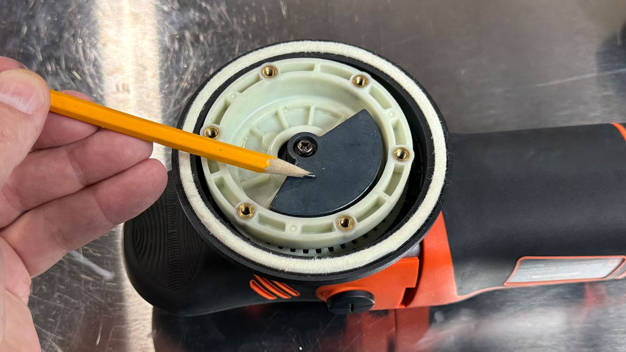

A huge part of what separates this gear-driven polisher from free spinning, random orbital polishers are the actual GEARS that oscillate and rotate the backing plate and thus the buffing pad. And because this tool comes with an optional 6" backing plate, we'll take a look at how the backing plate attaches to the drive unit.
The Inner and Outer Gear Ring Set​
With the backing plate removed, you can just barely get a glimpse of the outer gear ring. , which is hidden by the drive plate. What you can't see in the inner gear ring, but you trust it's there - otherwise the tool would not operate.
And of course, it's this GEAR-DRIVEN aspect for tools like this that make them what they are. Because of the gear-driven design - the buffing pad will ALWAYS rotate and oscillate - there's nothing you can do to stop these to movements or actions.

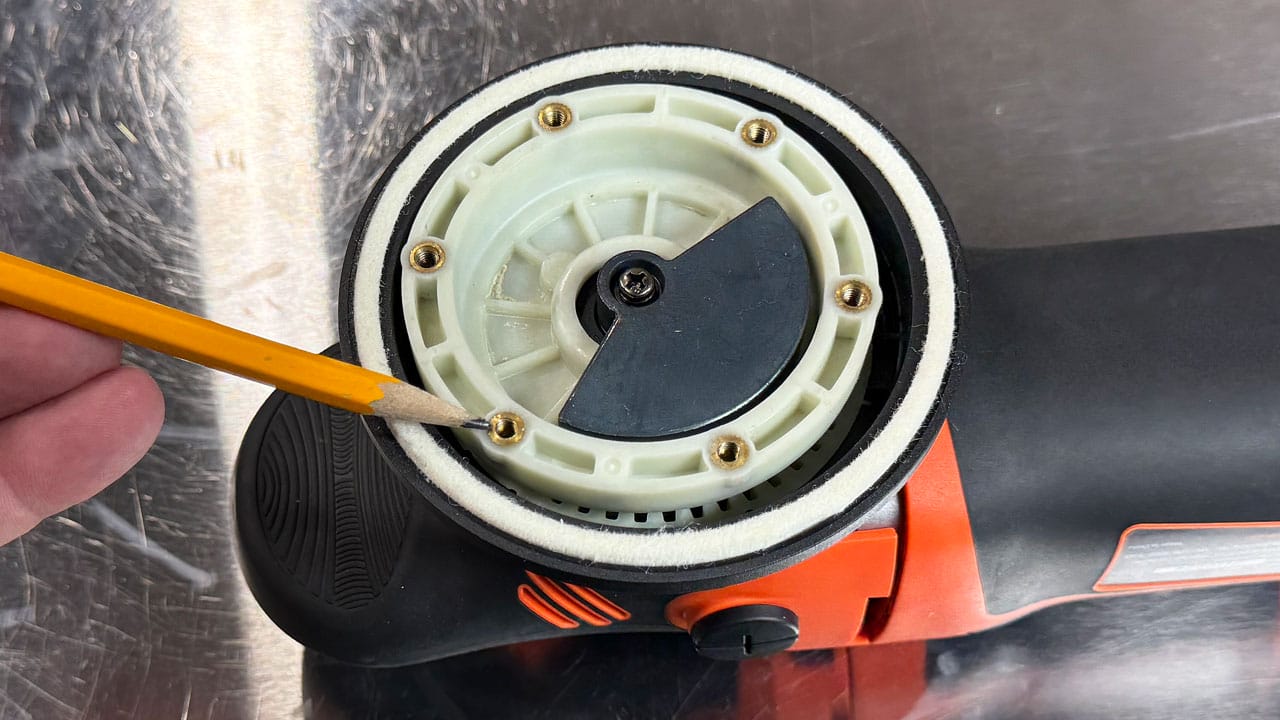

Orbital Cover​
This is the component that is fitted to the external gear and provides the interface that holds the felt ring and the interface for which you can attach the backing plate using 6 machine screws.

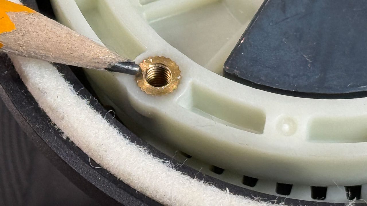

Premium Threaded Brass Inserts​
The Orbital Cover uses brass insets for threading in the machine screws. This is actually an important part of this tool as each time you turn the polisher on - torque is applied to the shaft of the machine screws and if they were not solidly attached to the Orbital Cover, you could break the tool.

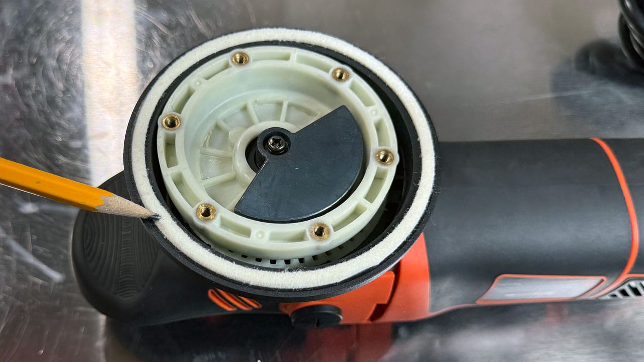

Balance Weight​
Other tools refer to this is the counter weight, and this offset rotating weight helps to remove vibration and smooth out the action of the tool.

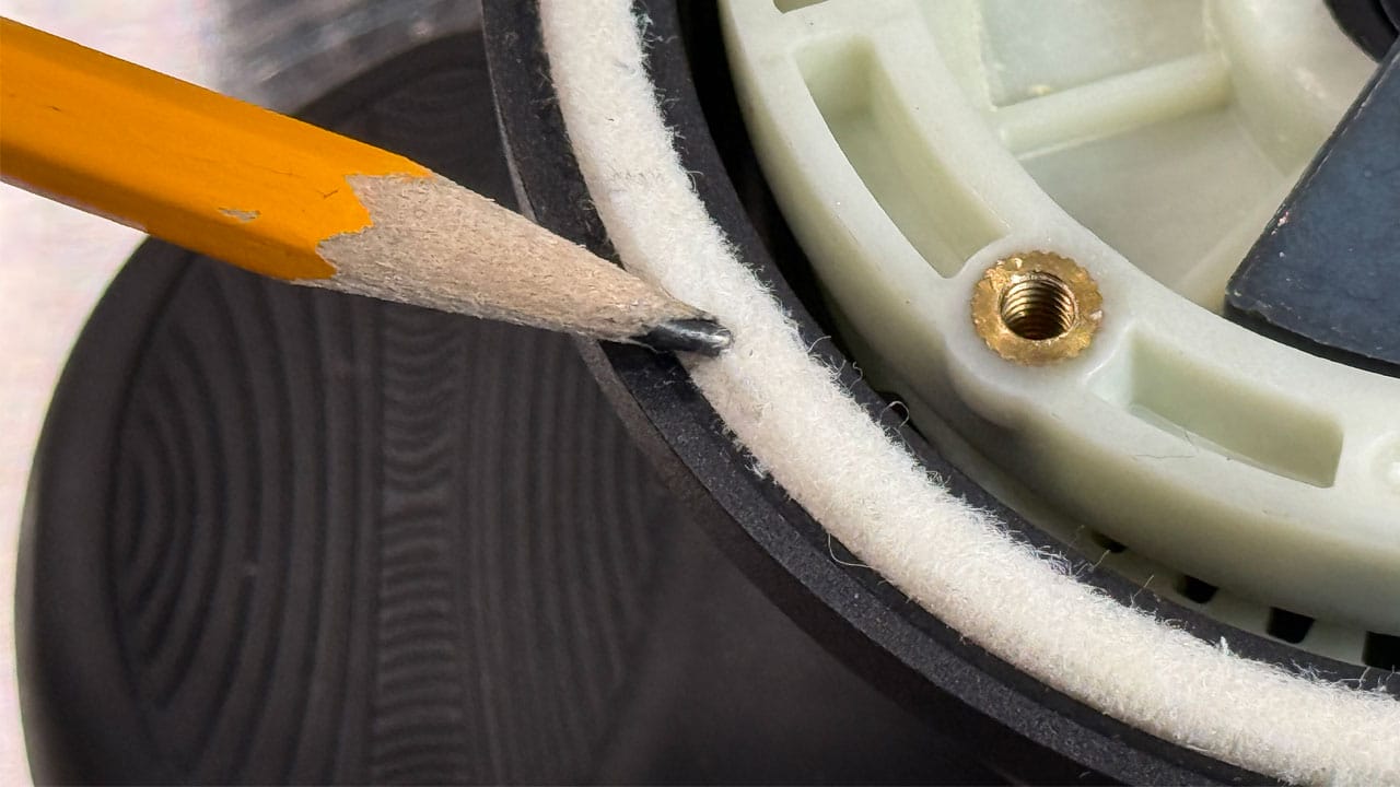

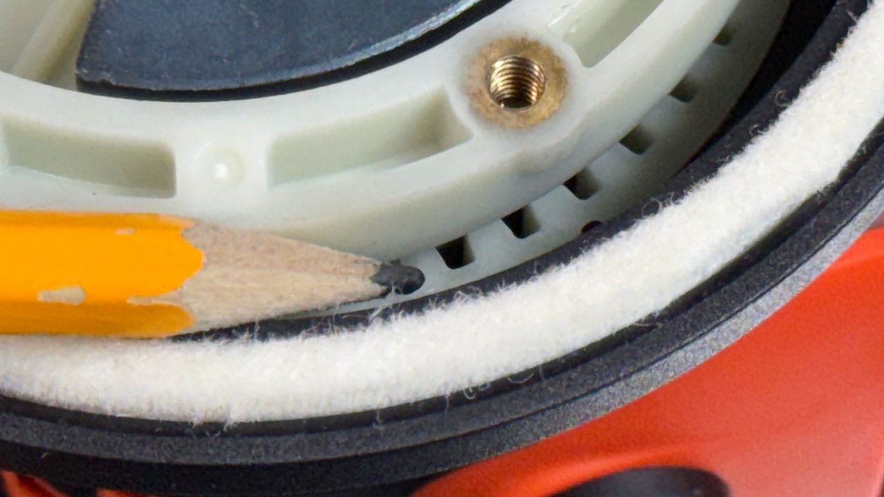

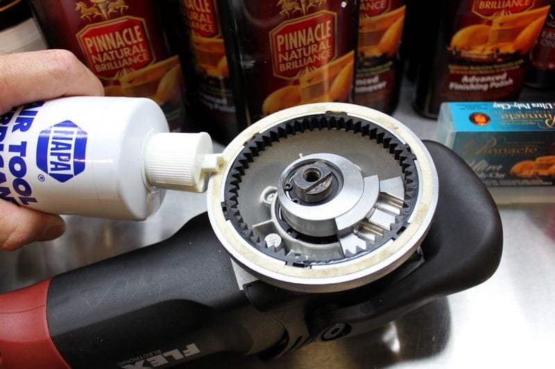

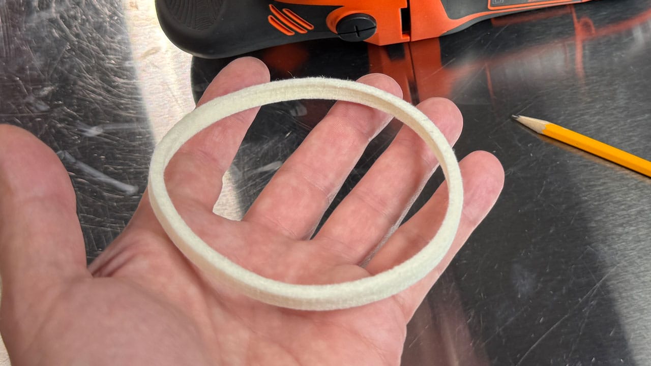

Felt Ring​
The felt ring is a crushable interface that provides both slip and cushion between the hard surface of the backing plate and the hard surface of the orbital cover. The felt ring is a wear item and should be removed and turned over and periodically replaced as needed.
Mike's comment​
I wrote a book for FLEX Power Tools a few years ago and also wrote a popular article on the topic of lubricating the felt ring. In the book and the how-to article, I recommended using a light machine oil to lubricate the felt ring inside the FLEX XC 3401 VRG gear-driven orbital polisher. Here's a picture from that article and section in the how-to book.
FLEX never stated to or recommended to lubricate the felt ring, this was my recommendation after learning via thousands of hours behind this tool. Here's why I lubricate the felt ring. Because you cannot stop pad rotation or pad oscillation no matter what - this means you can press down hard on the head of the tool for situations where you need to remove major defects. When you press hard, the backing plate flexes or bends and makes contact with the felt ring and also the aluminum housing and damages the backing plate. I found by adding a few drops of a light oil - this prevented any damage. It also prevented tiny black shards of plastic coming off the backing plate and flying outward where you could potentially trap these tiny hard, plastic shards between the paint and the face of the buffing pad - potentially causing damage to the paint.
For me? I'm going to lubricate the felt ring in this brand new tool whether it needs it or not or whether or not Dynabrade recommends it or not. The reason why is because,
  • I buff a lot of severely neglected cars and as such, when using these types of tools I take advantage of all the power and this means I do press hard on the head of the polisher when I need to go after serious or deep defects.
  • I don’t believe, and I could be wrong, but I don’t believe adding a little lubrication oil to the felt ring can hurt anything. It might not help, (but it might), but it certainly will not hurt anything as far as the performance of the tool. So, this is a proactive measure I take for gear-driven, orbital polishers with felt rings.
WARNING​
When removing the felt ring be careful to NOT stretch it. Remove it carefully, slowly and gently to preserve the original diameter. If you yank it out of the housing and stretch it - you will find it very difficult and time-consuming to try to re-insert it. I kid you not. So be careful. I use a the pointy end of of thumb tack to gently pry the felt ring up and out of the housing and once I get a portion lifted out, I use my fingers to extract the entire felt ring.

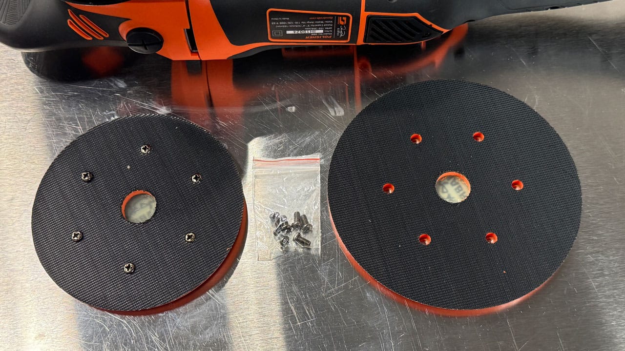

Backing Plates​
IMPORTANT: Backing plates wear out. Each time you REMOVE a buffing pad from the backing plate - you stretch the hooks that are a component of the hook-n-loop system used to attach buffing pads to backing plates. If you're an enthusiast and only detail your own cars - its much less of an issue.
However, if you're a professional, swapping pads on a daily basis, the hooks are going to stretch out and at some pint you may experience buffing pads flying off the polisher. Knowing this ahead of time, I practice, teach and preach to always have a back-up backing plate. Here's the links to get your backups.
• DB8P5 - 5" Backing Plate
• DB8P6 - 6" Backing Plate

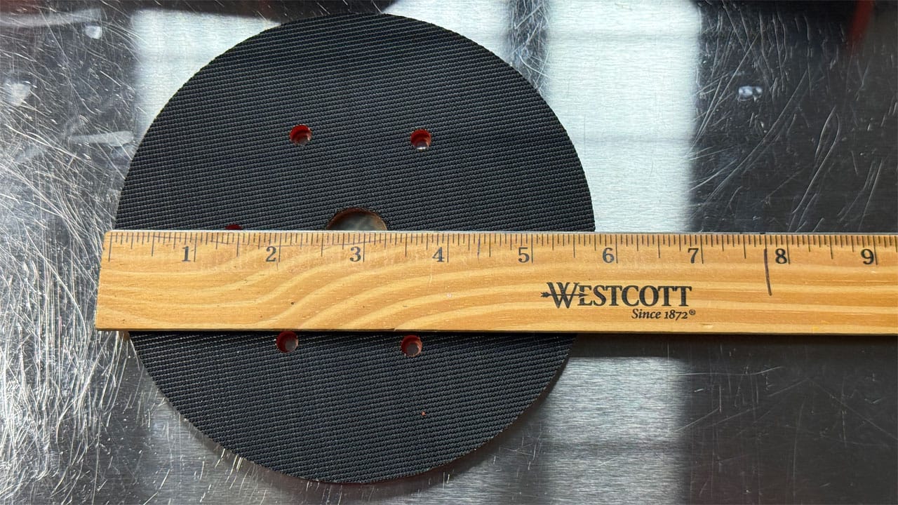

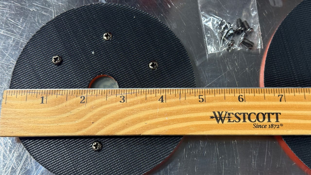

5" and 6" Backing Plates​
It's common in the tool industry to round-off numbers for simplicity. It's also normal for backing plates to be a tick undersize for the back of the appropriate size buffing pad otherwise it's difficult/impossible to center the pad to the backing plate. This hold true for Dynabrade backing plates. Below are pictures showing measurements for both the 5" and the 6" backing plates.
According to my ruler and my eyes - the 5" backing plate is approximately 4 3/4" - not a full 5 inches.
And when I measure the 6" backing plate I'm seeing 5 3/4" - not a full 6 inches.

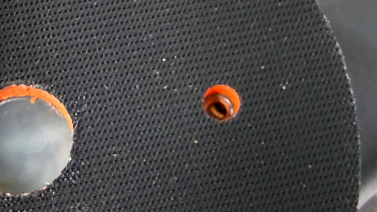

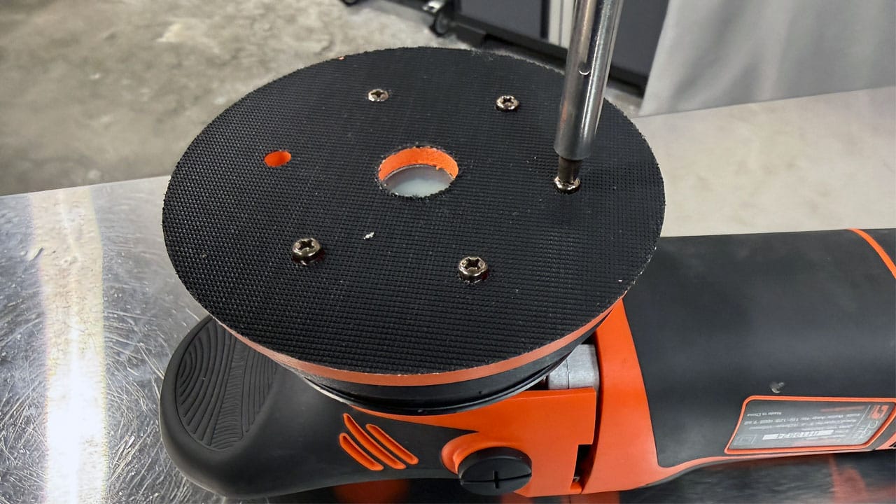

Backing Plate Attachment - Tips​
After removing the 5" backing plate from this brand new DB8 polisher, I just wanted to share a couple of tips to help you either re-install the 5" or to install the 6".

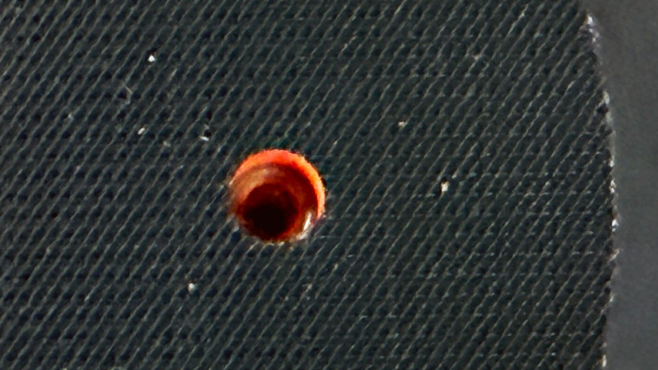

Simply make sure 2 of the machine screws are removed and then place the backing plate onto the orbital cover looking to make sure the holes in the backing plate are aligned with the holes in the orbital cover.
In the below picture - you can easily see the backing plate is NOT aligned correctly.
In the below picture you can see the hole IS aligned correctly
Once you've aligned the backing plate - next install and tighten the machine screws.

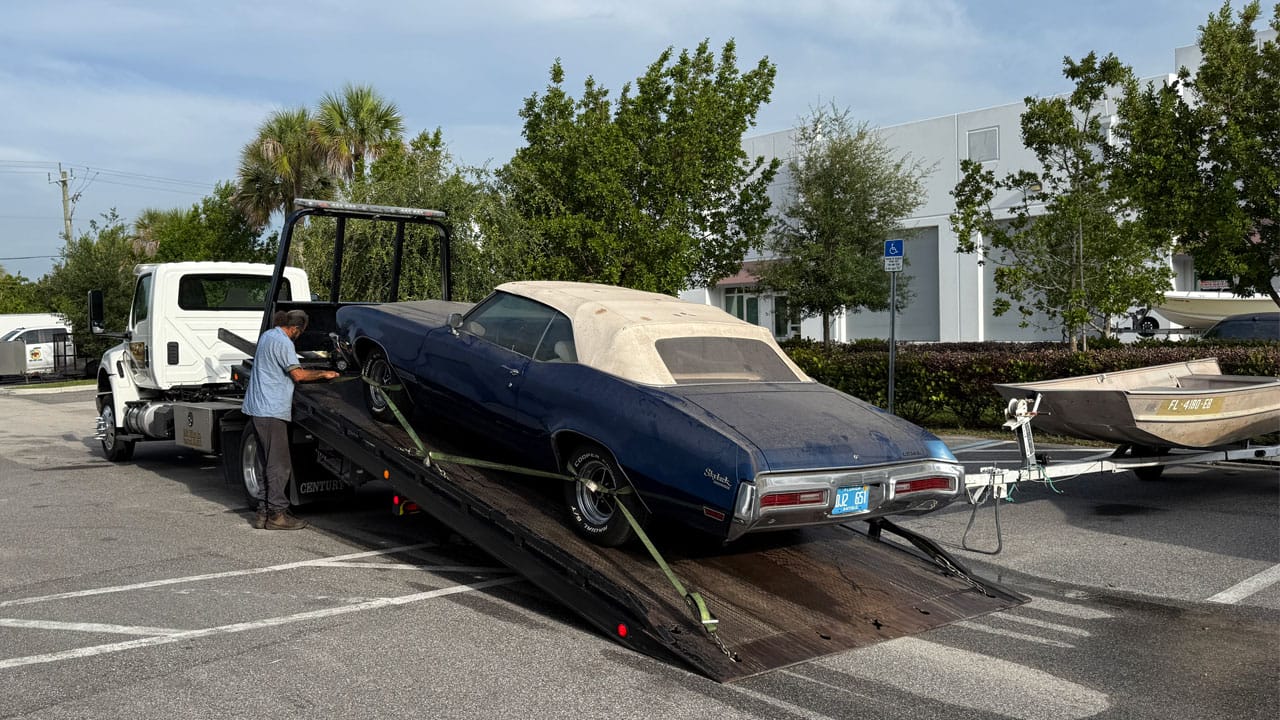

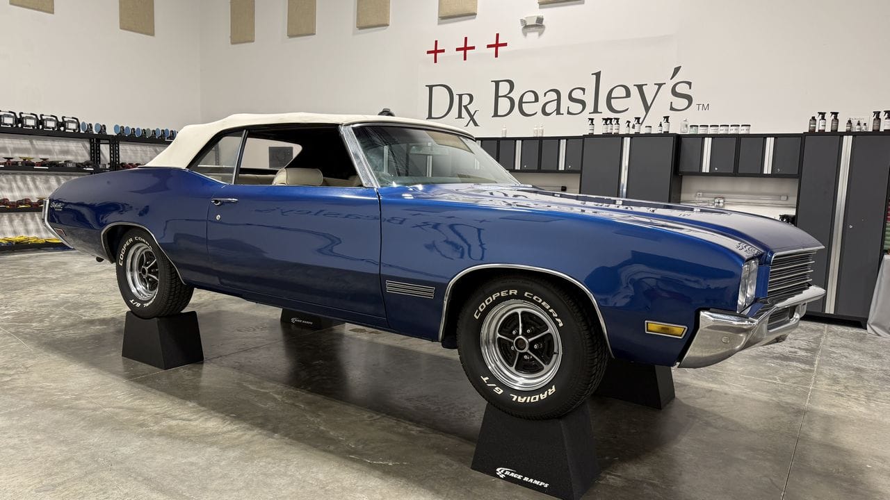

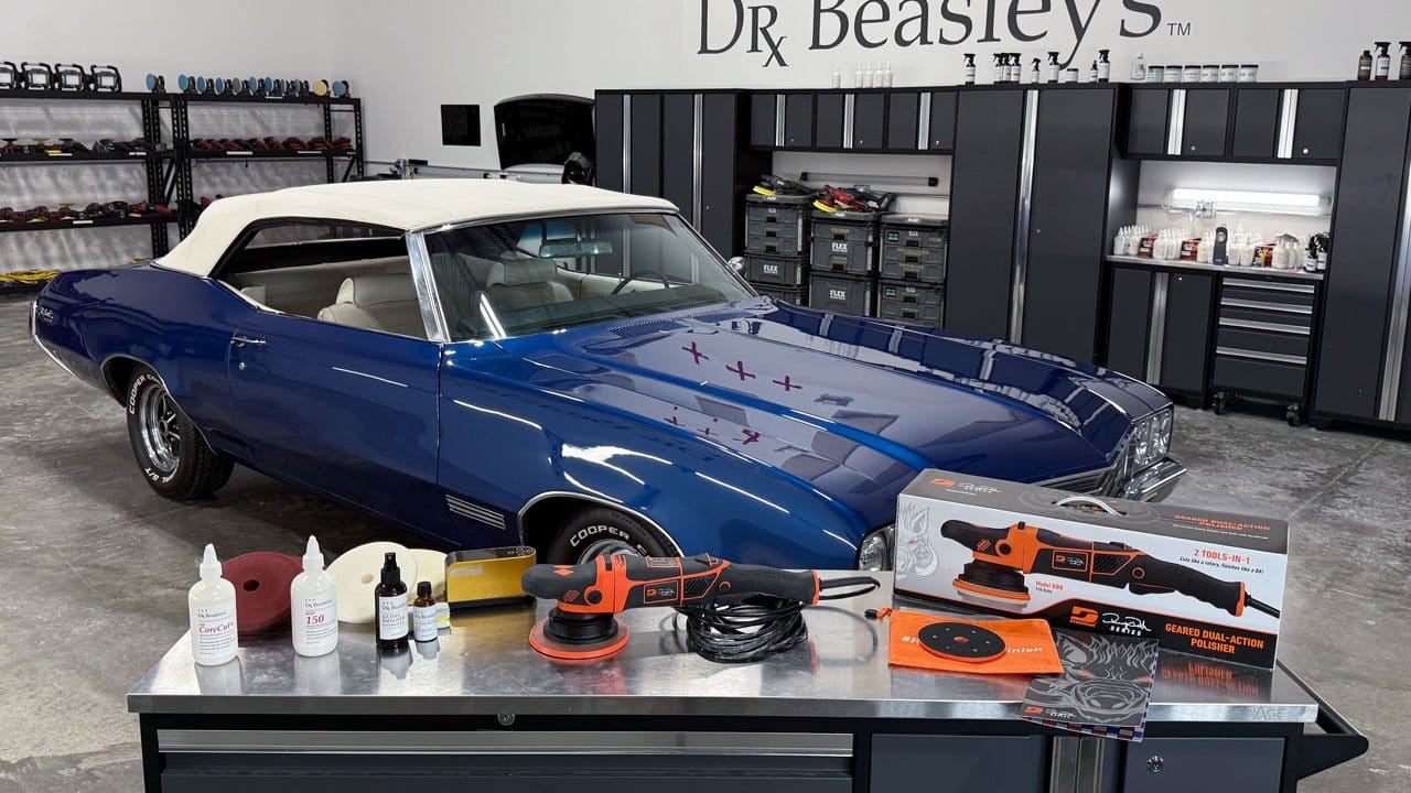

Test Driving the DB8​

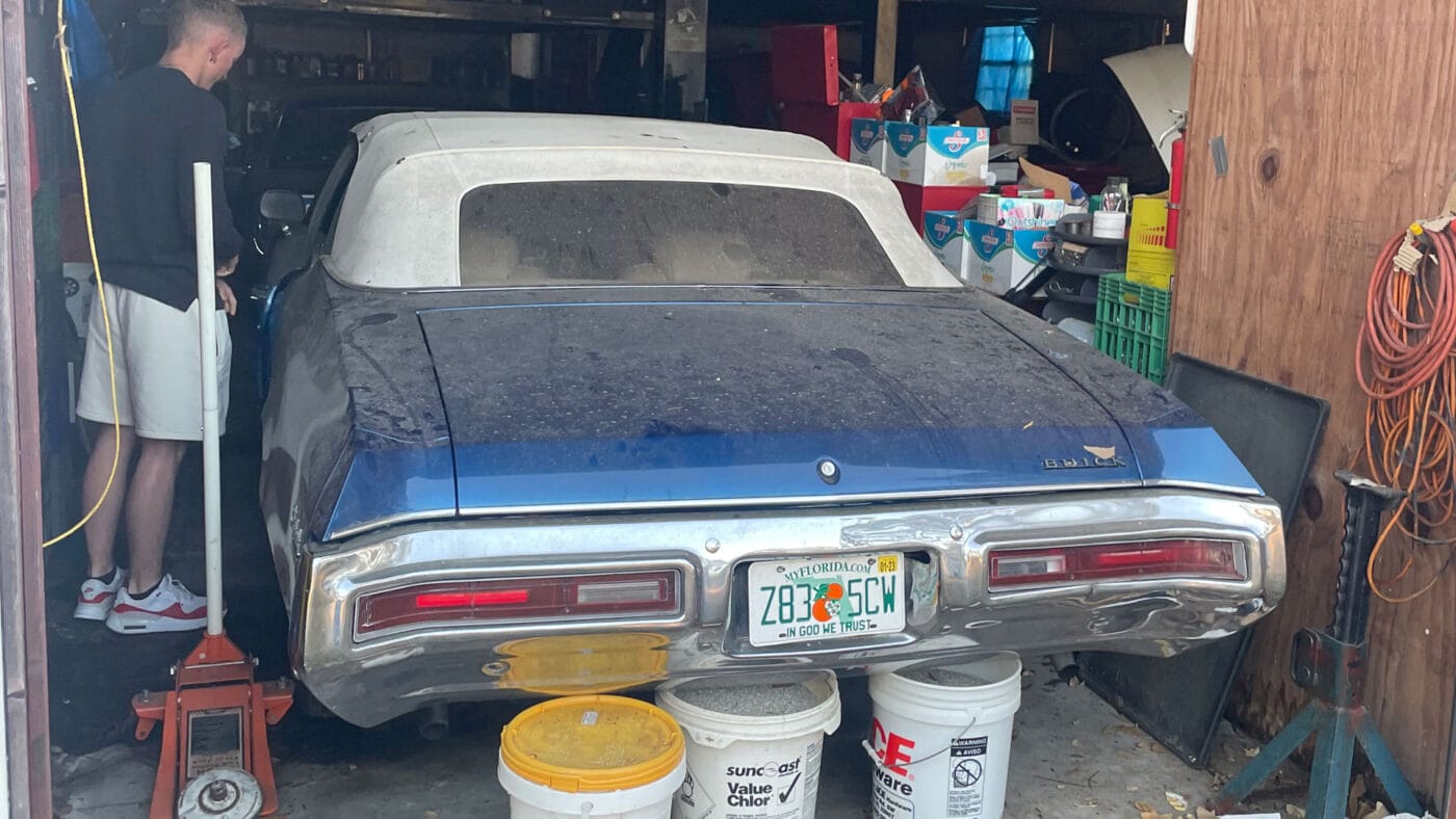

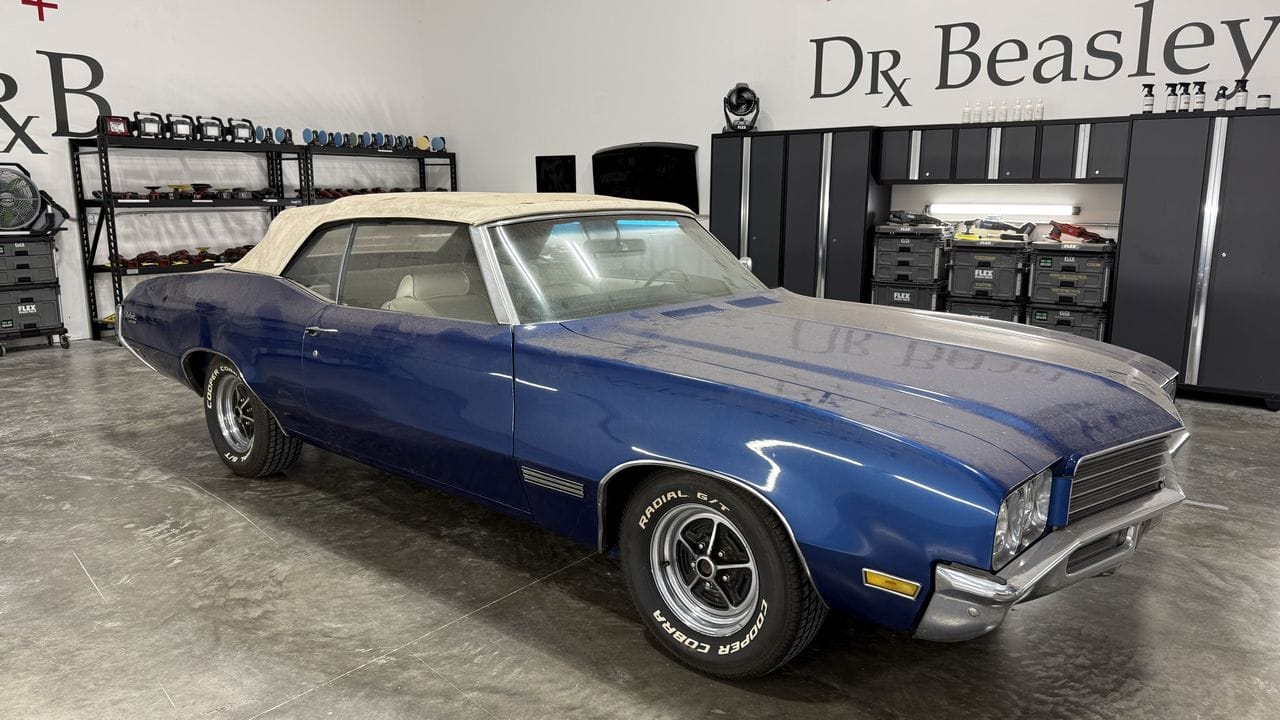

Anytime I do a review for a tool, pad, product or technique, I actually use a real detailing project for the review. In this example, this Barn Find 1971 Buick Skylark Custom Convertible was dropped off at the Dr. Beasley's Training Center in sunny, Stuart, Florida. This car has been sitting in a Pole Barn for around a decade or so just getting dirty and going cosmetically - downhill.

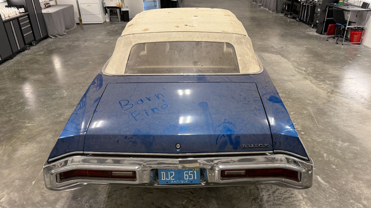

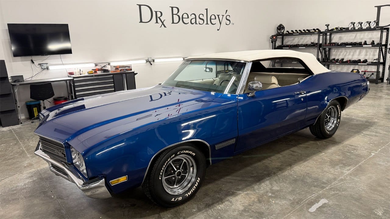

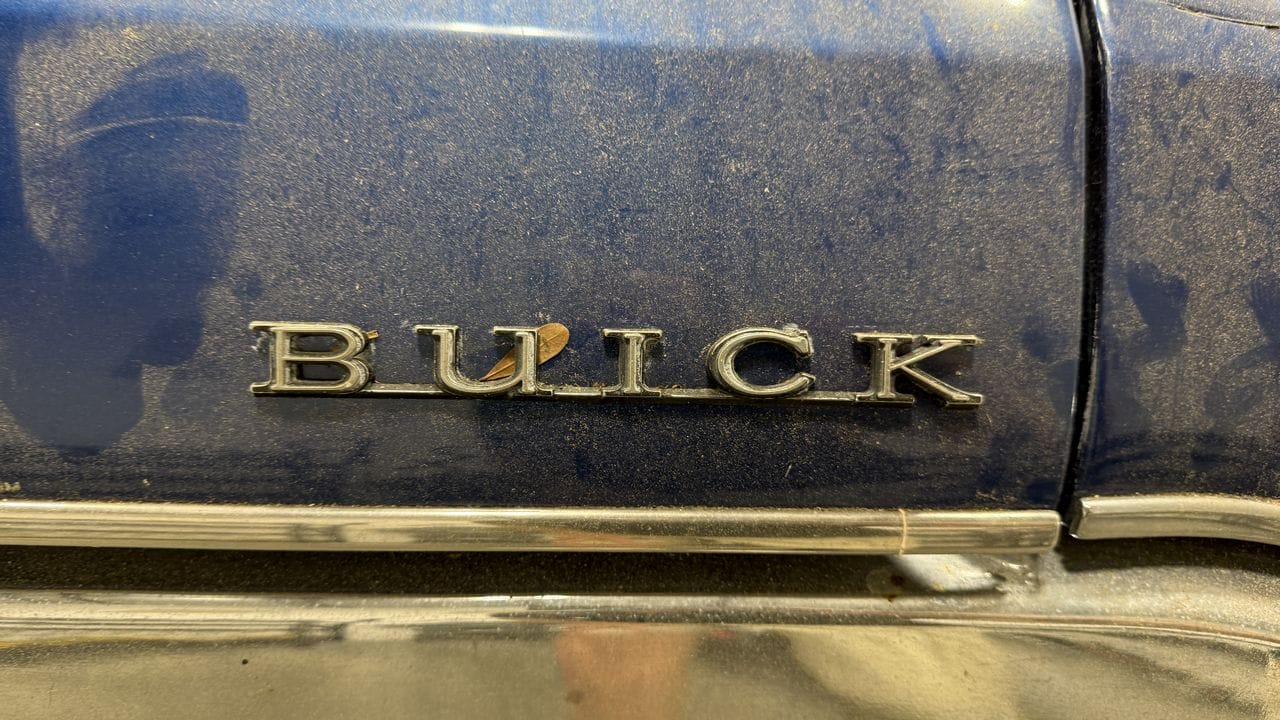

Here she is arriving to Dr. Beasley's in sunny, Stuart, Florida

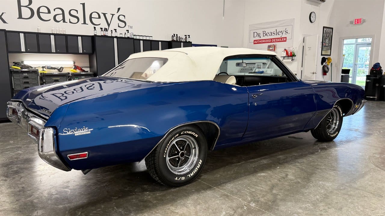

After an Extreme Prep Wash​
After an Extreme Prep Wash including machine scrubbing the vinyl, machine scrubbing the tires, mechanically decontaminate paint, glass and chrome followed by a total body wash. In the picture below, most people would think, Wow! She looks pretty good! But that's when you're standing 10 feet away. Check out the pictures below where I'll use a high intensity ScanGrip Swirl Finder Light to show the true condition of the paint.

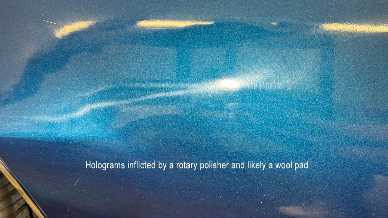

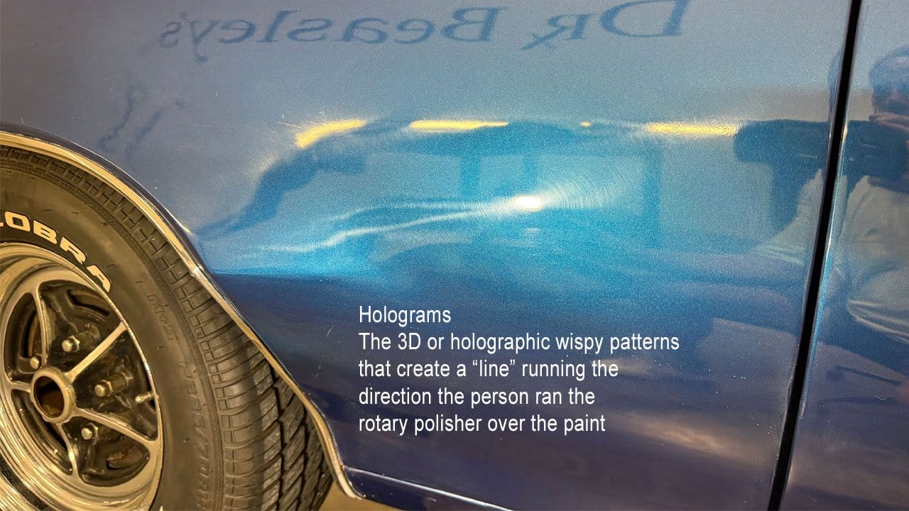

Holograms - Swirls - Scratches - Repair Edge Mapping Caused by Coating Shrinkage - Graininess - Oxidation - Surface Staining​
The paint on this car has a lot of different types of paint defects to remove.

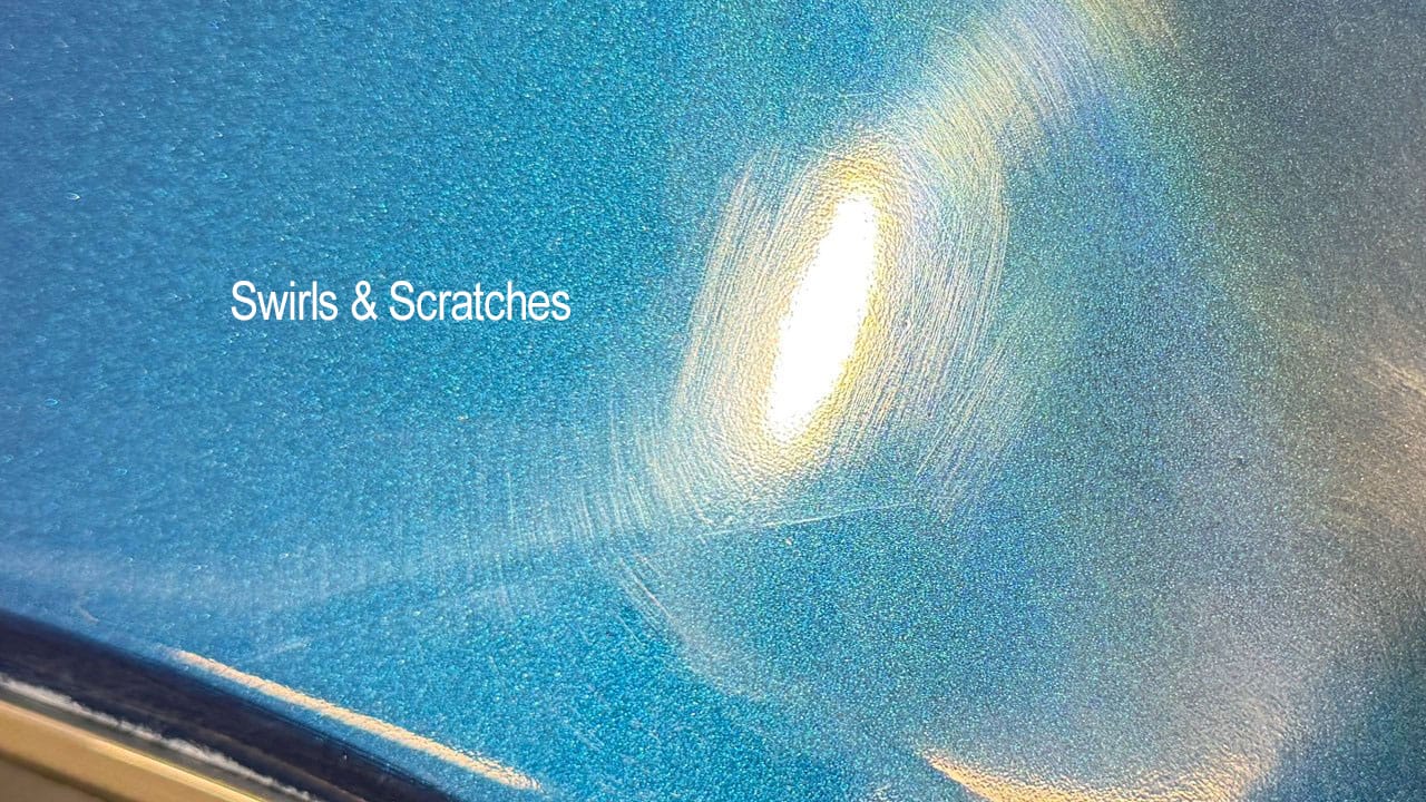

Holograms​
Swirls & Scratches​

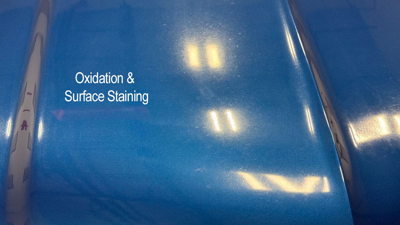

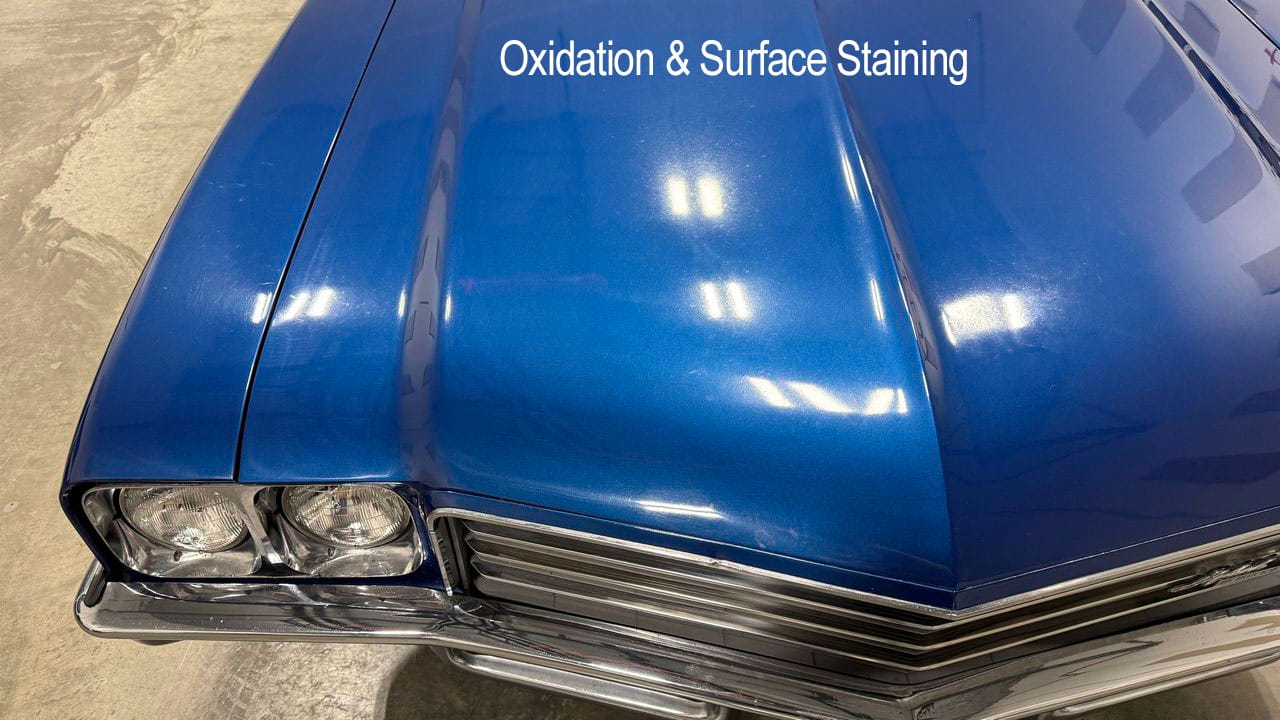

Oxidation & Surface Staining​

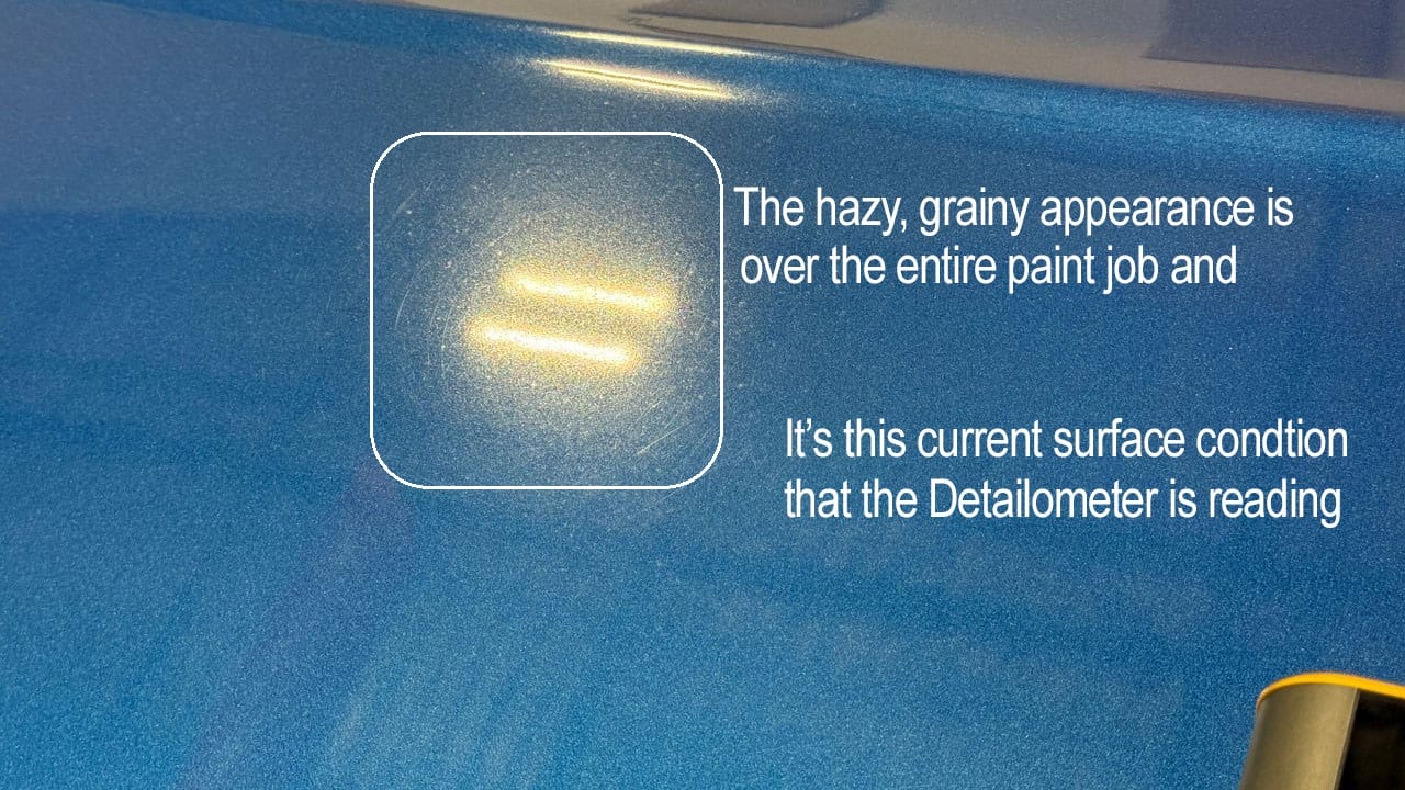

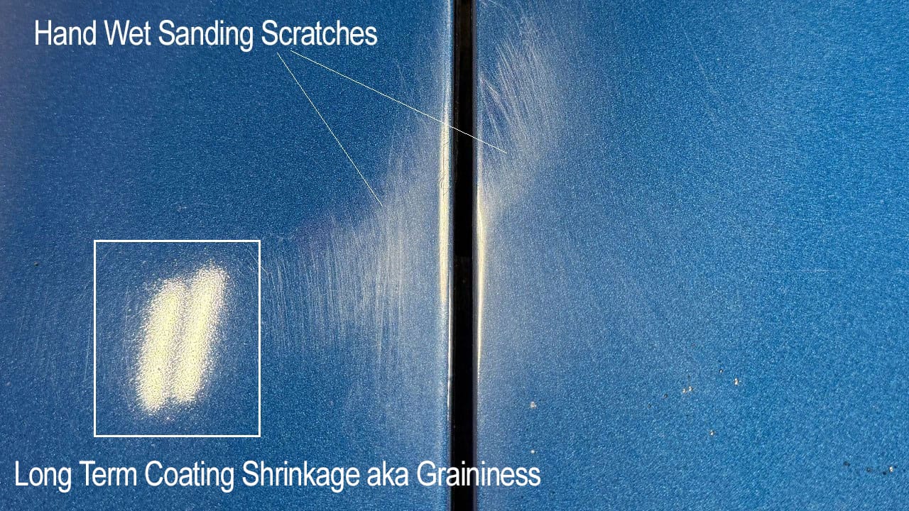

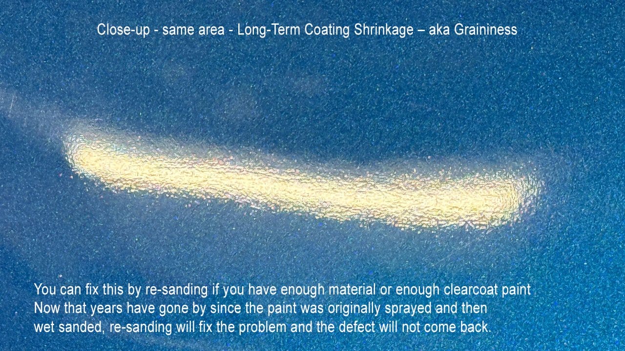

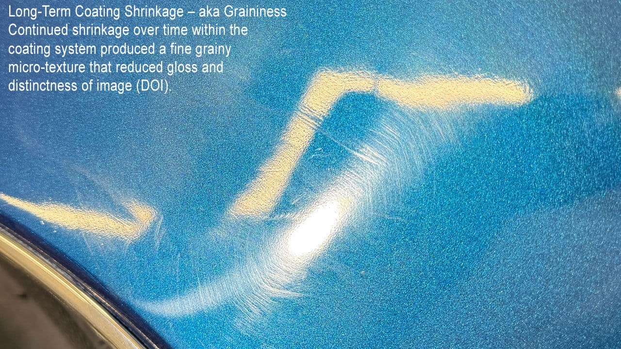

Long Term Coating Shrinkage aka Graininess​

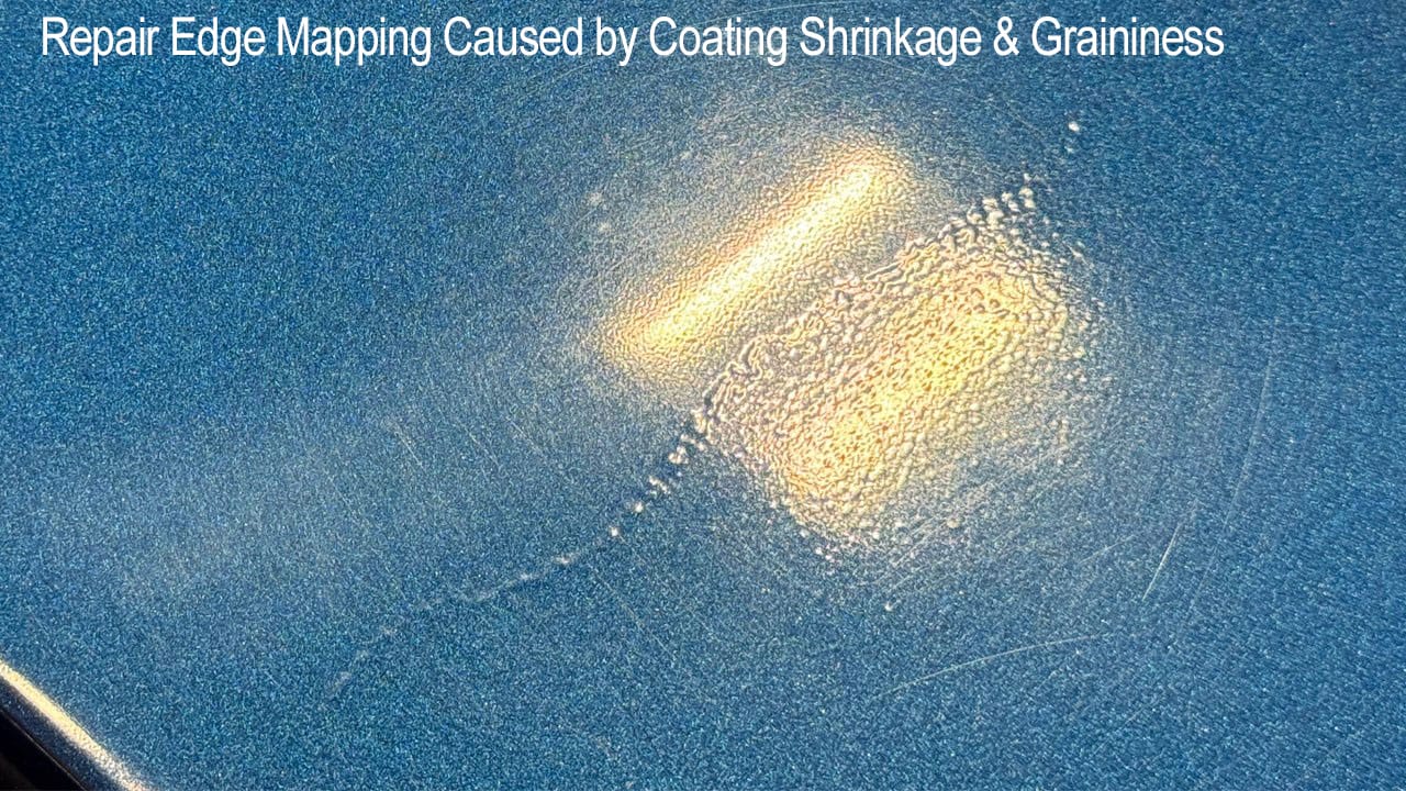

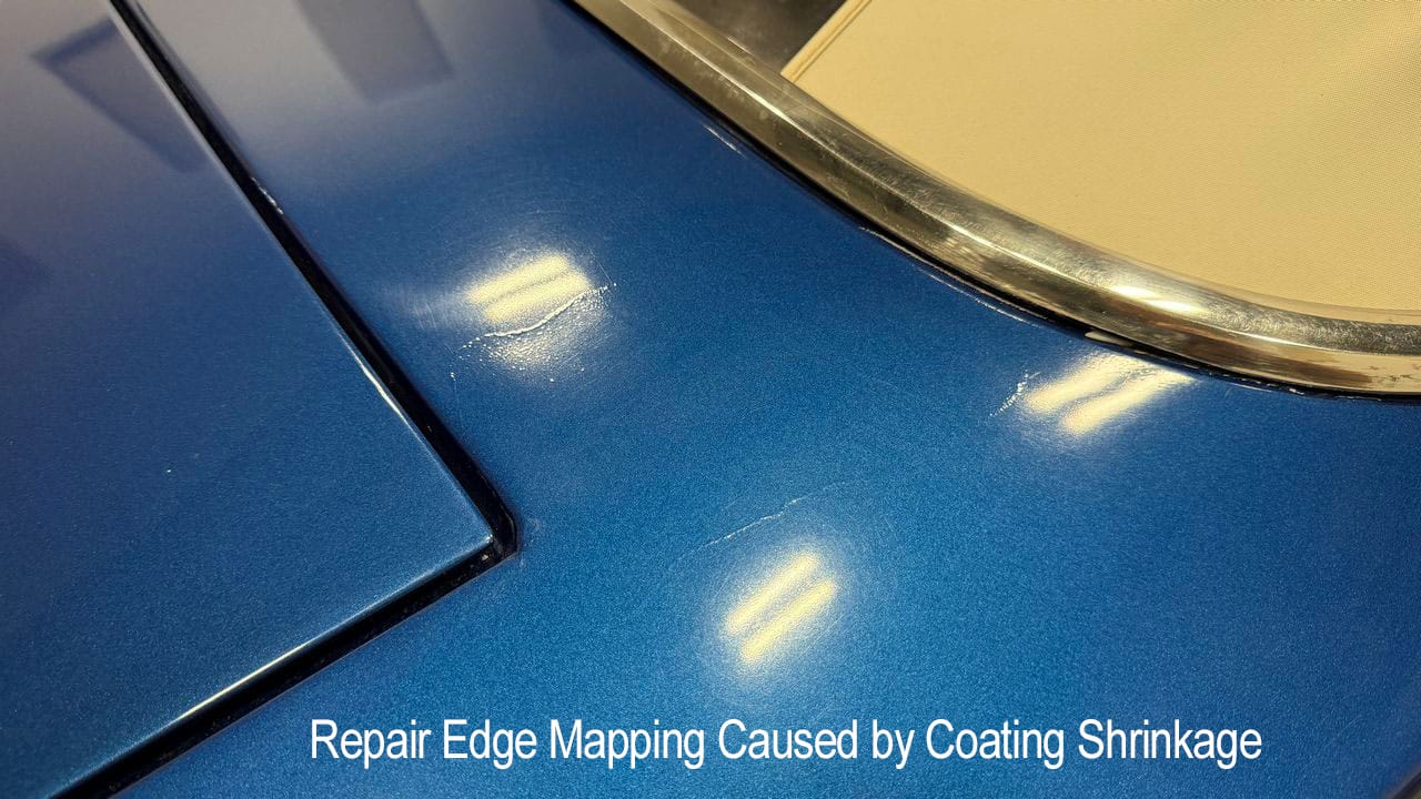

Repair Edge Mapping Caused by Coating Shrinkage & Graininess​

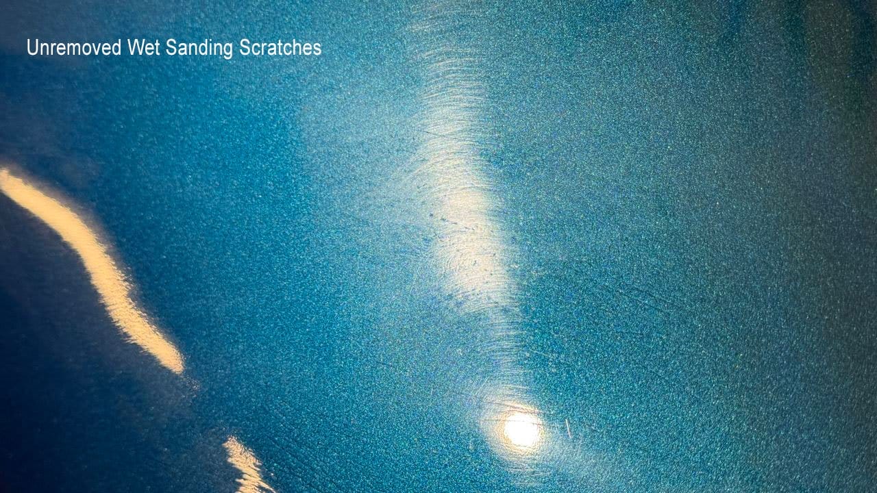

Hand Wet Sanding Scratches - Not Removed​
So, yeah, she looks good if you stand back about 10 to 20 feet but up close with a quality inspection light, the light tells a different story.

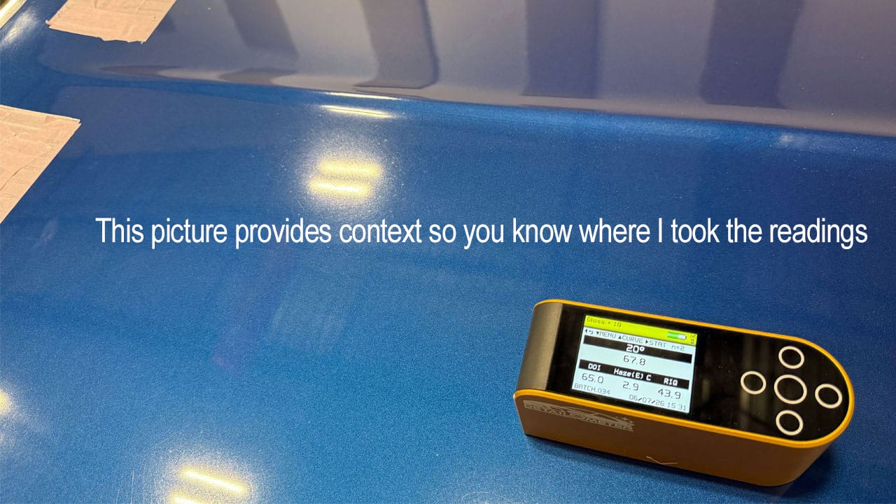

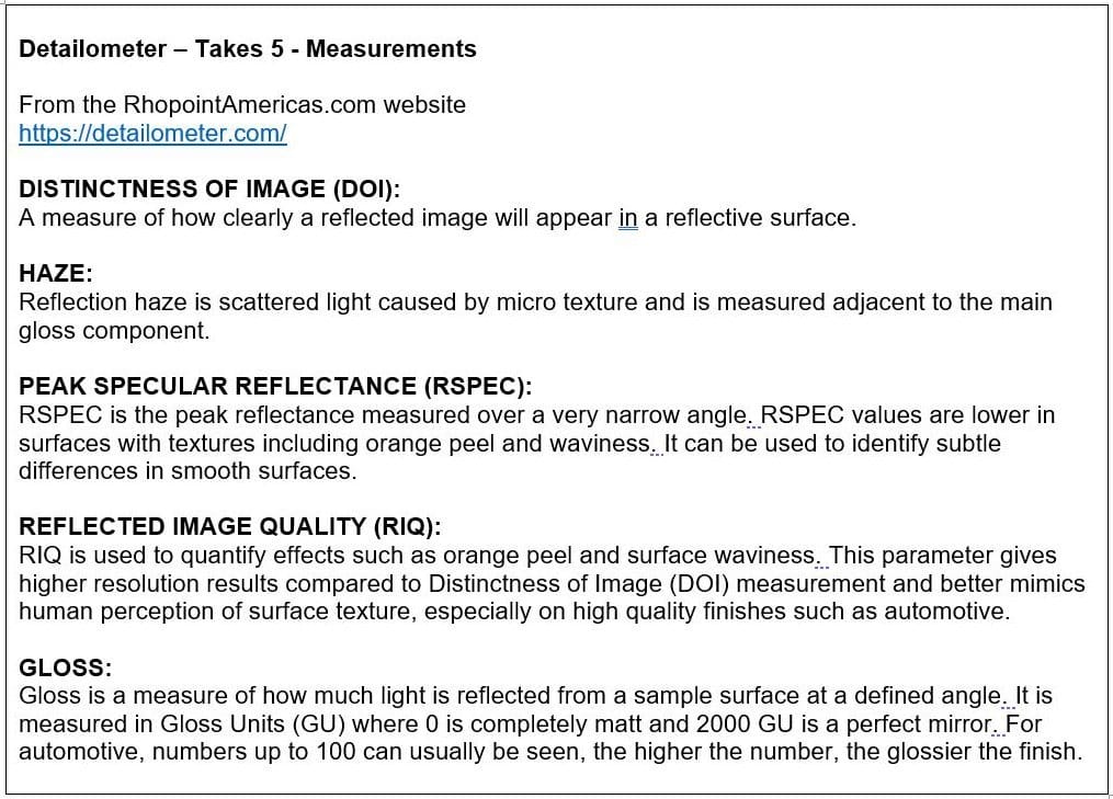

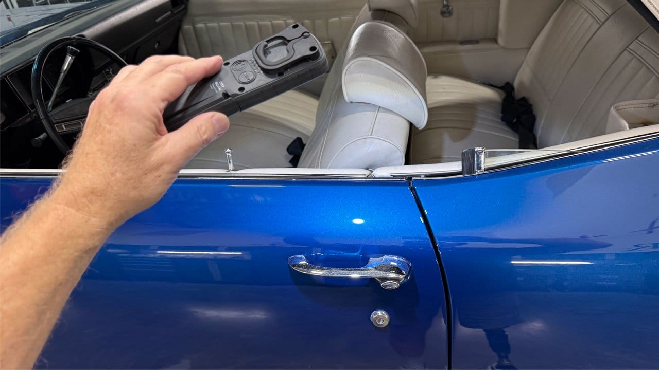

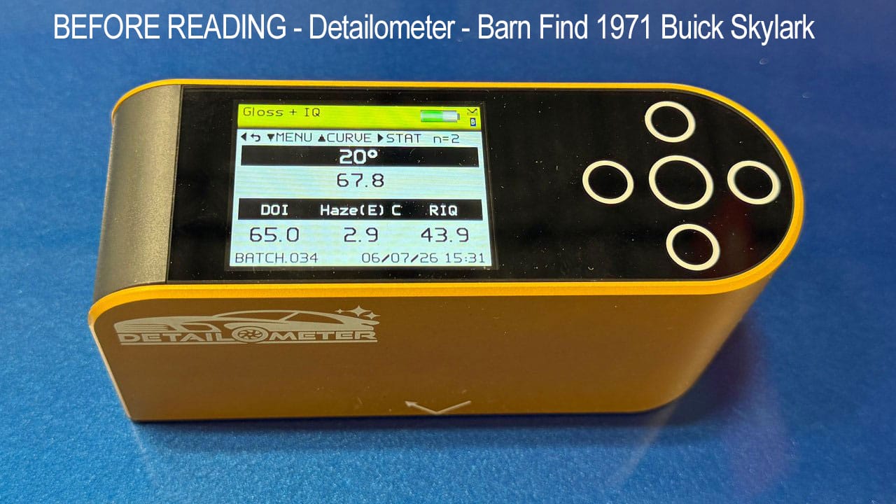

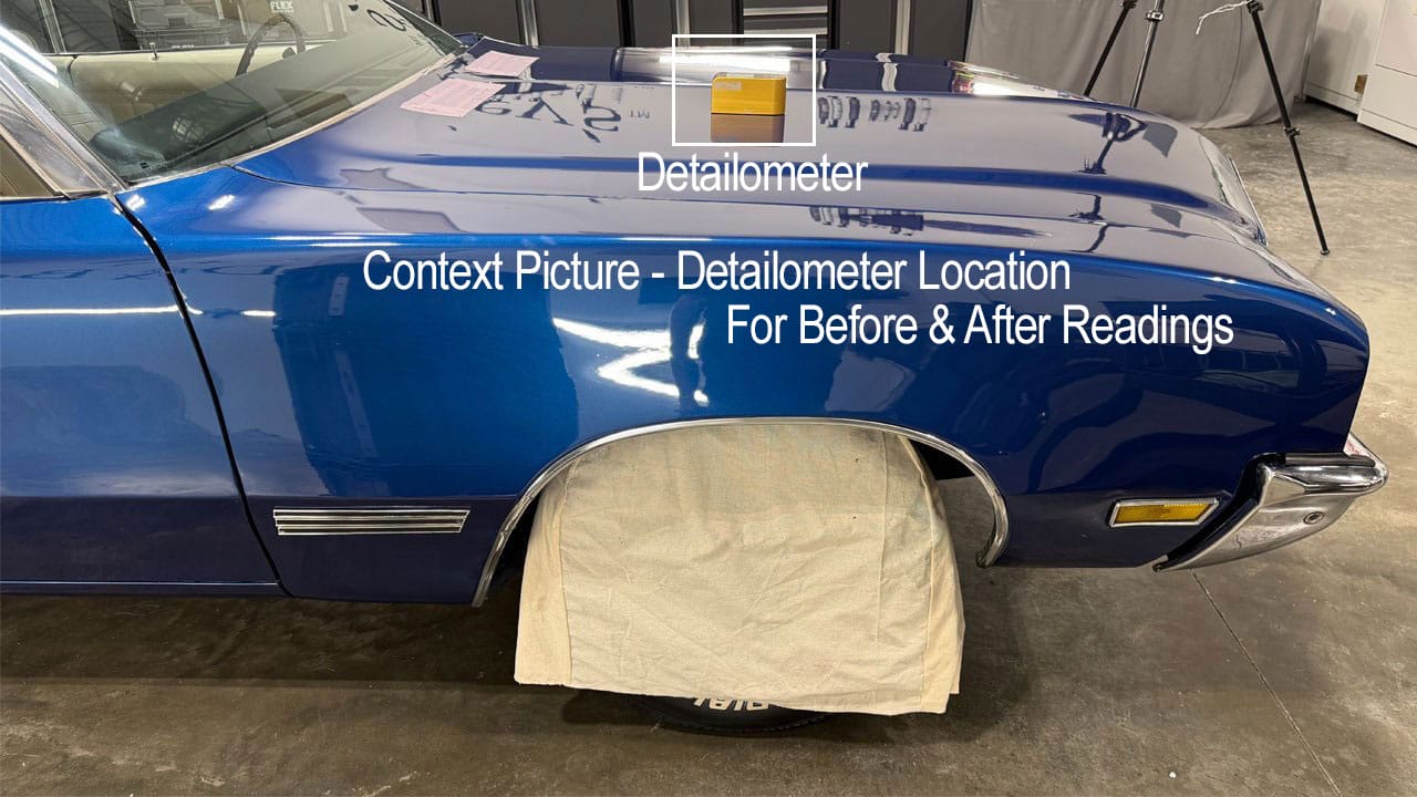

Detailometer Readings - BEFORE​
This is a very accurate surface measuring instrument that can measure and document in an objective way that doesn't replace the human eyes, but instead simply validates the human eyes.
In simple terms, you want the top number and the two numbers on the sides of the bottom row to be as close to 100 as possible and the Haze reading, in the middle of the bottom row to be as close to zero as possible.
Gloss = 67.8 - Gloss is a measure of how much light is reflected from a sample surface at a defined angle.
D.O.I. = 65.0 - D.O.I. means Distinction of Image - a Mirror is 100% D.O.I.
Haze = 2.9 - Haze is scattered light caused by micro texture
RIQ – 43.9 - Reflective Image Quality - A measurement of surface defects like, orange peel & graininess

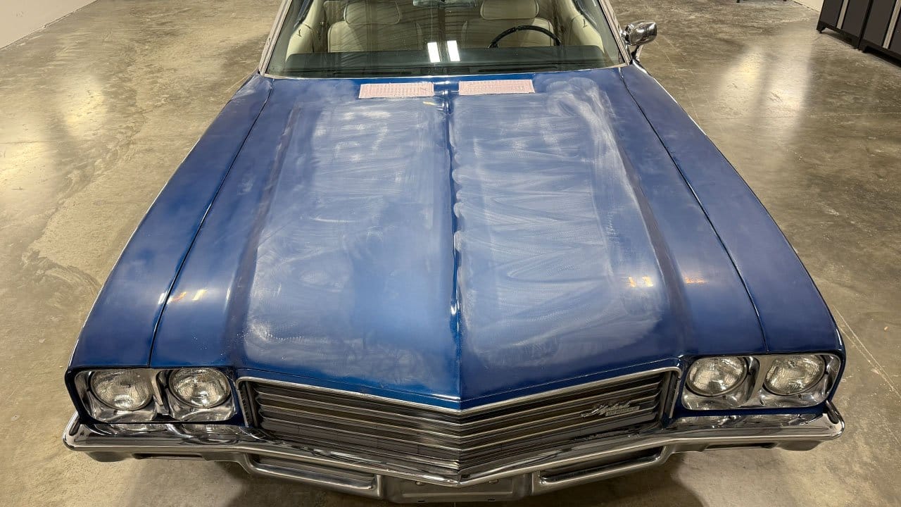

Machine Dry Sanding​
In order to improve the major gloss panels, the hood and trunk lid, I did some light machine dry sanding, which will flatten the surface which will dramatically make the gloss, shine and reflections look better. For this I used the Eagle Abrasives by KOVAX Buflex #2500 Sanding Discs. After sanding, I removed the sanding scratches using a rotary polisher with a wool pad and the NSP CoreCut. And then after removng the sanding marks, I used the DB8 to remove the holograms left by the wool pad on the rotary polisher using the DB8.

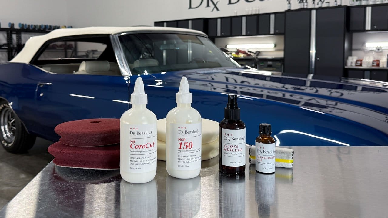

2-Step Paint Correction Process​

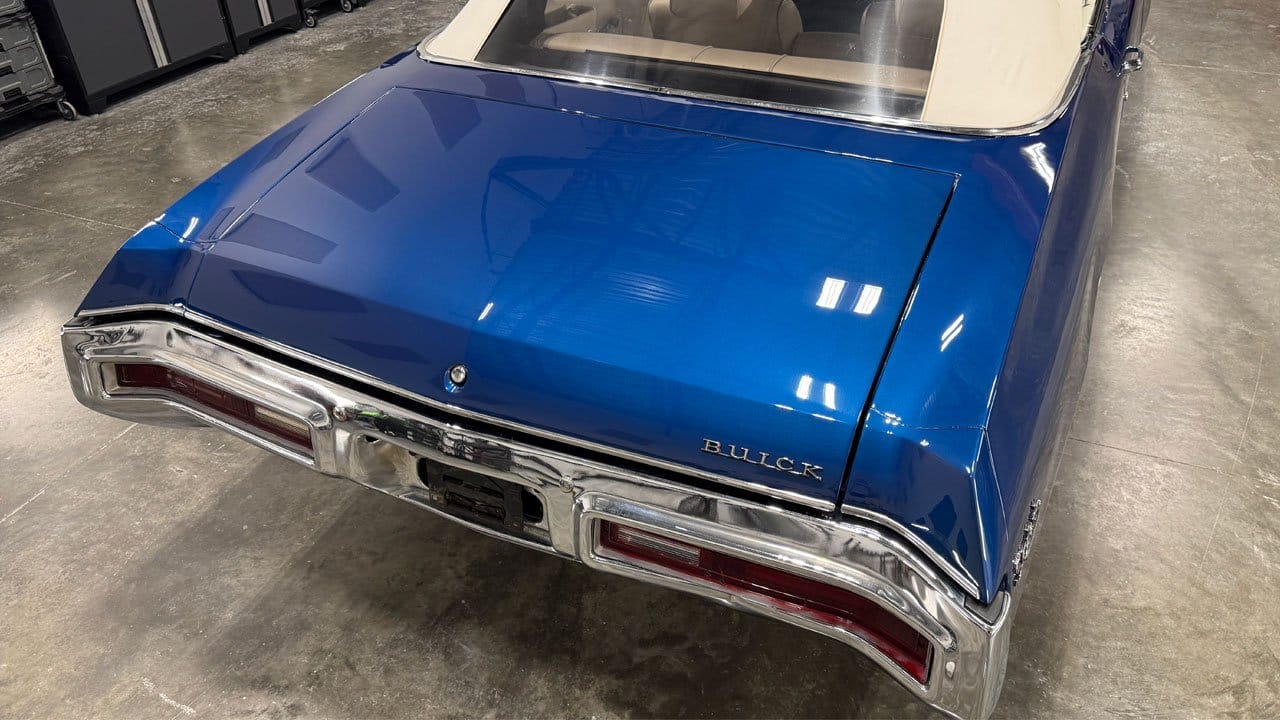

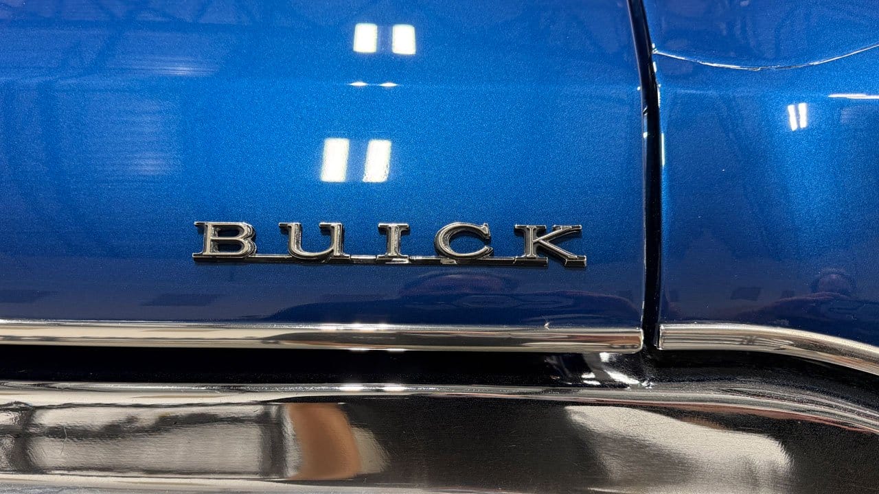

To undo years of neglect and damage, I did a 2-step paint correction process using the DB8 with a Buff and Shine Maroon Foam Cutting Pad with Dr. Beasley's NSP CoreCut and a Buff and Shine White Foam Polishing/Finishing Pad with Dr. Beasley's NSP 150. Afterwards I sealed the paint using Dr. Beasley's Nano-Resin 2.0 Ceramic Coating.

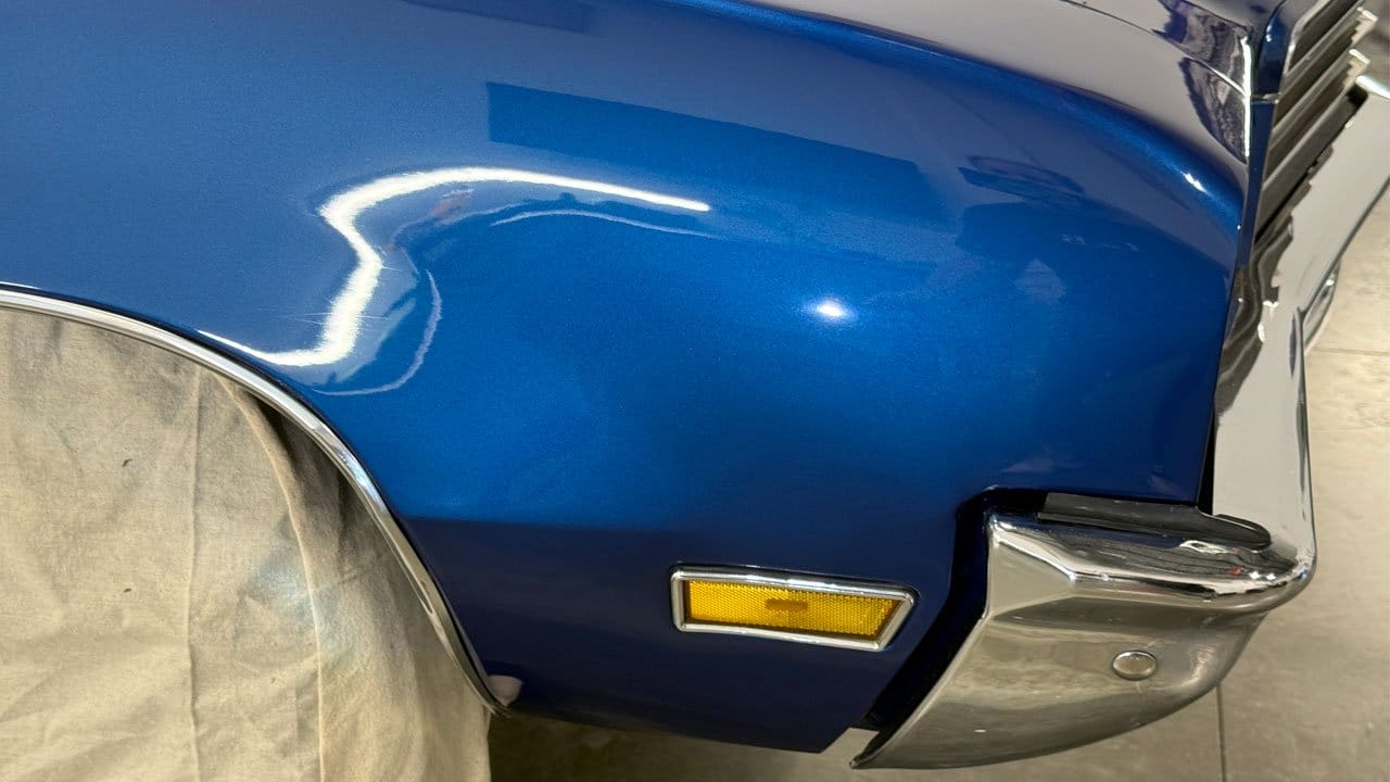

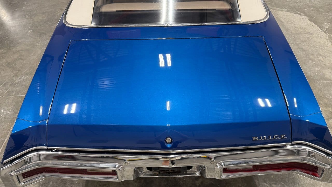

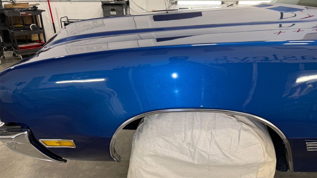

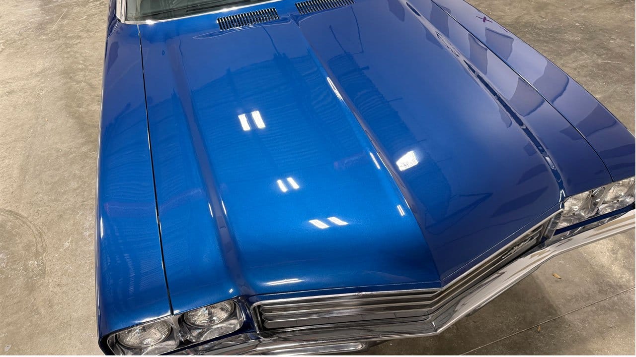

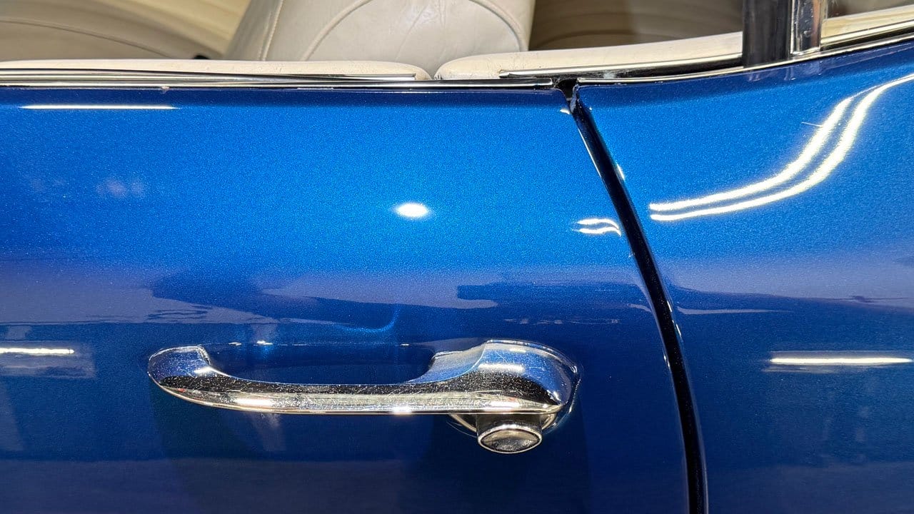

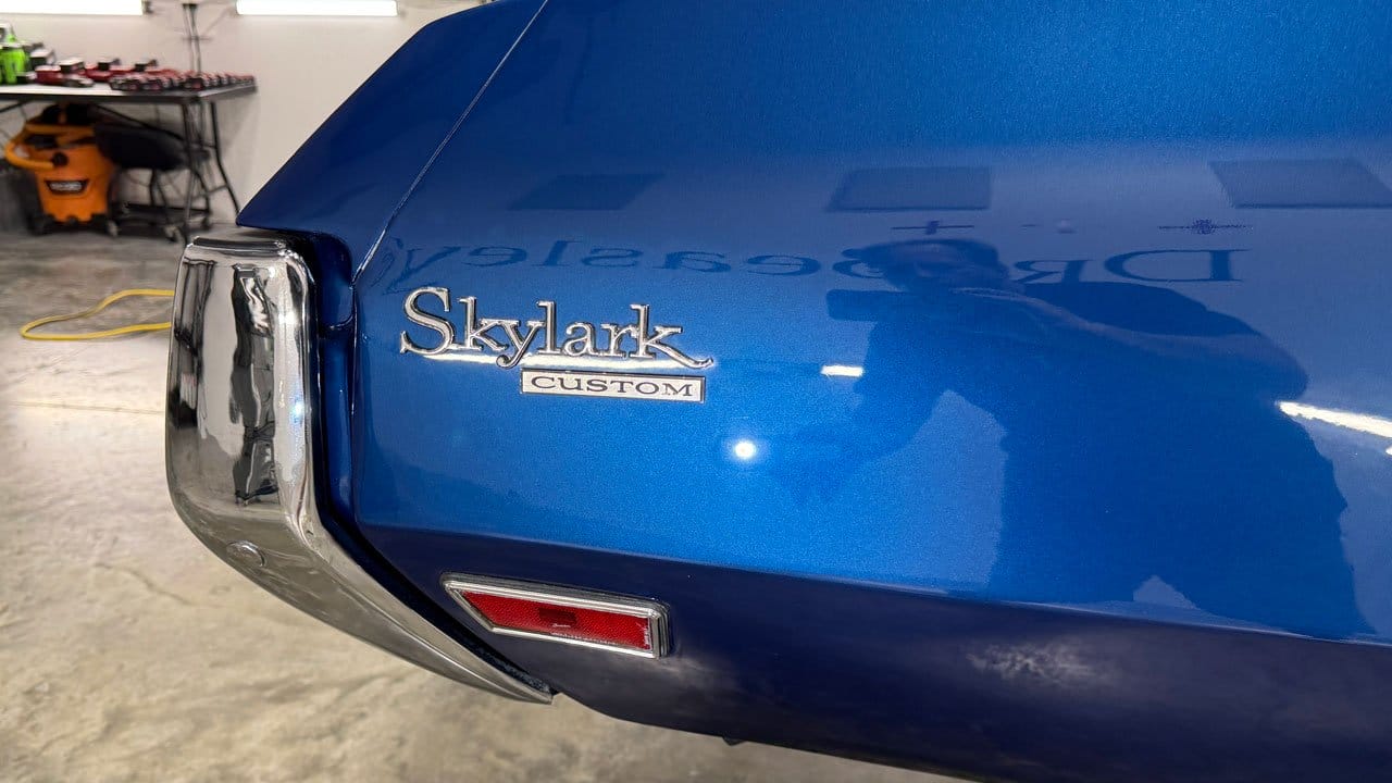

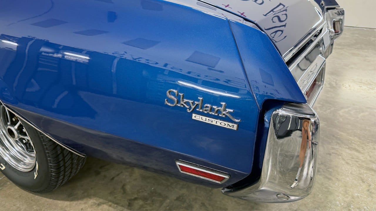

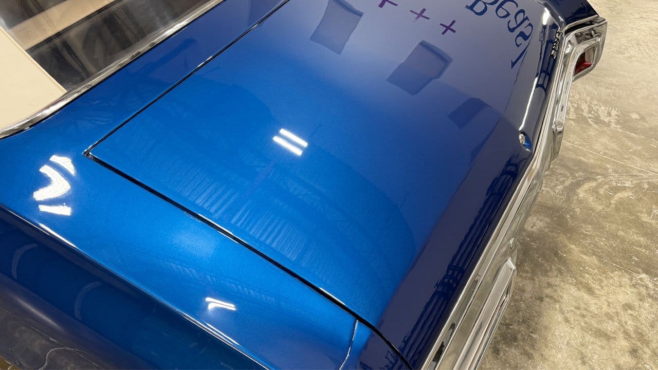

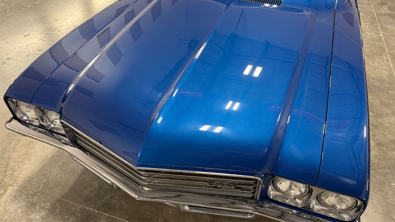

Paint Correction and Ceramic Coating Results​

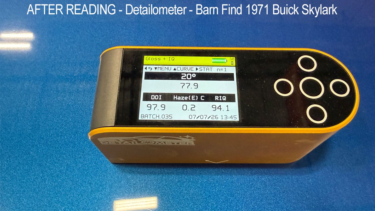

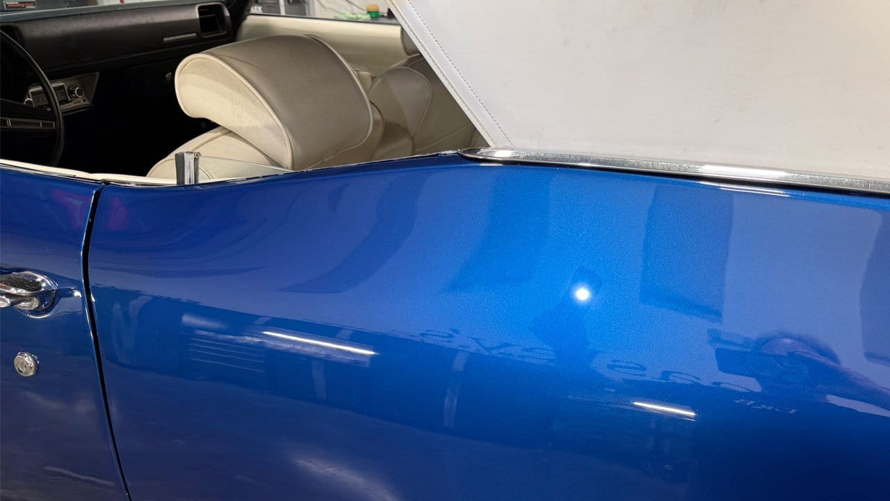

Detailometer Readings - AFTER​
As the readings from the Detailometer shows, there's a dramatic improvement in the 5 different measurements. In simple terms, you want the top number and the two numbers on the sides of the bottom row to be as close to 100 as possible and the Haze reading, in the middle of the bottom row to be as close to zero as possible.
Gloss = 77.9 - Gloss is a measure of how much light is reflected from a sample surface at a defined angle.
D.O.I. = 97.9 - D.O.I. means Distinction of Image - a Mirror is 100% D.O.I.
Haze = 0.2 - Haze is scattered light caused by micro texture
RIQ – 94.1 - Reflective Image Quality - A measurement of surface defects like, orange peel & graininess

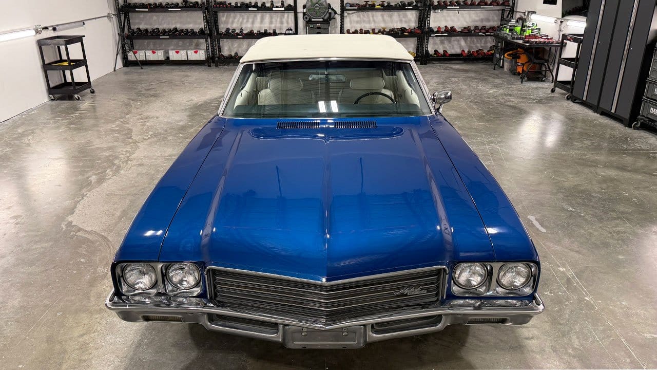

Final Results​

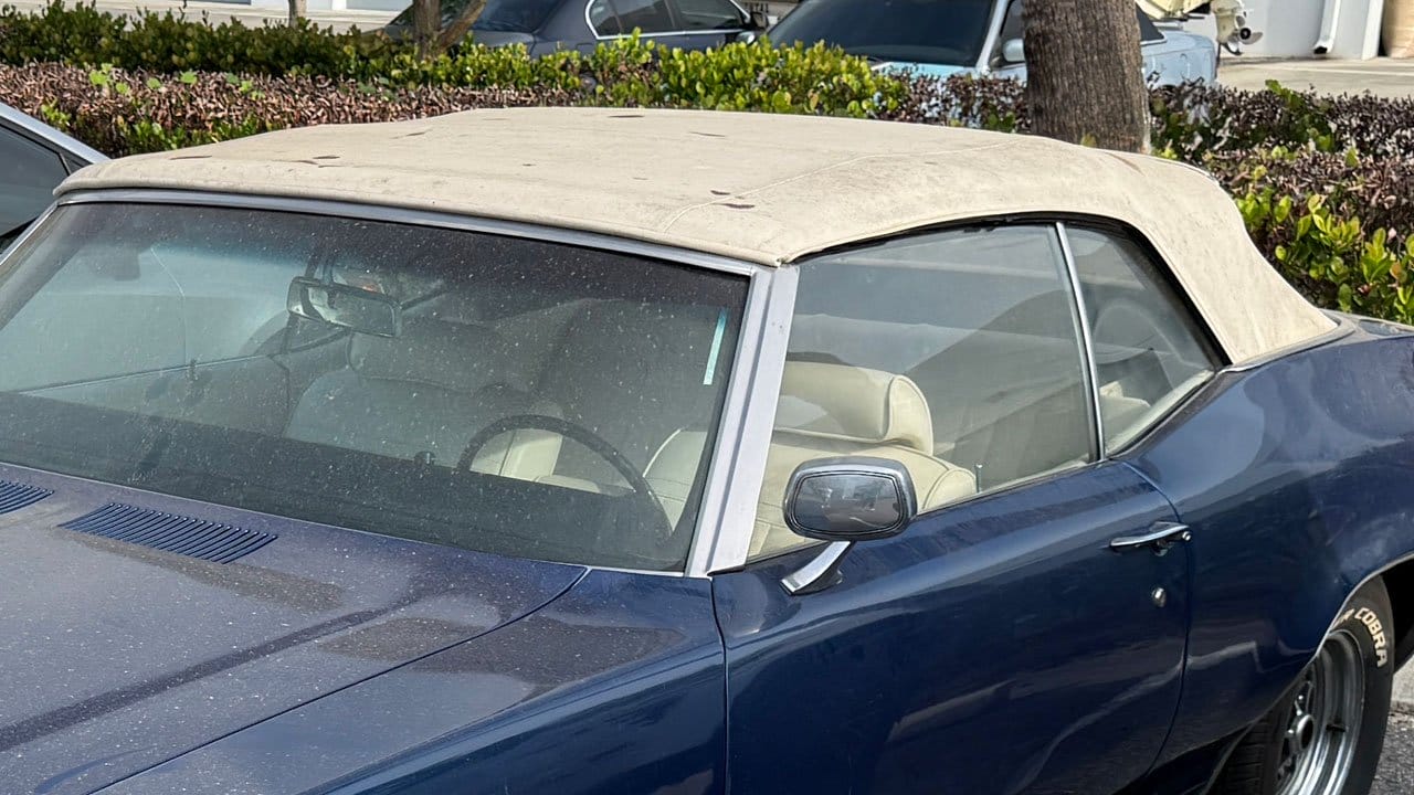

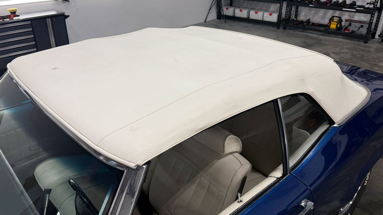

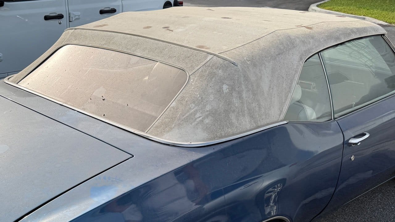

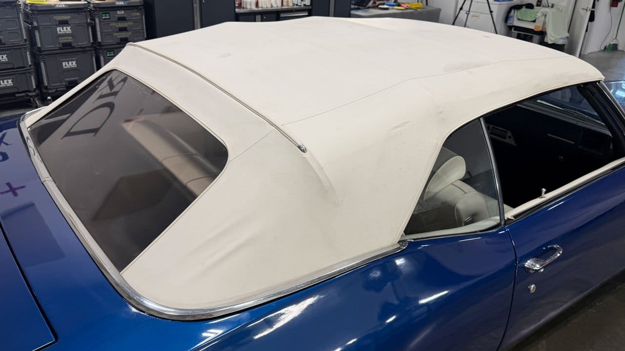

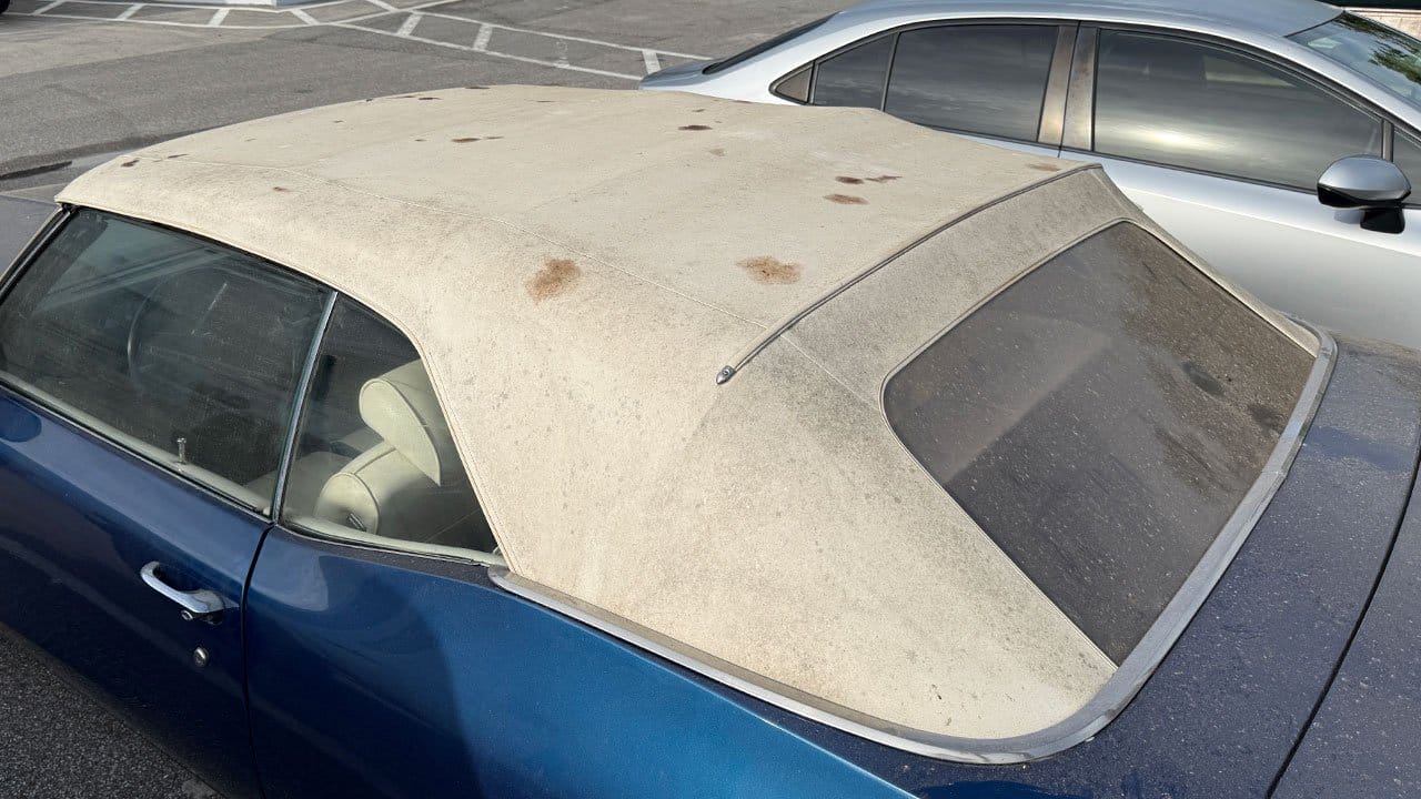

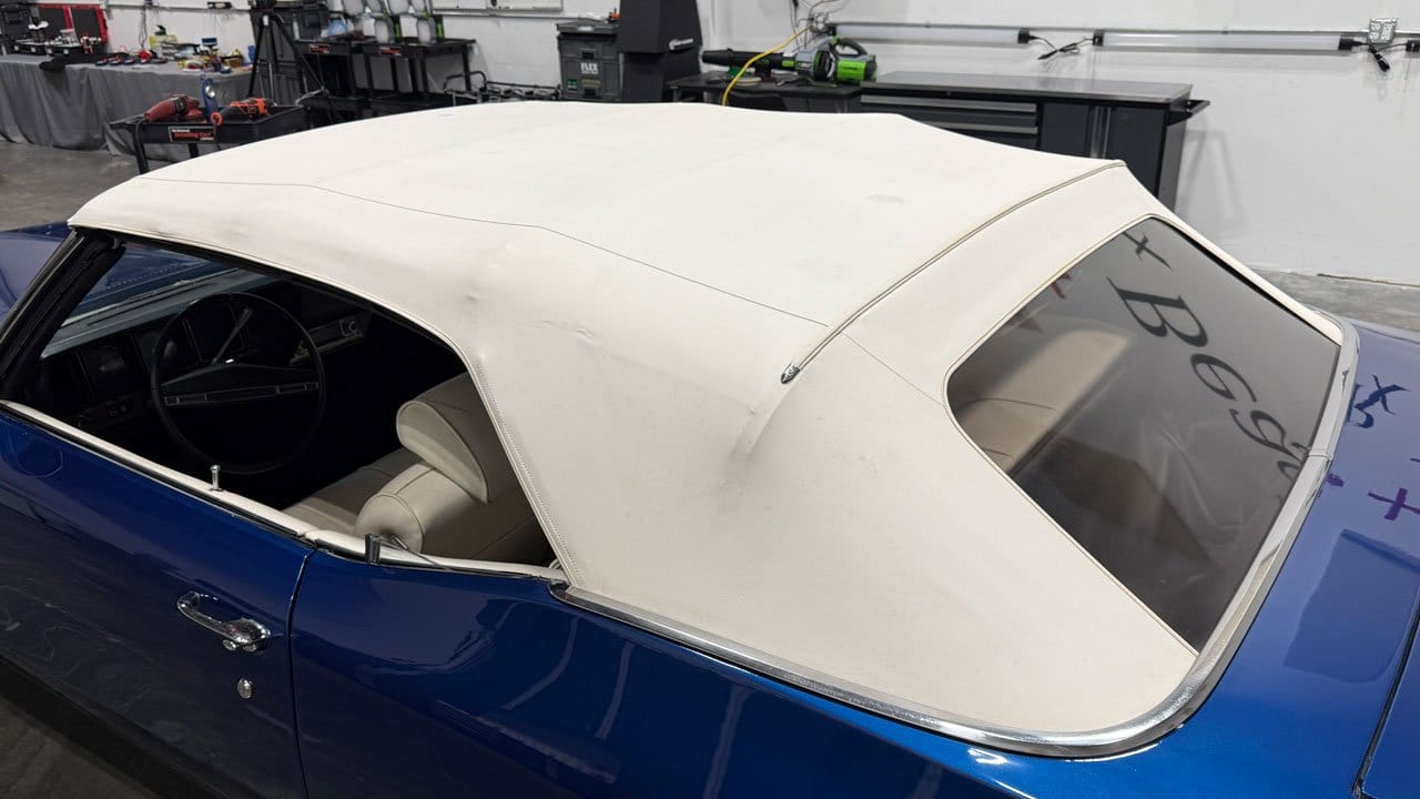

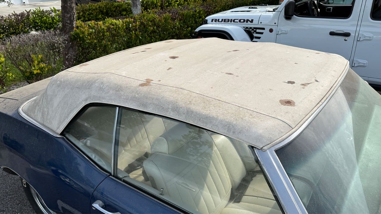

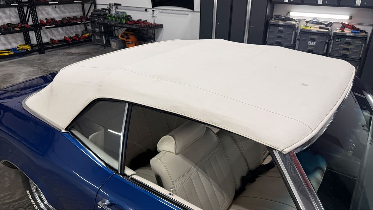

Extreme Vinyl Top Makeover​
This car sat underneath other cars on car lifts over the years and as a result, there were a lot of fluid stains like transmission fluid, power steering fluid, motor oil, etc. We couldn't fix the neglected paint and send the car back to the owner with a filthy, neglected looking top. Here's the before and after results.

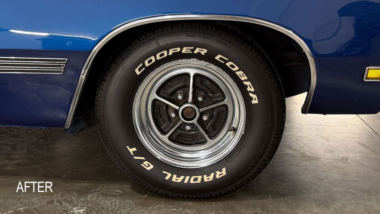

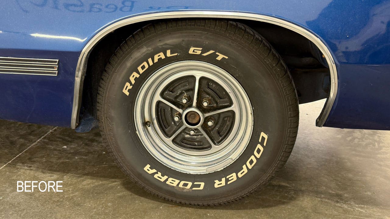

Wheel & Tire Makeover
The wheels and tires were dirty and stained. We used the Dr. Beasley's Foaming Tire Cleaner to clean the tires, Dr. Beasley's Intensive Brake Dust Remover to clean the wheels followed by applying Tire Coat Pro to the tires and Bead Hero to the wheels.

Products & Pads Used​
For those wondering what I used to test out the DB8 and undo years of damage and neglect, here's what I used.
Dr. Beasley's CoreCut (compound), with the Buff and Shine Maroon Foam Cutting Pad
Dr. Beasley's NSP 150 (polish), with a Buff and Shine White Foam Polishing/Finishing Pad
