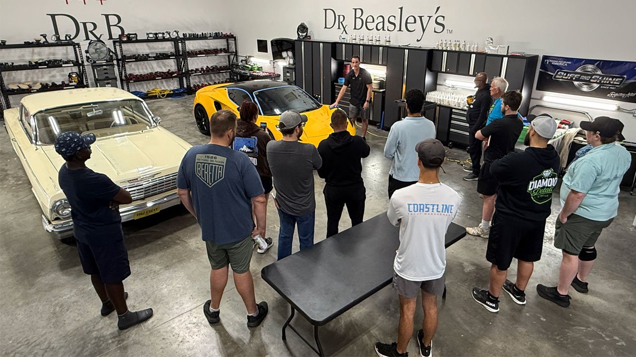

Next up, we go over the tools and techniques to do a 2-step paint correction and ceramic coating. Here's the PowerPoint side for this 2nd topic on the first day.

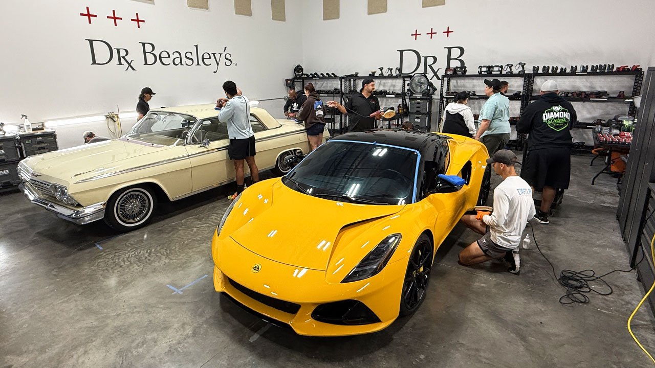

While one half of the class is doing the SAME 2-step process to the Chevelle, the other half of the class is doing this 2-step process to this Camaro. Not a lot of acton pictures for this car, but the results speak for themselves.

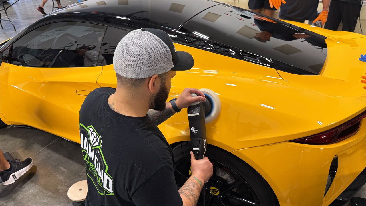

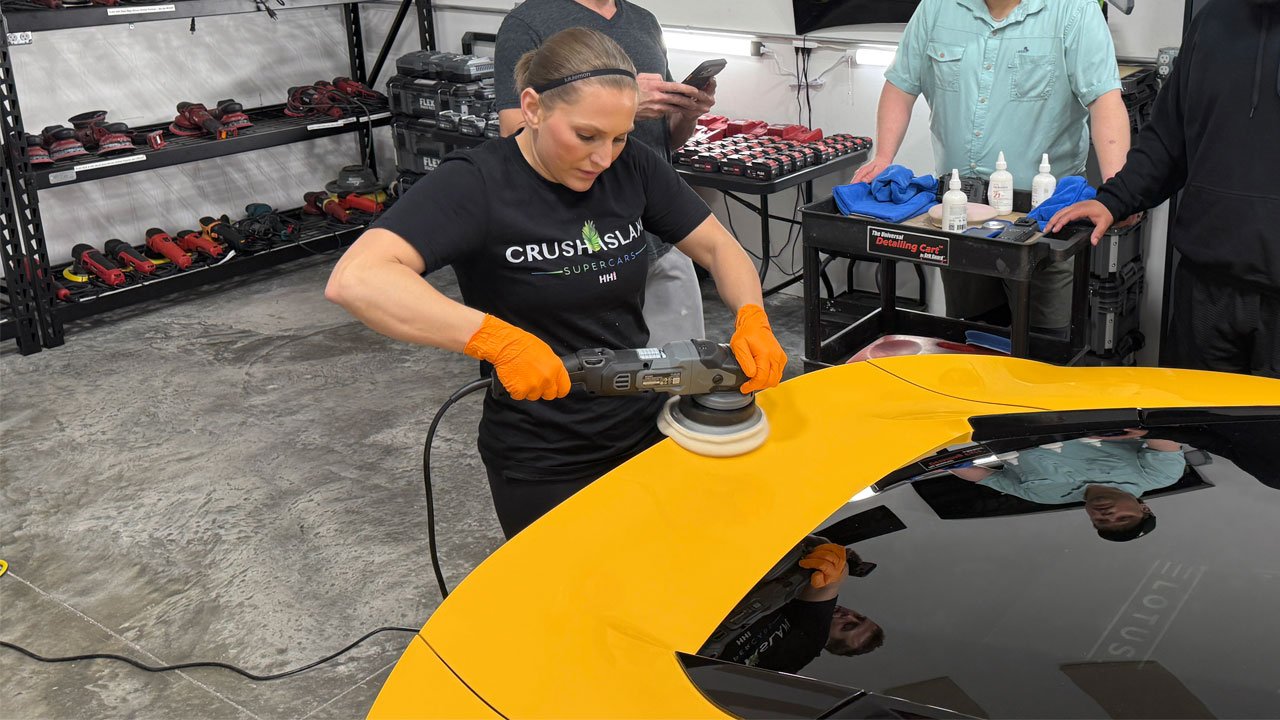

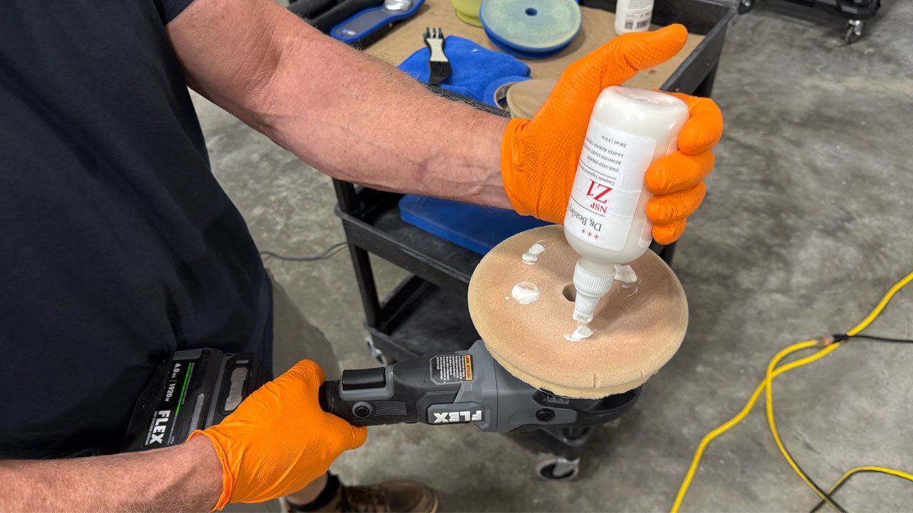

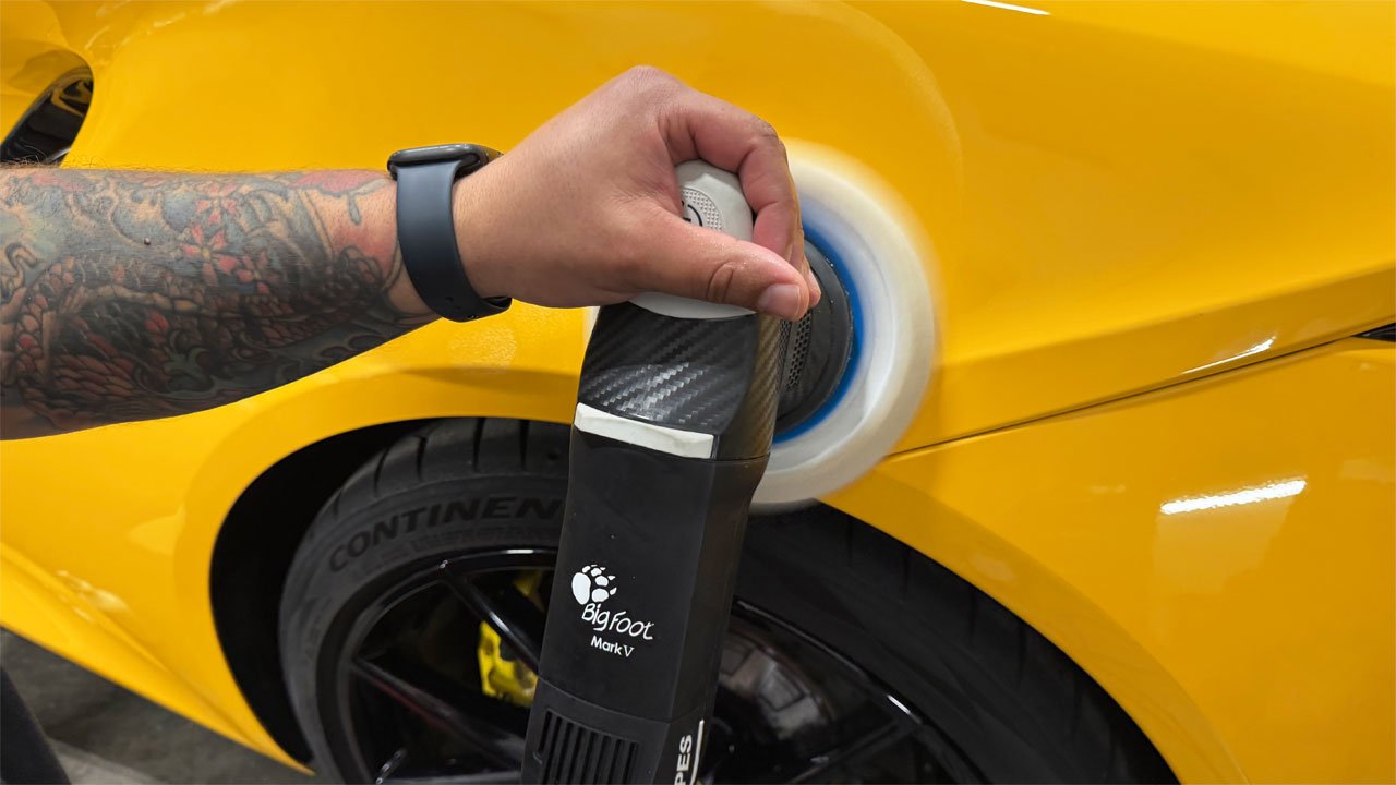

Step 2: After using the NSP 150 with white foam polishing pads on gear-driven orbital to remove the swirls and scratches, next up the class switches over to NSP 95 with the Buff and Shine black foam finishing pads.

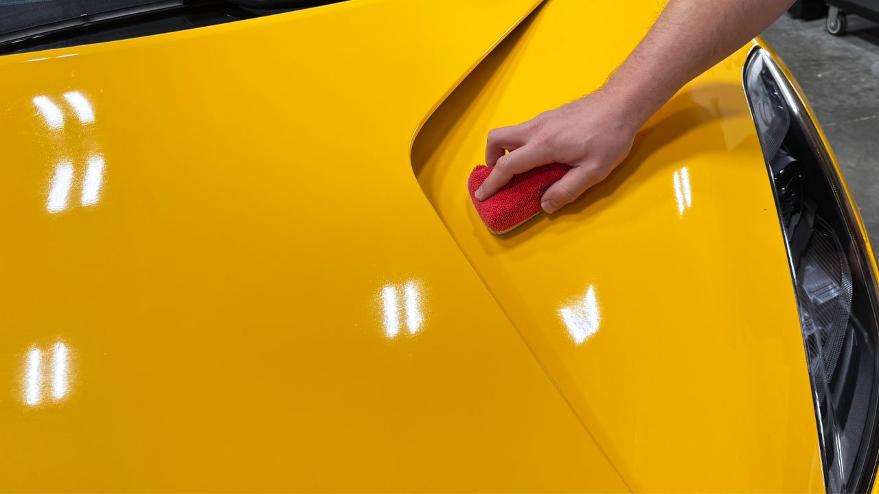

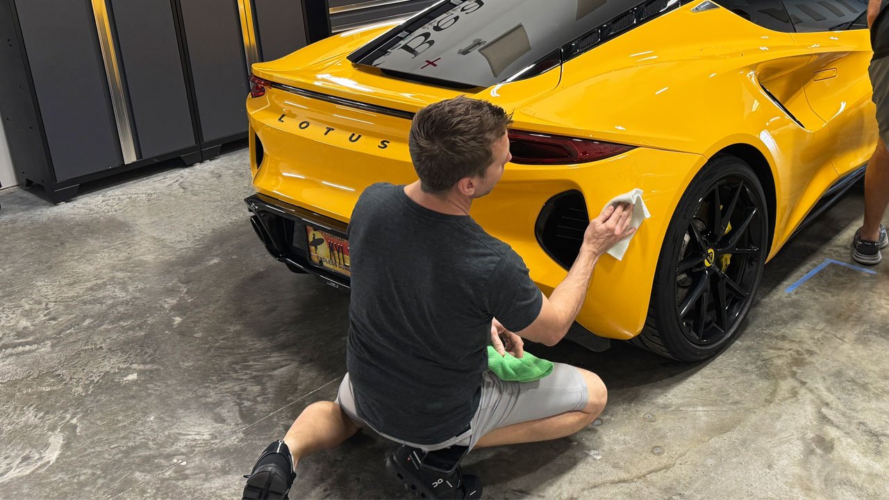

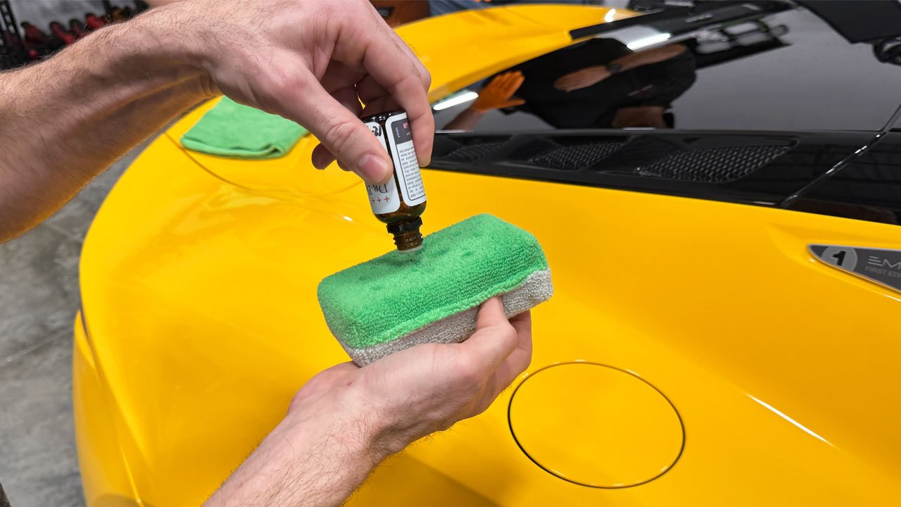

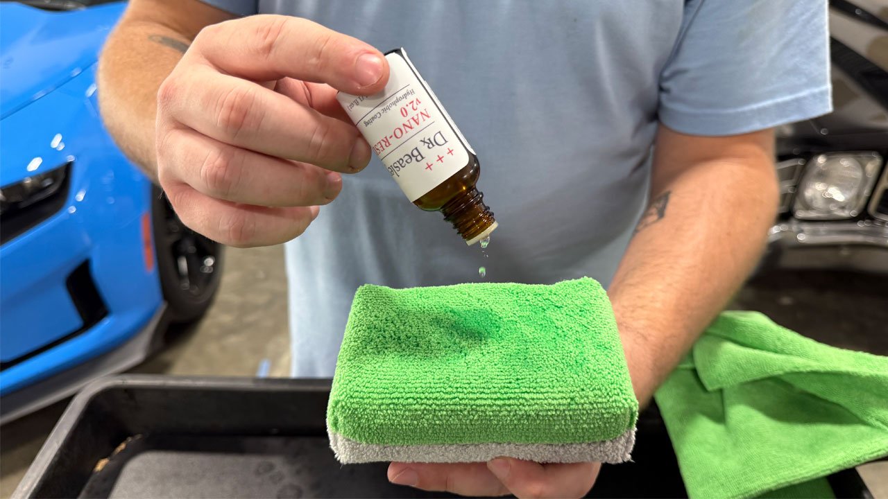

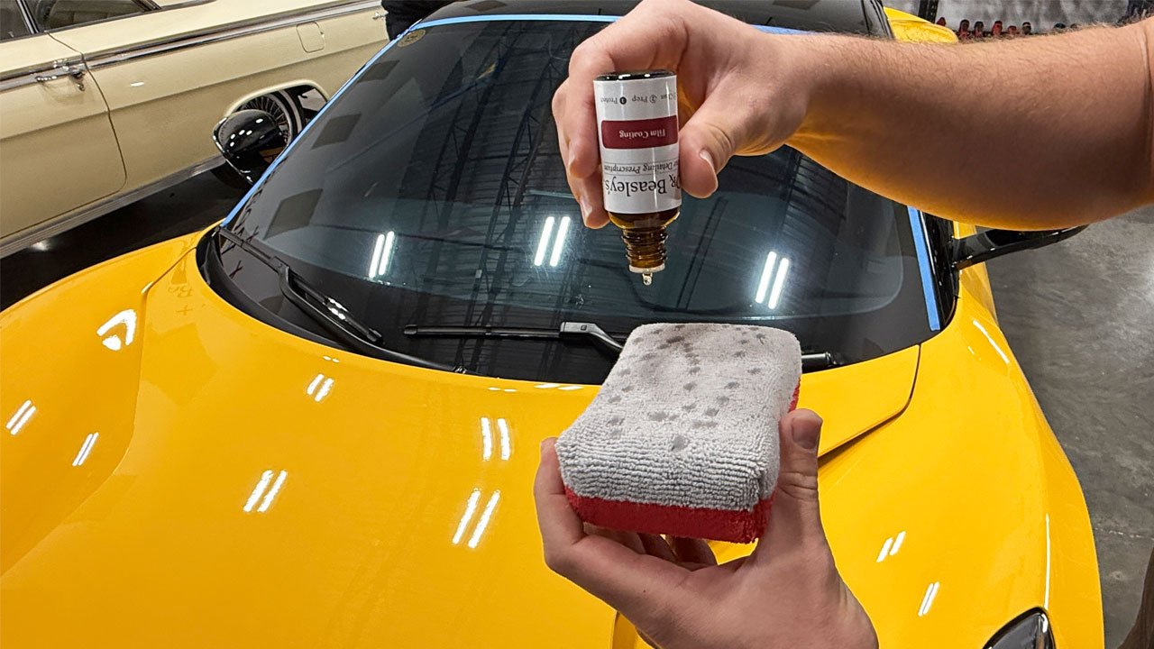

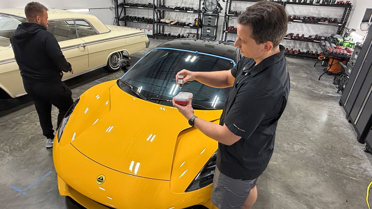

Step 3: Install the Ceramic Coating

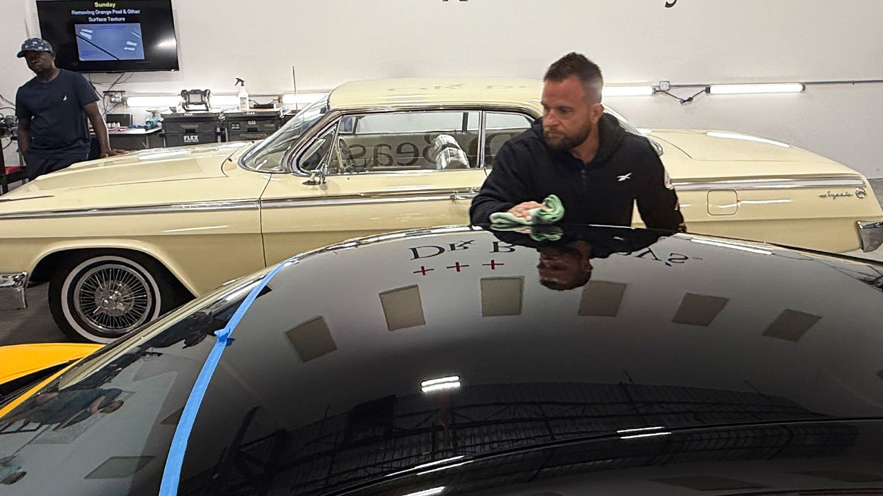

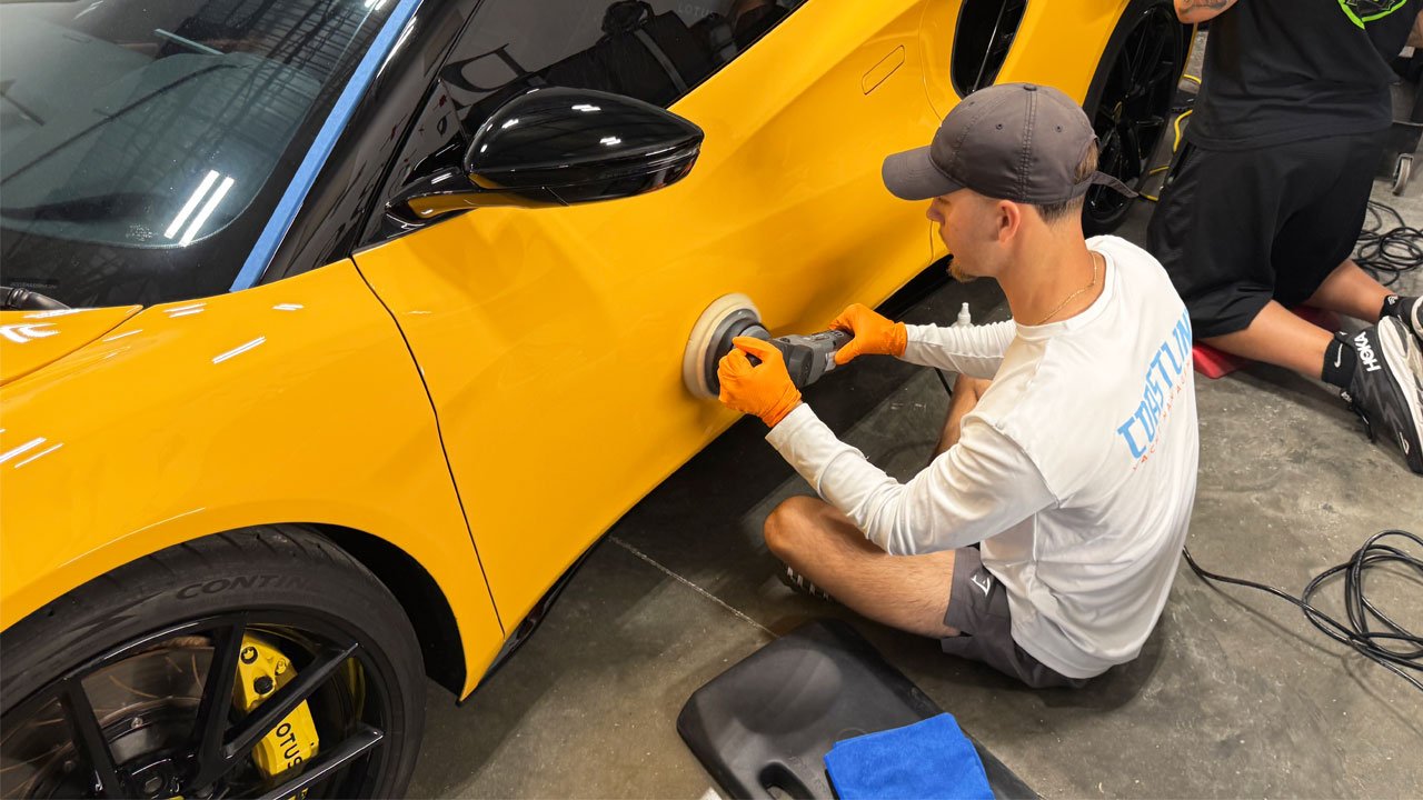

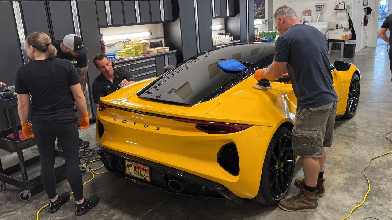

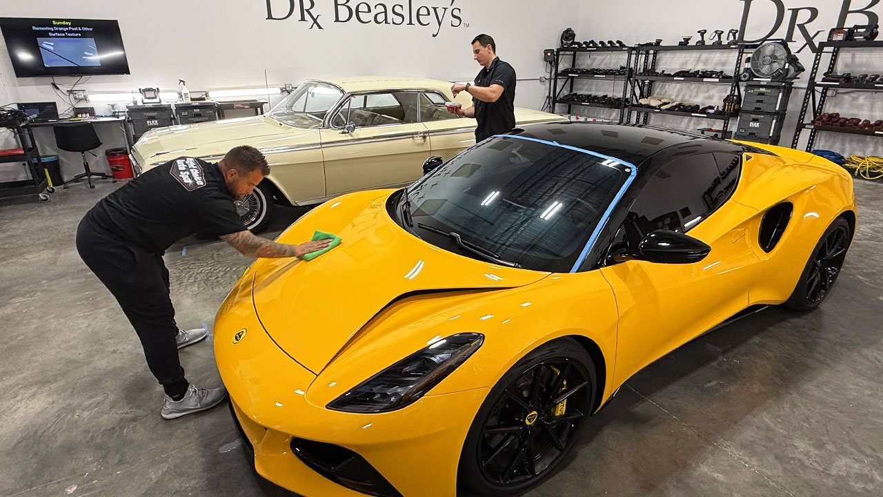

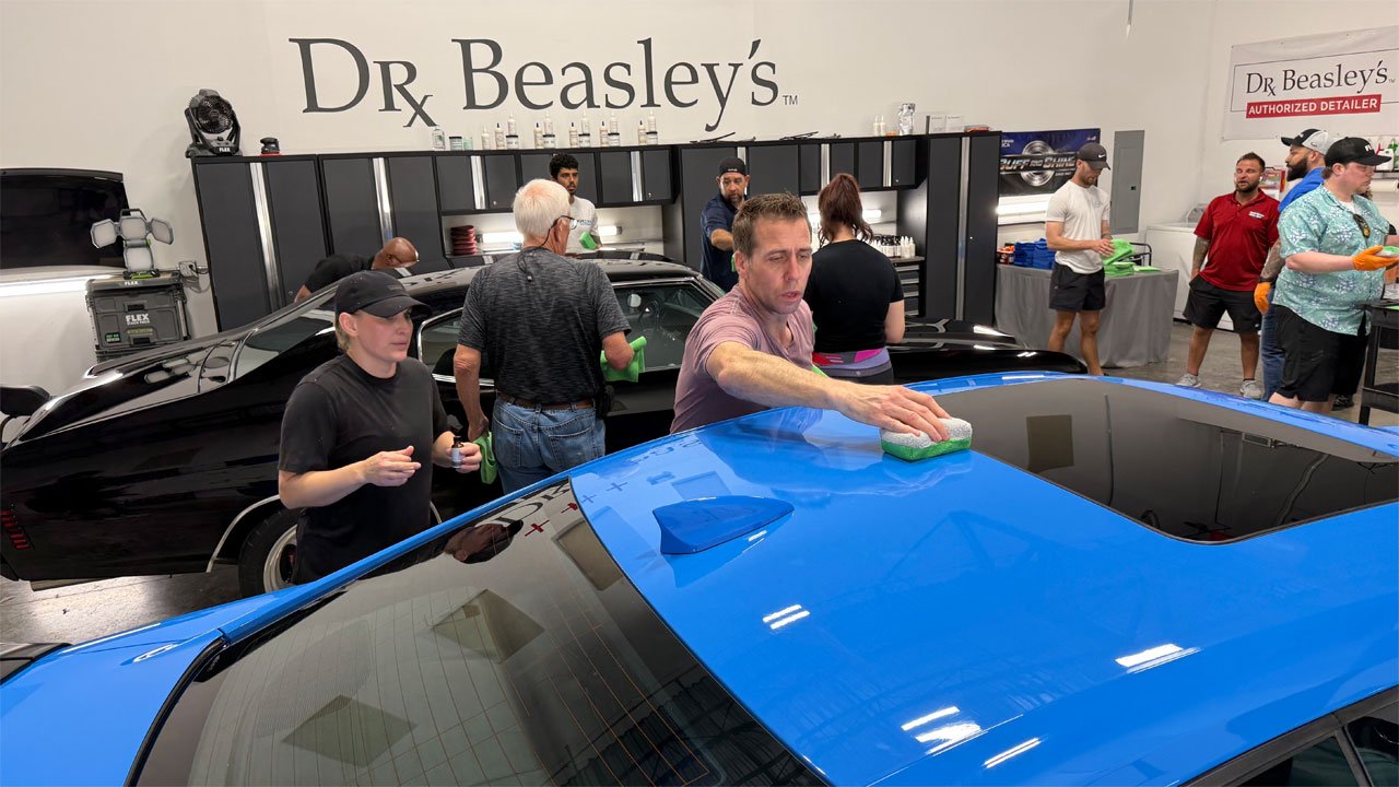

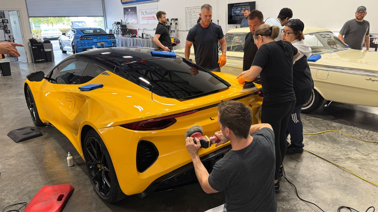

Here's Josh tackling the roof
Here's Julia following Josh and getting the verticle panels.

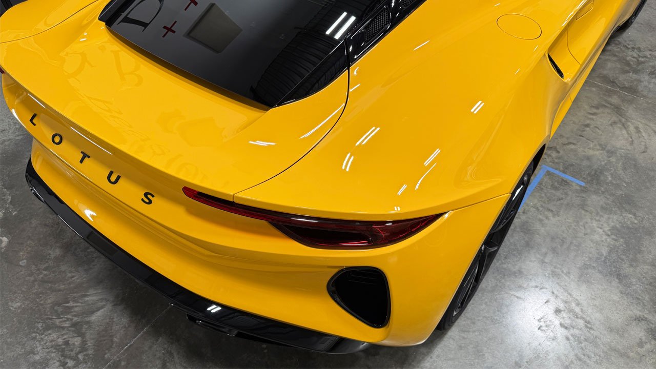

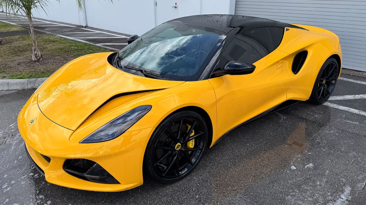

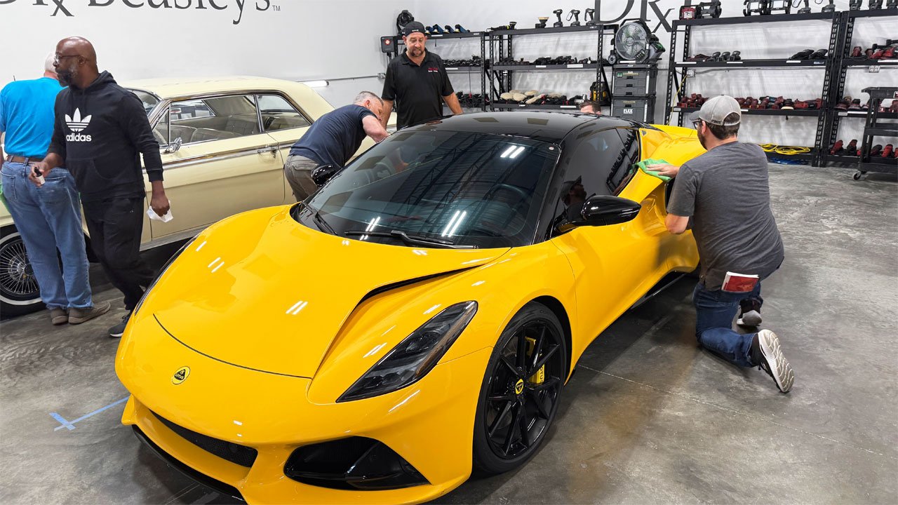

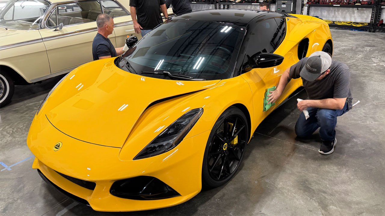

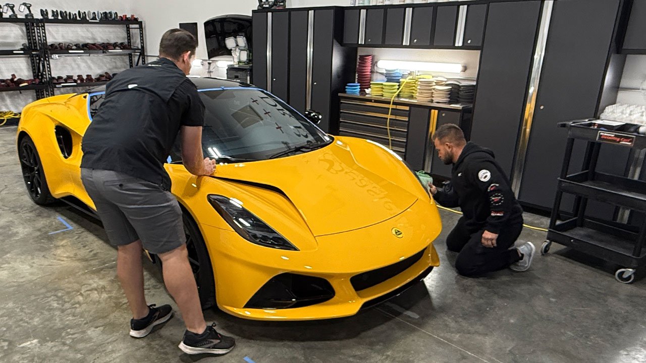

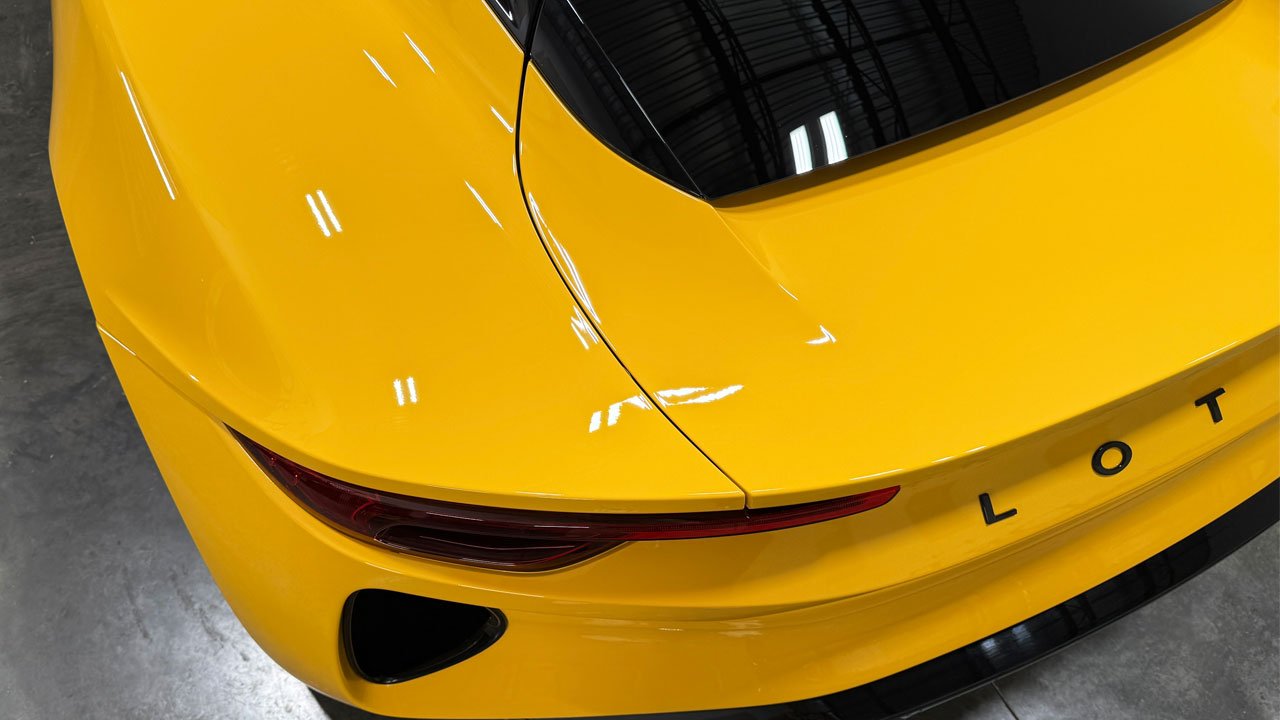

Here's the final results!
Both cars came out freaking amazing!
And here's the team that made the magic happen!
